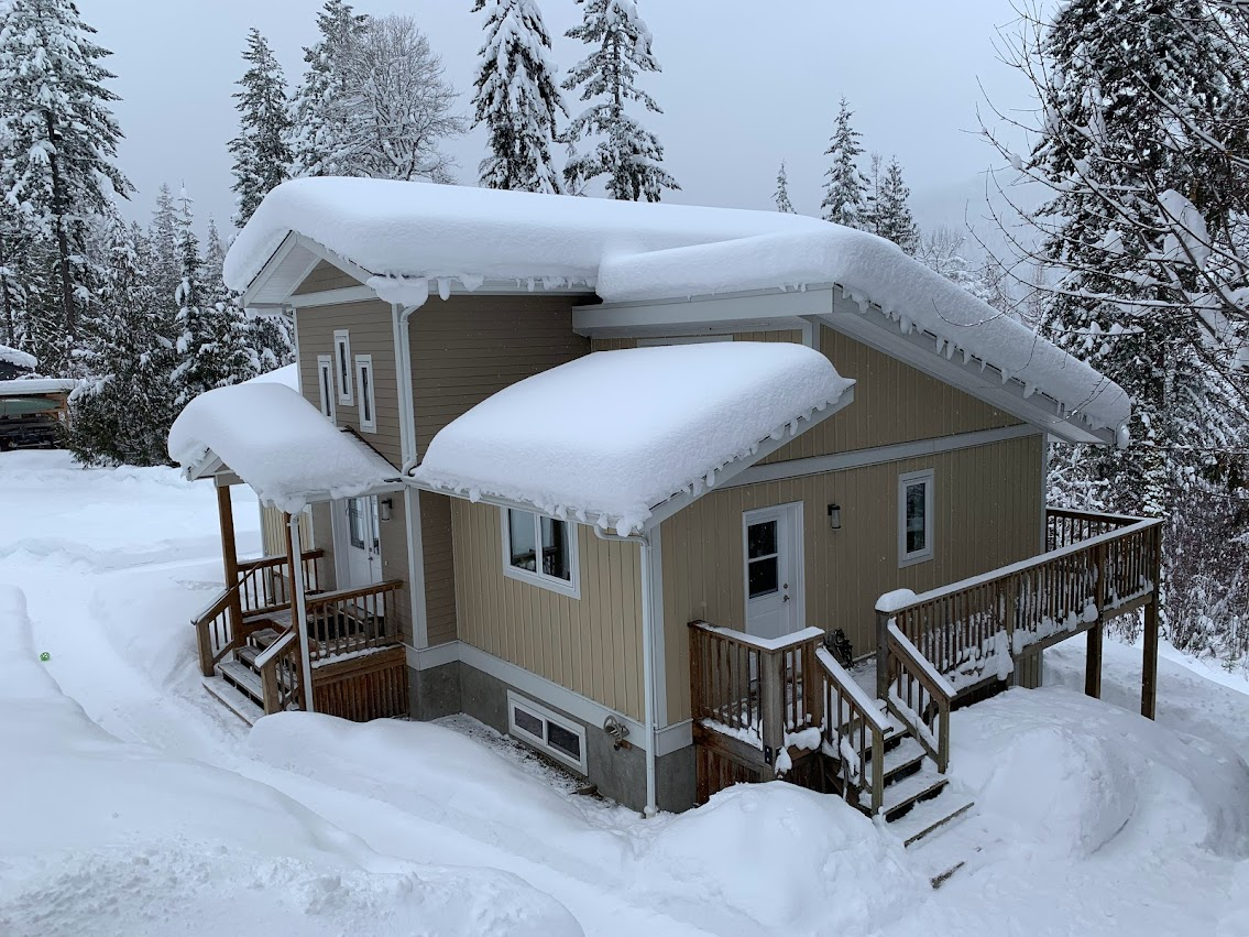

When I 'apprenticed' with my architect/mentor for 5 years, we discussed a lot of aspects of home/building design. After that, I could not look at standard or trendy home design the same way. From the trendy dormer-deluge to the hard to insulate, hard to maintain and more expensive than necessary, I was going to have to have a custom home, designed from scratch and based on our lifestyle, the property and setting and a firm nod to eventual resale, because life happens...
Anyway, it's a non-trivial project. With my experience in carpentry, tile, paint, plumbing, electrical, etc and the years learning design and drafting, and a consulting electrician, plumber, and excavator/septic guy, and only 2 subs (spray foam and drywall) it took me some 3 years end-to-end. Sure it was rewarding to simply do it, but there was also a cost incentive. Saving a full quarter-million dollars over a contractor-built home was nothing to sneeze at.
I was just out taking a few pics to document the couple of feet of snow we've gotten here in the past week.
