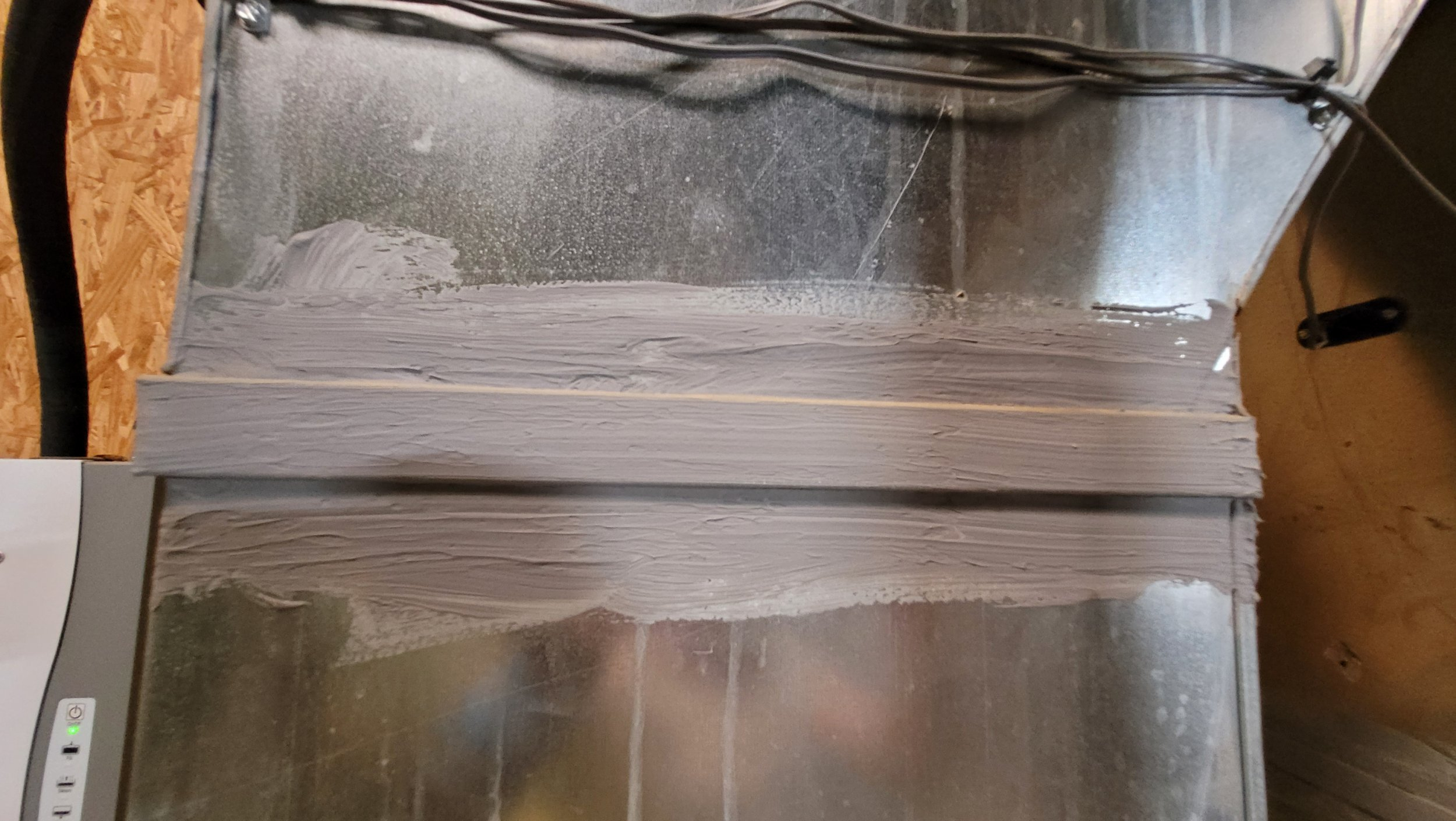

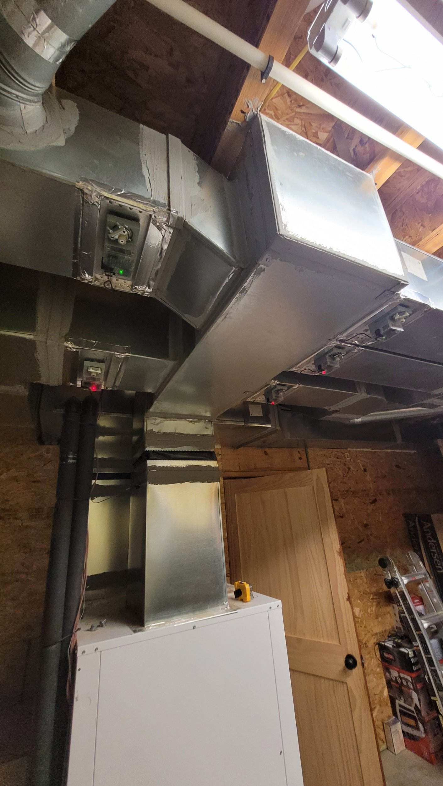

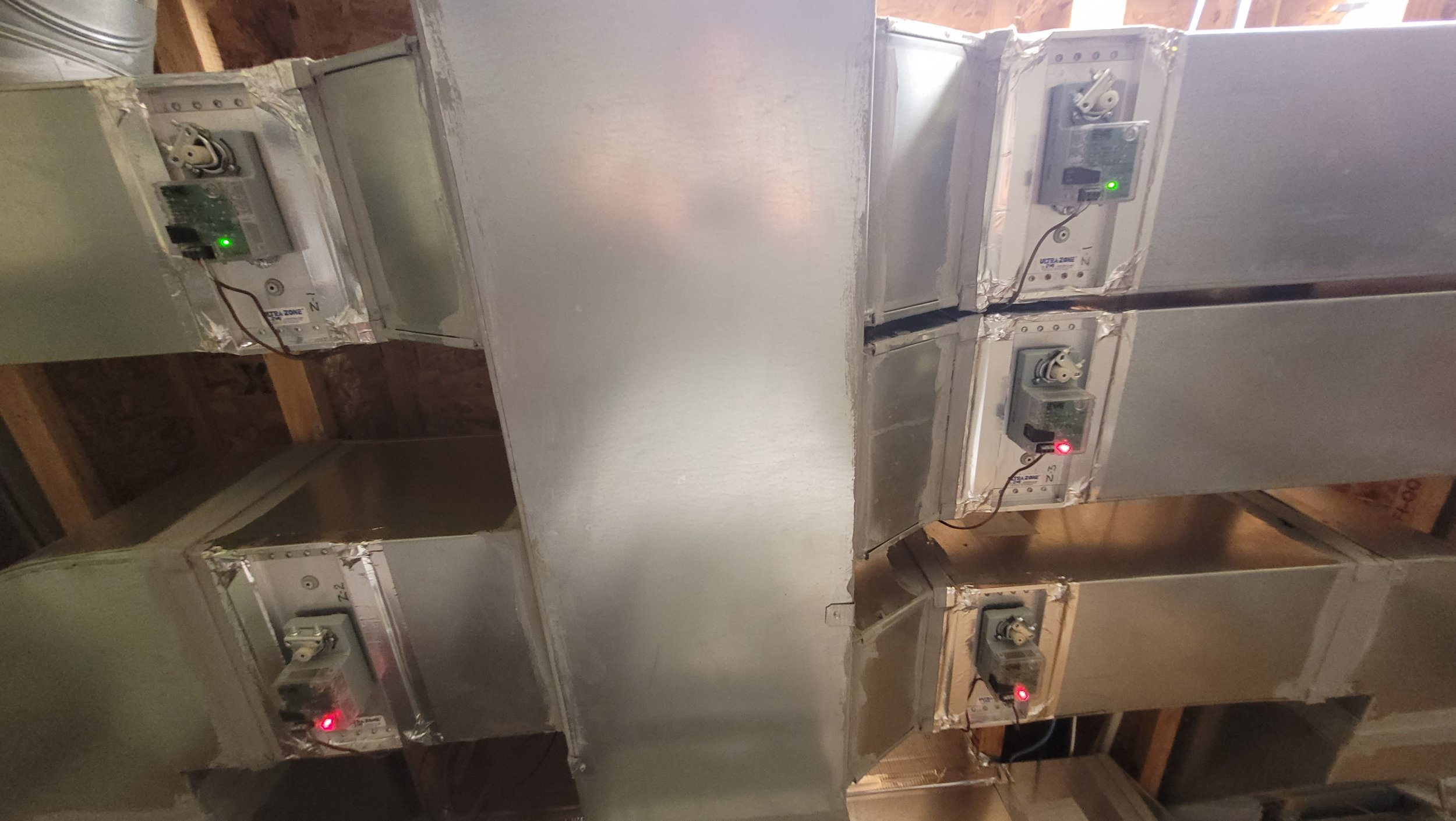

Here's a few pics coming off one of our two hvac systems in the home. Red and green lights are the zoning dampers. All custom hard pan and even the short runs off trunks are hard round metal including those in our basement into our drop ceiling. Not a single piece of flex and proper sealing at all seams.

Here's a few pics coming off one of our two hvac systems in the home. Red and green lights are the zoning dampers. All custom hard pan and even the short runs off trunks are hard round metal including those in our basement into our drop ceiling. Not a single piece of flex and proper sealing at all seams. View attachment 727059View attachment 727060View attachment 727061
That's what I have in my home for each of the 3 units. And ducted returns from each room.
   / Do I need a general contractor to build a house? #105
Same here, and just like jk's pics. If they are properly sealed they won't leak. And yes, ducted returns from almost every room (not bathrooms)
But another one of those regional differences: all my ductwork is within conditioned space. If there IS a leak, it doesn't mean it is heating the atmosphere, but rather just causing a bit of imbalance in the amount of air that should have made it to the end of the run. It is still conditioning the house, just not quite as efficiently as it should. This is typical around here.
