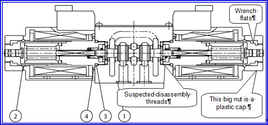

I think AK figured it out...sounds like the dealer used the wrong valve as well for you application-it should just be OPEN or CLOSED.
After taking the coils off (the big nuts) the spool should slide out easily, you will want to clean inside the subplate also. Look for any pinched/nicked O-Rings as well between the valve body and the subplate.

I got the four-sheet product description for the SK-G01 from Nachi's web site, and it has a cross section of the valve. From that, it looks like the the "big nut" on the ends will allow the solenoid actuator to come out, leaving the coil and its two O-rings untouched, and the spool will come out through the coil housing. Does that sound right?
Another question: The Dimensional Drawings show a "Manual Push Pin". Should it be possible to operate the valve, at pressure, by pressing those pins?

My initial idea was that you had got a valve with a motor spool...A and B open to tank in neutral....then I found the Nachi website and the codes for valves...
The code for your valve do not show the "N" for push pin...Push pins are very common, and just use a soft material pin/stick to push with....there is an o-ring on the push pin, that create some friction.....you'll need some 5-10lbs of force...full push stroke should be just little more than 1/4" or so....be careful, if it's a piece of metal, you can damage the spool and the housing....
Try push pin before taking valve apart....

I did try the push pin and found no change. With no engine off, one side pushes approximately 1/4" and the other approximately 1/8", confirming that there is something blocking the spool I think. The pins pop out with engine on, and neither can be pushed in against the pressure.
That confirms the valve is stuck in transient position, oil pressure will hit both ends of spool and push pins out....

Take the plastic cap off....slide coil off....use wrench on the hex at end of solenoid housing (your "wrench flats")...should be enough to open on one side and pull the spool out....remember what ends comes out first....spool might be non symmetric....
