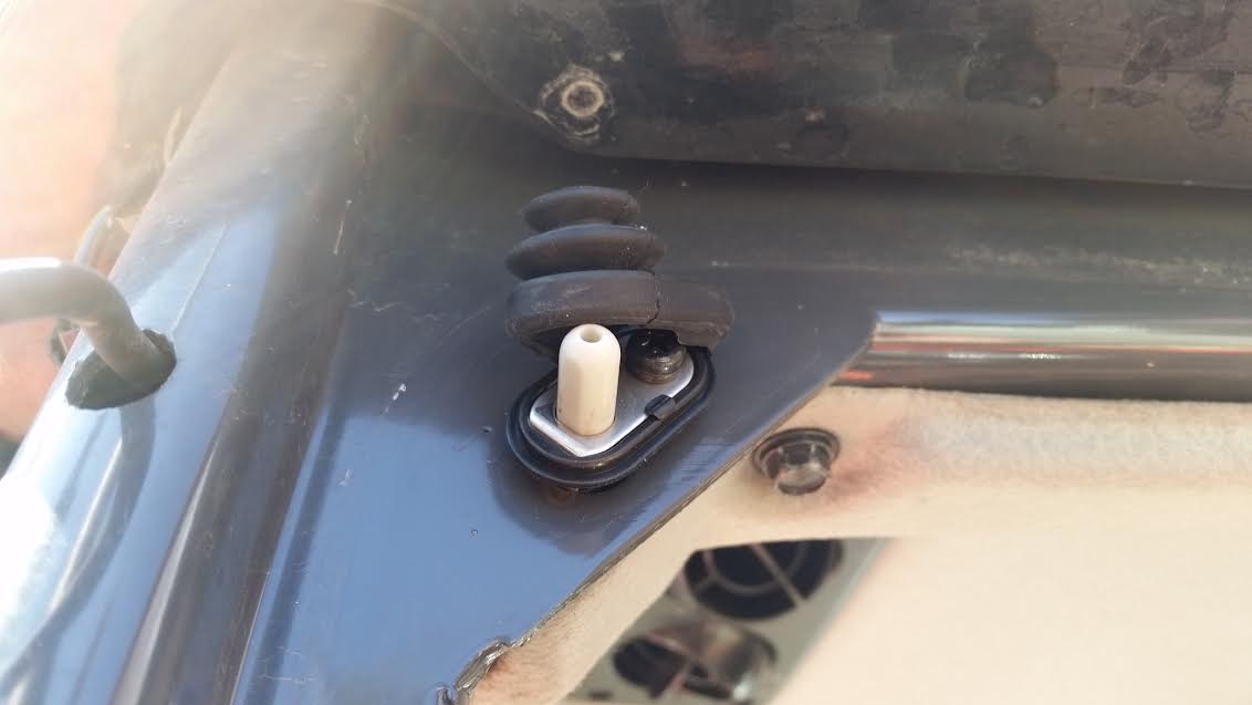

Apr 10, 2017 / Do GL60 cabs have a door switch? #1 FatTire Veteran Member Joined Oct 2, 2007 Messages 1,371 Location Colorado Tractor Kubota L5740, Unimog 404 w/ snowblower, Deere 620i UTV, MX5100 (sold) Trying to help a guy determine if GL60 cabs normally have a door switch for the dome light? On GL40 cabs there is a switch in the upper corner. When door is closed the glass contacts this switch. (Rubber boot moved to show switch.)
Apr 11, 2017 / Do GL60 cabs have a door switch? #2 MHarryE Elite Member Joined Feb 15, 2009 Messages 2,983 Location Northeastern Minnesota Tractor Kubota M7-171, M5-111, SVL75-2, RTV900XT & GR2120; CaseIH 1680 combine Yes, but it is controlled by the dome light 3 position switch - off, on, and on when door is open.
