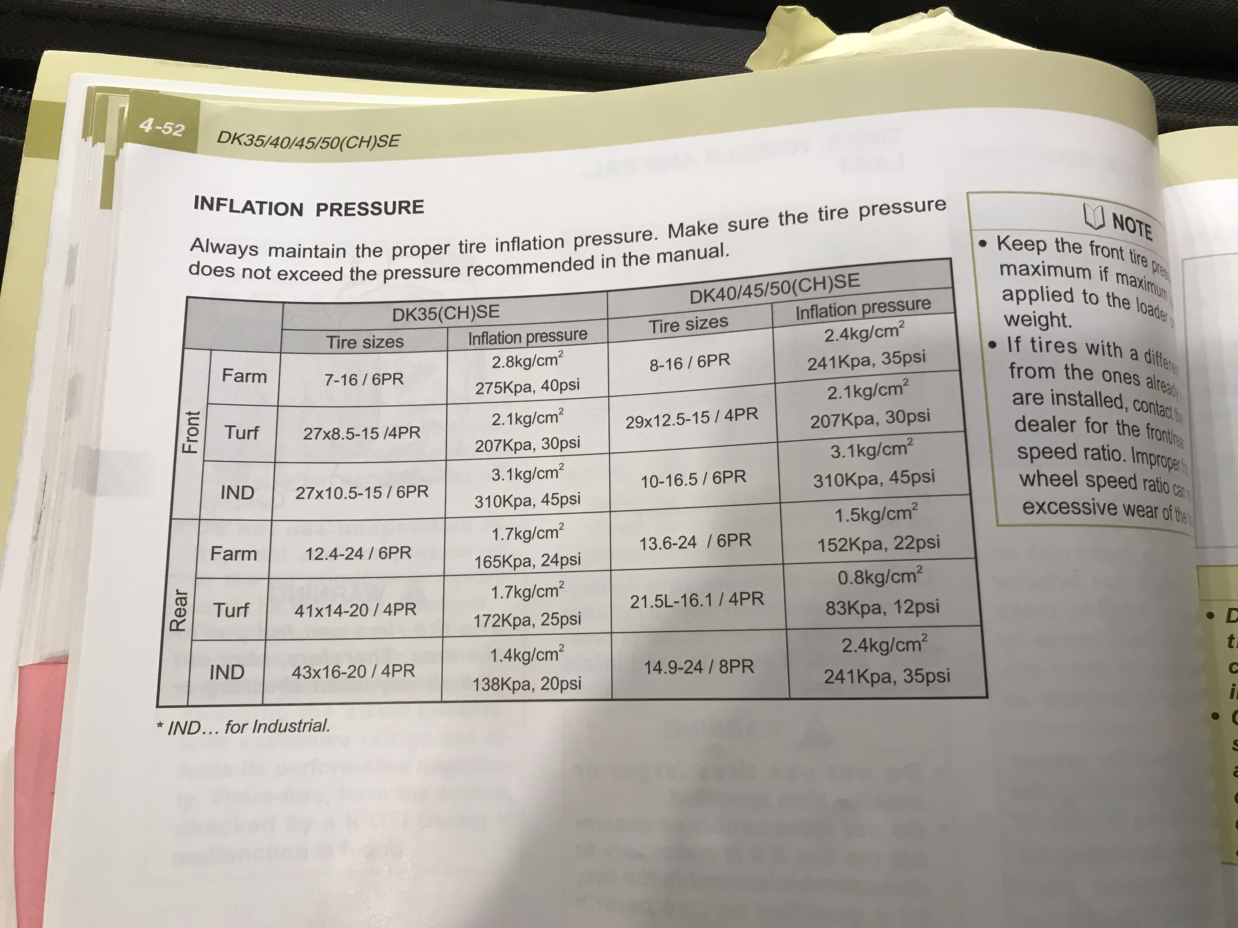

This might help 933DF5FA-3CBE-42E6-A303-A58421E21381.jpeg R4 would be industrial
   / Dk50se r4 rear tire pressure #5
Just a note per that page those are the max not to exceed pressures,
your needed operating pressure could be considerably less.
