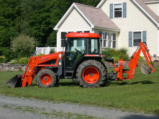

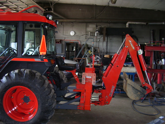

Wow. How does that subframe mount hold up for the BH? Any flexing apparent?[/QUOTE]
No Flex that I can find. This is the same backhoe that was mounted on the CK30, just a different sub frame. It is a good solid mount. The one thing I really like about the Kioti mount is you do not have to remove the lower 3pth arms. :D
These backhoes are very easily to mount and remove. I wish they would make their loaders as easy.

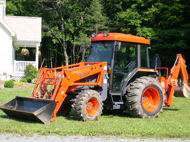

Taking the loader off and on is bad news, in fact I'm not going to do it again unless absolutely necessary. I am mowing now and just took the bucket off and have left the loader on, it's not worth the aggrevation. When I think how simple it should and could be it doesn't make any sense to have the setup that they have.

The problem I am having with the loader mounting and removal is the the pockets on the towers are too deep so there is no way to get the pin holes lined up. I had to use a piece of pipe to rock the pin back and forth to get one out. When putting it back I had to use a sledge hammer to drive the pin in. No way would the holes line up. I am going to ream out the holes some and see if that will help. Or I may start by putting shims in the pockets. I had a Kubota once that the pins just dropped into so I don't think they have to be real tight.

Somebody mentioned greasing the pins and I think Donnie said he ground his down a bit and that made insertion easier. I also had trouble getting the hydraulic hoses reconnected under the cab, they fit to close and tight.

I just went back and read Donnyj's post about taking off the KL451 loader. I have been looking for a way to grind the paint off way into the loader post. Also grind in the inside hole in the tower. I have a dremel and can reach the front hole and about 1 1/2" into the loader post.
I hate to start grinding on the pins because it seems the only good way to do it would be on a lathe or a big grinder.
Could sure use some suggestions on this one.:confused: :confused:
/ DK45sC I did it #27
You really don't need to take off much. The paint I believe is what was causing my problems. It was my idea to taper the end of the pins. I don't think I even sanded the holes where the pins go into. I know the pins are much easier now with some grease. When I sit the loader bucket on the ground flat I can spin the pins by hand. All I used was a small bench grinder on the pins. Good luck!!
My bad.
I don't think the loader was on flat enough ground when I took it off. That would leave it sprung just enough so the holes did not line up. Today I removed it in the driveway where it is flat and both pins turned freely and came right out.
When putting it back on everything went smoothly including the hydraulic connections. That is after I learned to be sure there was no twist in the lines and carefully sort out which line I wanted to attach first and so on.
Some times I learn slowly. Today was one of those days.
However, I will now be taking it off each time I mow with it. :)
