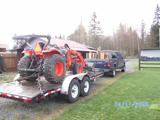

I own an 18' PJ trailer rated for 10,400#. It uses a pair of standard 5200# dexter axles and is built of stout 6" channel. I love the trailer and use it for my 4500# CK30 as pictured since a 7000# rated trailer would have been near the max with my tractor.
I have actually weighed the empty trailer at real scales and it weighs 2500#s. For an 8000# cargo capacity.
I like having an extra margin of safety when setting up this kind of gear and I have been happy with my choice of going a step bigger than needed.
Could you unfill the tires? These Kiotis are awfully heavy as is.
