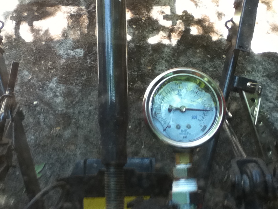

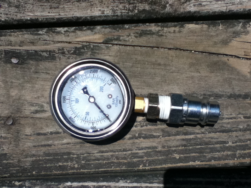

I would recommend pressure testing your aux hydraulics first if you have a guage. This is a simple procedure you need a guage (3000 PSI) with quick coupler ($20-$30 depending on source). Insert this into one of your rear remotes and activate the lever in the proper direction. You should see 2500-2700 PSI (@ 2600 RPM's) and this will deadhead the hydraulics so only activate for a second or so. Also make sure your hood is closed and nobody is near the tractor. If your line is damaged it could rupture when the hydraulic preussre builds to the relief setting.

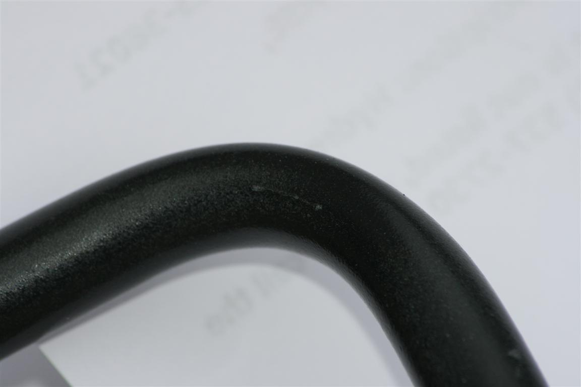

I isolated the leak (drip, drip) by cleaning the line where I thought the leak was then wrapped it with a sheet of paper. I then started the tractor (idle) and waited for the first drip (5-10 seconds) then immediately shut it off. I then crawled under the tractor checked the paper then removed it. The leak is definitely in the second bend of the hydraulic tube J1 coming from the pump. Since I couldn't see up there very well, I ran my finger along the leaking area (tractor off and joystick pressure released) and I could feel what I thought was a crack in the line.

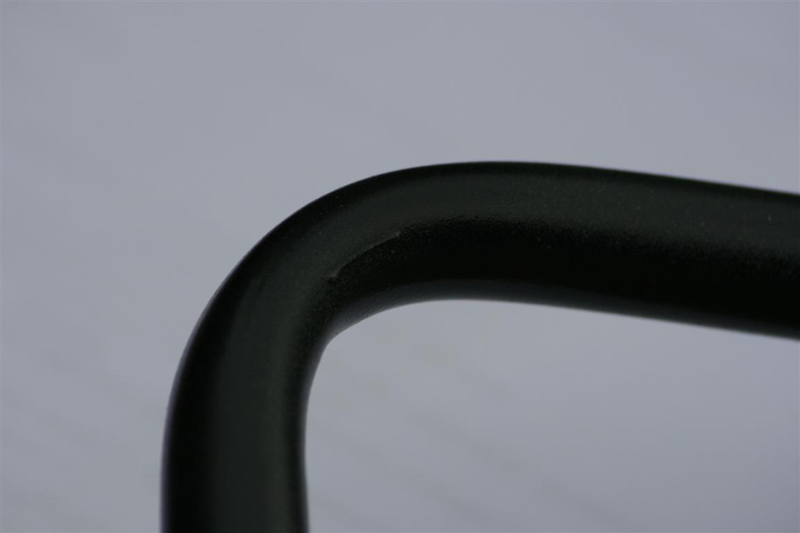

I finally got time to remove the line today and found what I believe to be a defect (see pictures). I hope you can tell from the pictures that this "crack" has been painted over. I would have expected to see paint flaked at this area either from the "crack" or pressure. But then keep in mind that this is a very slow drip, not a high pressure leak/spray.
It appears to me that the during manufacture, the line was damaged while making this 90 degree bend then painted over. I had assumed at first that I had probably gotten a limb up in there that caused it, but now I believe it has just weakened enough to start leaking.
I have a replacement on order, but here's my question. Since my closest dealer is 140 miles away and since I removed this part, and since it's pretty obvious that it's a defect, do you think Kioti will warranty it?

This picture may show the defect a bit better.

That all depends on the dealer. I would call your dealer and tell them what you found. I have heard it go both ways with all brands.
Did you order the replacement line from your local dealer?
I do see what you mean in the pictures and if there are no other marks or signs of damage on the rest of the line I agree. The real question will be if they do and if they minded you doing the work.

Good news. The dealer agreed that it appeared to be a defect. However, I didn't ask anything for my time. :) Don't want to get too greedy. Thanks for all the help.
