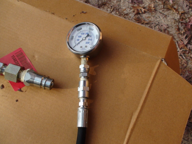

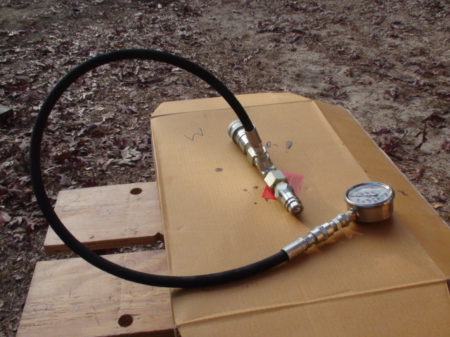

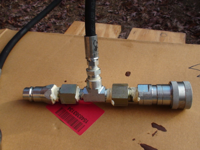

I am reporting back with my findings. It took me awhile to figure out the four different hydraulic couplings types- 1/2" ISO 5675 (Ag- rear remotes), 1/2" ISO 16028 (skid steer flat face at the grapple), 3/8 ISO 7241-1 series A (joystick-FEL disconnects) and ISO 7241-1 series B (WR Long 3rd function FEL disconnects).
The Kioti shop manual specifies 2702 PSI at the rear remotes at maximum throttle (2850 RPM on mine). Test data:
1000 RPM- 2300 PSI
1500 RPM- 2300 PSI
2000 RPM- 2400 PSI
2500 RPM- 2500 PSI
2850 RPM- 2600 PSI
For some reason I was thinking I would be getting maximum hydraulic pressure at 2000 RPM, which is not true per my data. The 5000 PSI gauge accuracy is 2.5% at full reading. So I assume the gauge is accurate at my test PSI and my relief is set a little low. Now I need to figure out how to increase the relief pressure. Does anyone have any first hand experience with Kioti DK tractor hydraulics?
I also measured all four outputs at the joystick-FEL couplings and they had similar pressure reading between the tested 1000 RPM - 2000 RPM. I did not test them at any higher RPM.
The 3' long, 1/4", 5800 PSI hose extension for the gauge is a valuable addition, as it allows me to test any coupling location and still view the gauge from the tractor seat. I also have a 18" long, 3/8", 5000 PSI hose to use as an extension, should that be necessary, along with the couplings and fittings that may be needed.
