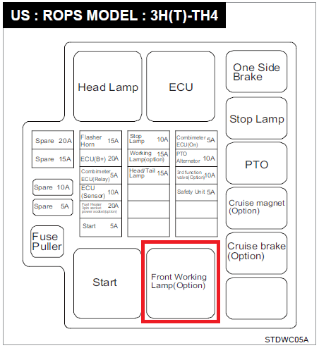

I'm starting to think about this same task, DK4210SE, no cab. I see in the service manual there is a 20AMP line labeled "Working Lamp". I think this is used on the cab models for the working lights on the cab. I was wondering if I could tap into that.

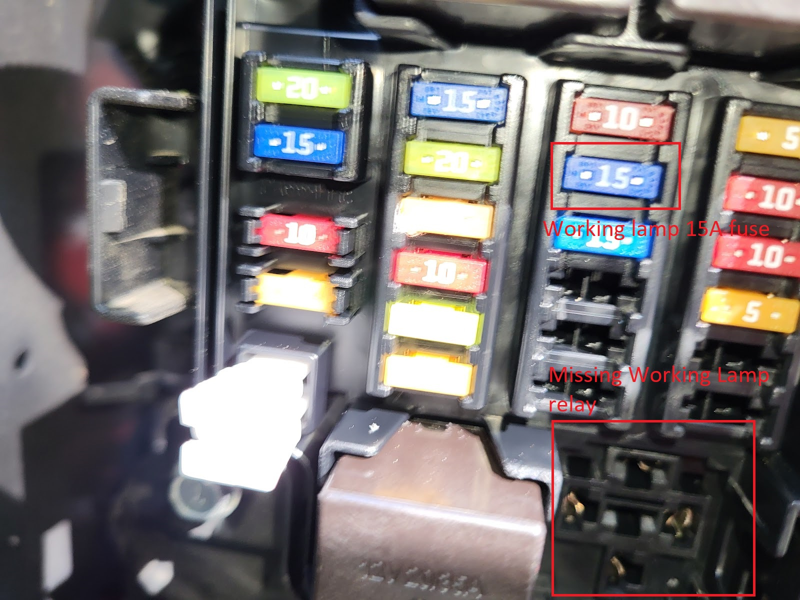

Starting to look at this project.
Found "Working Lamp (F)" wires on the rear right. Meter found no voltage, not even when engine running, lights on. Missing fuse? relay?
Looking at the fuse box, looks like I need a relay. Just a dummy plug in there now.
Not sure what relay to buy, seems it should match the one in the head lamp, but not sure.

Okay that would make sense. Likely powered when key on. And yes then switch to control lights. It’s probably the same relays as others in there. Depending on the pin style you might be able to use just a generic automotive relay.

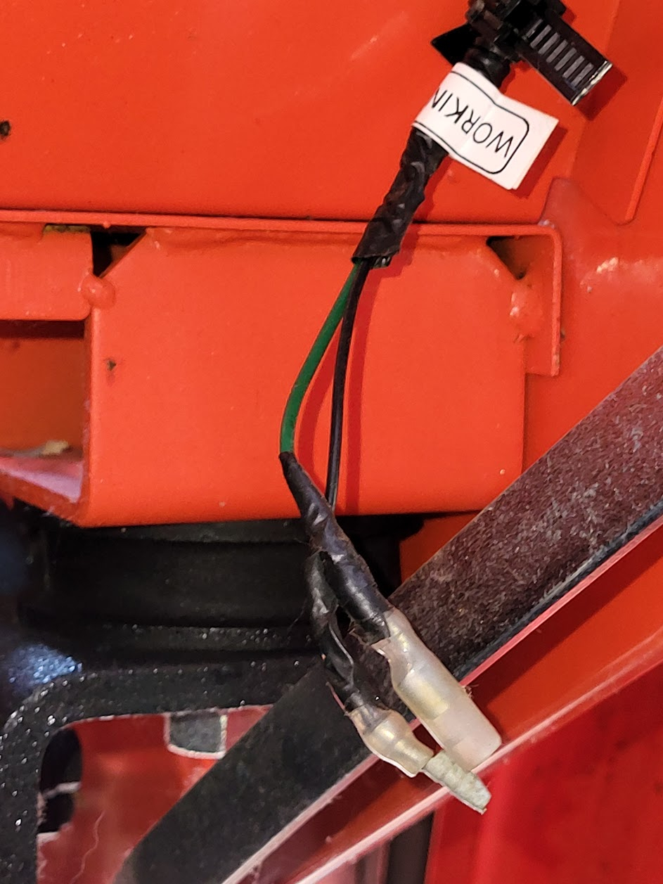

  • There is a set of green and black wires tucked up on the far right and far left at the back of the tractor labeled "work lamps".

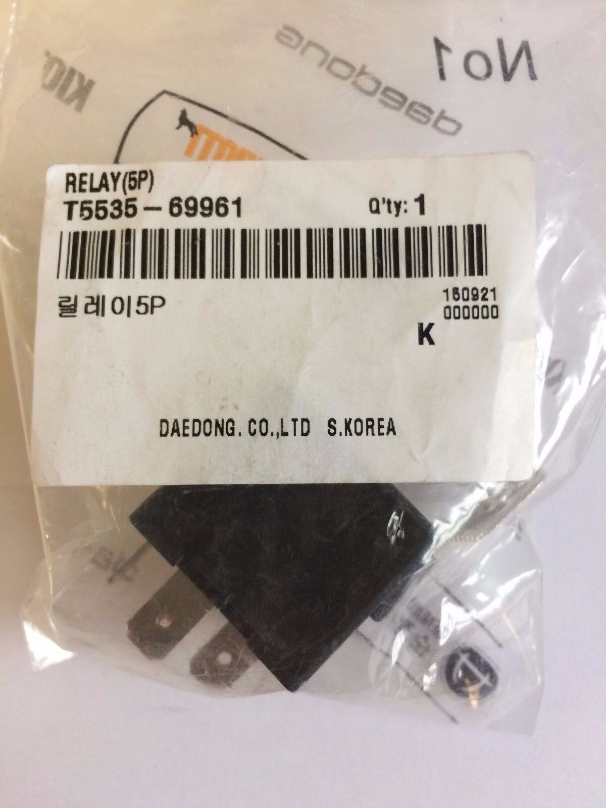

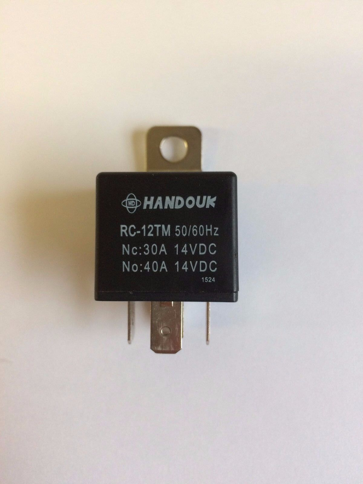

  • These are referred to in the manual as Rear Working Lamp L & R. You'll need a 5 pin relay added to your fuse box per the earlier photos. I didn't confirm but you'll probably need a switch.
  • See photos on the relay you'll need, but any 5 pin should work. I'd just match the 14V rating and get one rated 40A normally open, and 30A normally closed which matches the Kioti version. The Kioti version is ~$25 on Ebay from some of the Kioti dealers with an Ebay store.

  • There is a set of red/blue and black wires tucked up in the center at the back of the tractor. No label on these, but per the manual they're referred to as Front Working Lamp.
  • You do not need a relay for these. They are energized with key on.
