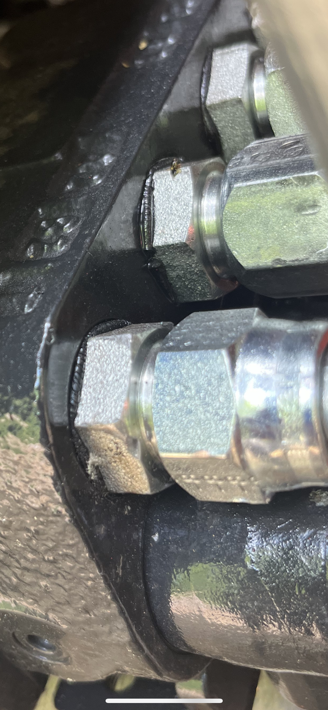

2022 Kioti DK4210SE
I have a 2022 dk42 that keep leaking for the o-rings on the joystick valve (where the hydraulic hoses for the loader connects). The first time it happened my dealer told me to just replace the o-rings (I did'nt want to make him come all the way to my house for a 0.25$ o-ring). It has been 2 months since I changed all the o-rings on it. Now they are all cracked and dry, I guess I did not use the right O-ring for it which is surprising because I bought them at a hydraulic shop.
Anyways have any of you ever and a leak from there and what is the "right" type of o-ring to use? Could I have caused the leak overtightening the fitting in the first place?
It seems that both times that it started to leak I was connecting/disconnecting a hose on the rear remote.

/ Dk42 Joystick valve o-ring keep leaking #2
Something ain't right with those fittings and o-rings. The o-rings shouldn't be squishing out like that.
Would you mind pulling one of the fittings out and take a couple pictures of the port on the valve and the fitting? So we can get a better idea on which type of fittings we're dealing with here.
/ Dk42 Joystick valve o-ring keep leaking #3
When you remove the fittings from the valve body remove the O-ring and then reinstall the fitting. How close is the O-ring chamfer - counterbore to the edge of the hex?
These are not a standard size seal but hydraulic shop should have known that to large of seal will not fit into the chamfer and cause them to extrude like that.
No special seal material should be required
/ Dk42 Joystick valve o-ring keep leaking #4
Viton is common but it looks like you may have the wrong size. When installed properly you should not see the o-ring hardly at all.

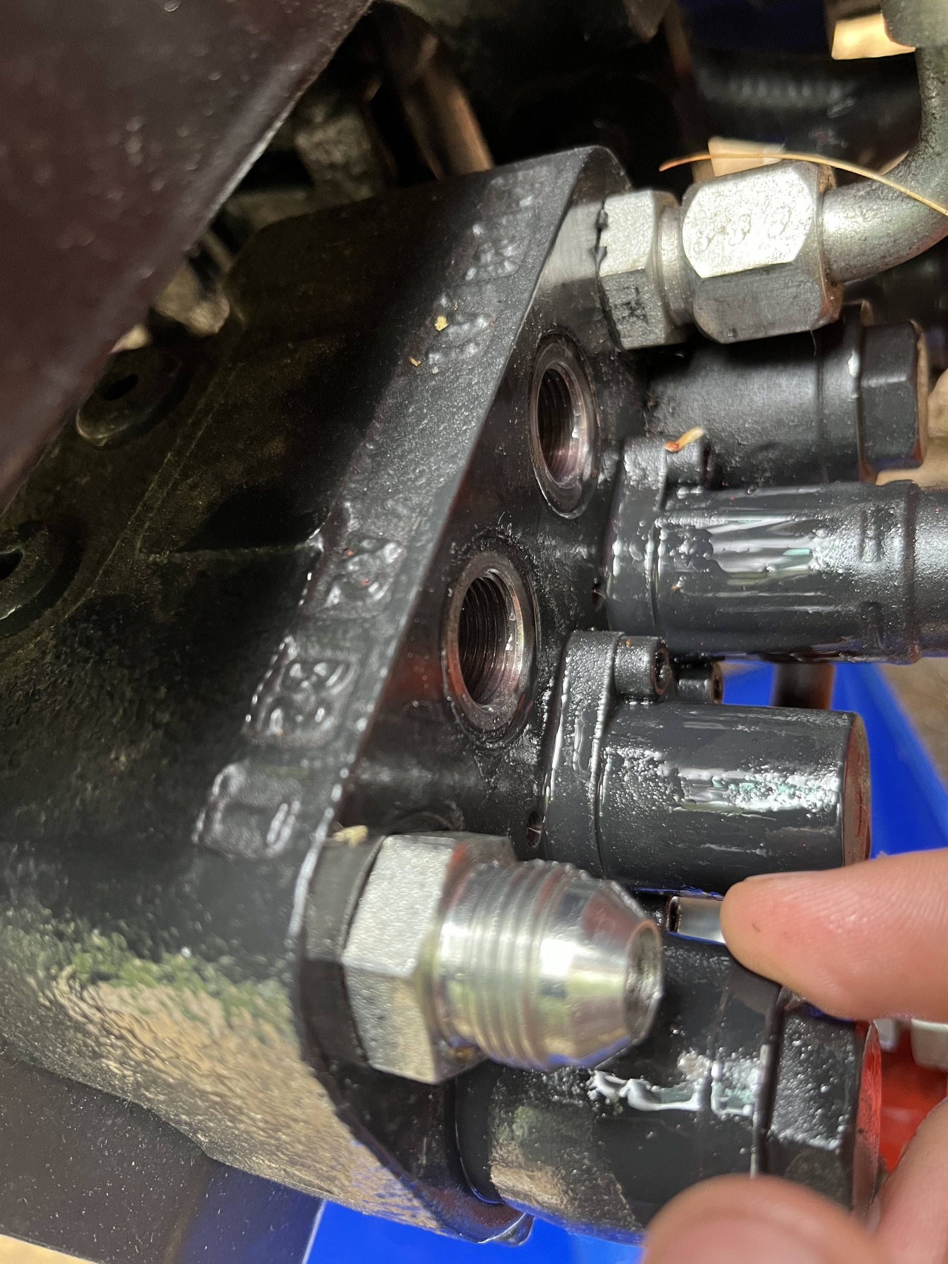

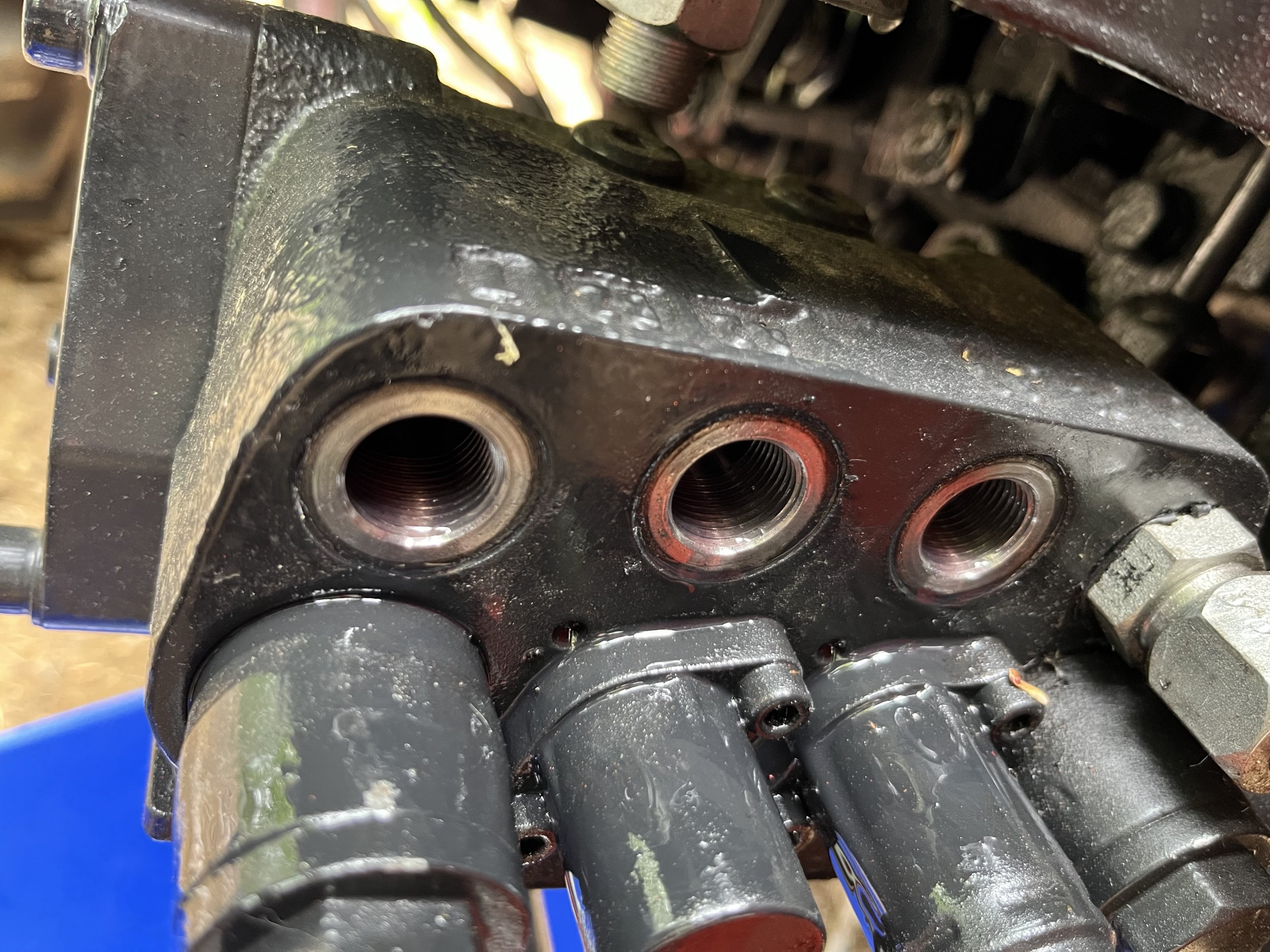

Here are the pictures of the ports

/ Dk42 Joystick valve o-ring keep leaking #7
I do not see adequate chamfer on the ports for typical O-ring boss style port. Curious if possibly BSPP or metric that require metal seal ring like ptsg posted.
Can you measure the thread diameter and threads per inch on the fittings?

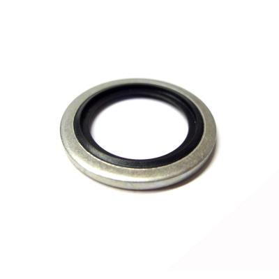

Thank you for the pictures. Looks like indeed a good place for a copper washer or a dowty washer. I edited my first post as I thought for sure it would be the O-ring boss fittings after Oldnslo mentioned it.
