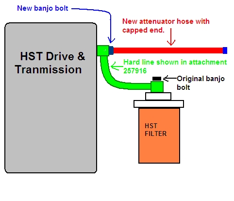

I took a look at the hose install on my DK-40 and was surprised to find that the new attenuator hose ONLY connects to the transmission and is capped closed at the other end of the hose. It does NOT return to the HST filter. So, this leads me to believe the current 'solution' to the squeal is like what plumbers do to stop water hammer in old plumbing systems. Meaning the hose acts like a dampener to allow hydraulic fluid to pass out of the transmission and into the rubber hose. This dampens the fluids need to expand quickly with nowhere to go prior to the hose being introduced in place of the 'original style' 'U' shaped metal pipe which came on all our DK-40's. This is just my THEORY, again NOT fact, except for the hose only being attached to the transmission.

Can you get a picture, I just trying to understand how Kioti connected it up? I'm wondering what port Kioti connected it too. I thought that hose looked like it was capped at one end.

The pics I already posted show the hose exactly as it attaches to the tractor. The end with the right angle fitting is bolted into the transmission case on the left side of the tractor. The capped, (plugged end) is held in place alongside the transmission housing by a large cable tie. This same capped end is left to dangle toward the rear of the tractor. (I will probably tie a short length of string to it and secure it to something near the rear differential to keep it from moving around more than necessary). That's all there is to the install. Where the old U -shaped metal pipe had connected to the top of the filter housing is now plugged with the original banjo bolt.
No significant amount of hydraulic fluid is lost during the install.
I now have about 20 NOISE FREE hours on the machine, since the install, not a single peep of 'squeal' at all. I am continuing to lift and move huge loads of mud/ stone, etc. from my roadside ditch and other locations on my property, all of which puts the tractor thoroughly through its paces at maximum capacity re: load and lifting.

Coyote, I reviewed your postings but don't see a picture of the transmission where the hose attaches. I only see pictures of the parts.
   / DK40SE Squeal When Moving in Reverse.
#360
Coyote,
I missed the new banjo bolt design. Is this how kioti configured it, please see the attached diagram. If this is the configuration what the hose size and length? The size and length is critical for the attenuator to work correctly.
