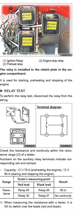

The dealer just called and is sending me out a new ignition switch and a new relay. I don't think it is either one but it will be nice to have spare parts.

The start relay coil is inside the relay. These relays generally have 5 electrical connections: (1) normally closed contact (opens when energized) (3) normally open contact (closes when energized), (1) center contact (switches from NC to NO contact when the coil is energized, and two connections for the coil. The coil closes the NO contacts regardless which way the current flows through the coil but the wiring harness/connector establishes one end of the coil as the 12v side and the other as the ground side.

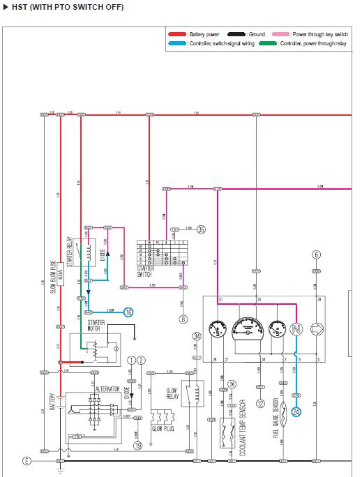

Only the starter. There are no actual switches (except the key switch). The cruise unit senses the voltage from the gear range potentiometer and the voltage from the PTO switch and connects the ground-side of the start relay to chassis ground if (and only if) the cruise unit is working and it decides the shifter is in neutral and it thinks the PTO is off.

OK, I am back home from work. I changed all my fluids yesterday cause I have 85 hours. I checked the cruise module connectors and they seemed fine. In fact, the module and all the connectors under the tractor were clean and free of dirt and mud. I checked the relays and they are fine. I also noticed while messing around that when the tractor wont turn over the battery light doesn't illuminate on the dash. Should it all way's come on when the ignition is turned on? On a side note. you all were not kidding about the filters on the tractor. Holy crap were they on their tight! I used a strap wrench that I bought at Home Depot made by HUSKY. It worked like a charm. Just kept as much pressure on it as possible and she sun off without having to remove the rear wheel or using screw drivers.
Nick
/ DK40HST Won't Start. #40
... I also noticed while messing around that when the tractor wont turn over the battery light doesn't illuminate on the dash. Should it all way's come on when the ignition is turned on? ...
Now this is interesting and it also points to a sick cruise unit. When the key is on and the alternator isn't turning, you should always get a battery/alternator light. Assuming your DK40SE schematic is the same as an EX schematic (and I think it is), the circuit for this indicator light is dirt simple except the ground for the light, comes from the cruise unit.
http://kioti.dyndns.org/ex_Schematic.pdf
So I think Nick has a cruise unit that fails to provide the ground for the battery light and also fails to provide the ground for the start relay when the cruise unit/module gets hot. It would be nice to take voltage readings at the cruise unit connector during the failure mode, but that's hard to do given the unit location and sealing of that connector.
I predict that the new switch and relay from the dealer will make no difference. I think we know enough to recommend replacing the cruise unit. See if you can get the dealer to send a new cruise unit.
