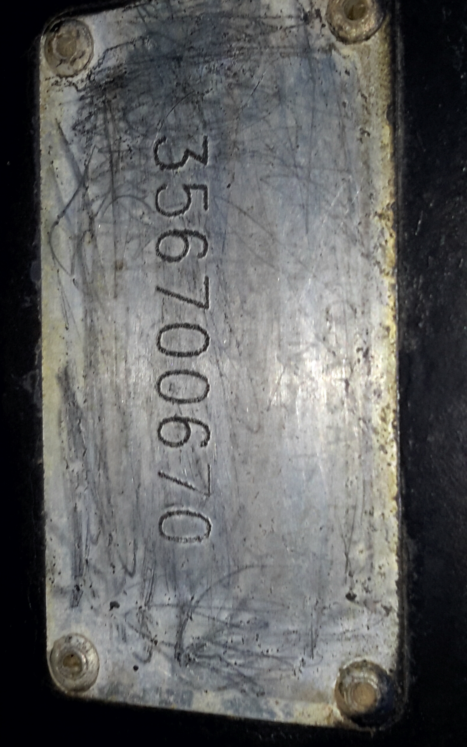

The tag is pretty weathered (all silver), There is some more lettering on it above this number. I can make out Daedong and Wilson. The tag is located on the left side just ahead of the front axle on the frame that supports the brush guard. I can see no letter at the beginning of the numbers. One of the owner manuals that I have says that the tag is located on the transmission housing on the left side. I did a quick look and could see no tag there.
The tag that is front is the one you want but if you can't read it it does you no good. Do you have a pic of the trctor?

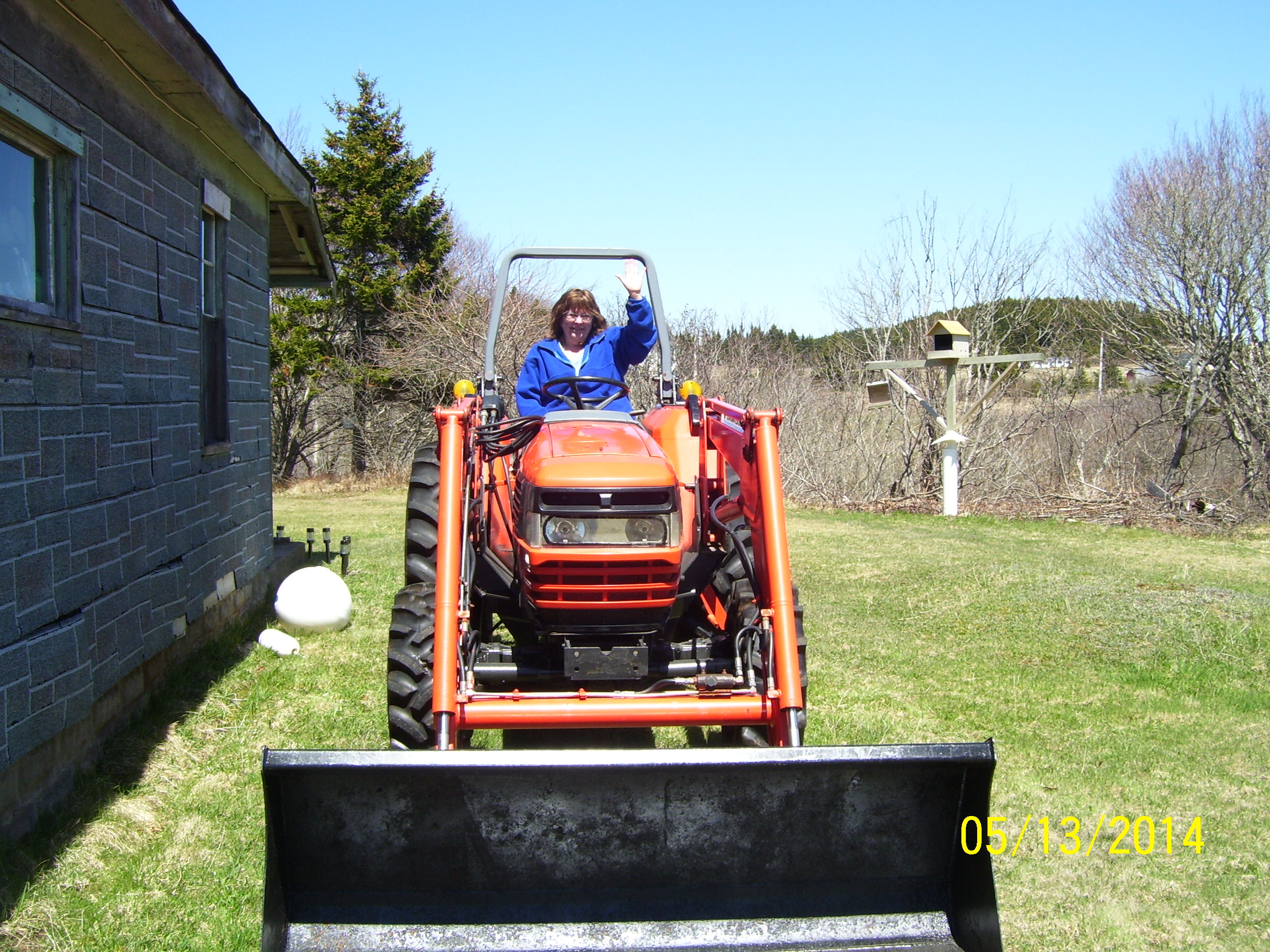

If you can go on my profile there is a pic there. I checked the provincial registration and that is the number on the registration as well.

Here are a couple of shots I was able to upload.

Appreciate you cannot read the serial number. From the photo it appears you have a DK45. If you know it is a 2005 (or probably anything close say 2003-2006 or early 2007) then that is about all you really need to figure out what maintenance manual you need.

Here's a pic of the tag I can just make out above the number Daedong usa and just below that Wilson No usa. If there was a letter on there it wasn't stamped on the plate.
I believe that means it is is a 2003 (build year) model, type 567 (specific model), serial number 00670. Before 2004, Kioti used the last digit of the year as the first digit of the serial number. A 2003 model very well may have been purchased in 2005. Starting in 2004, they went to the letter system:serial_number
Now that makes sense, because there is no letter on that tag. I am confused by the year sold versus the year built. Is that typical in tractors? What does that do for manual and parts? Would a 2005 do it or should I be looking for 2003 documents? Appreciate your input.
