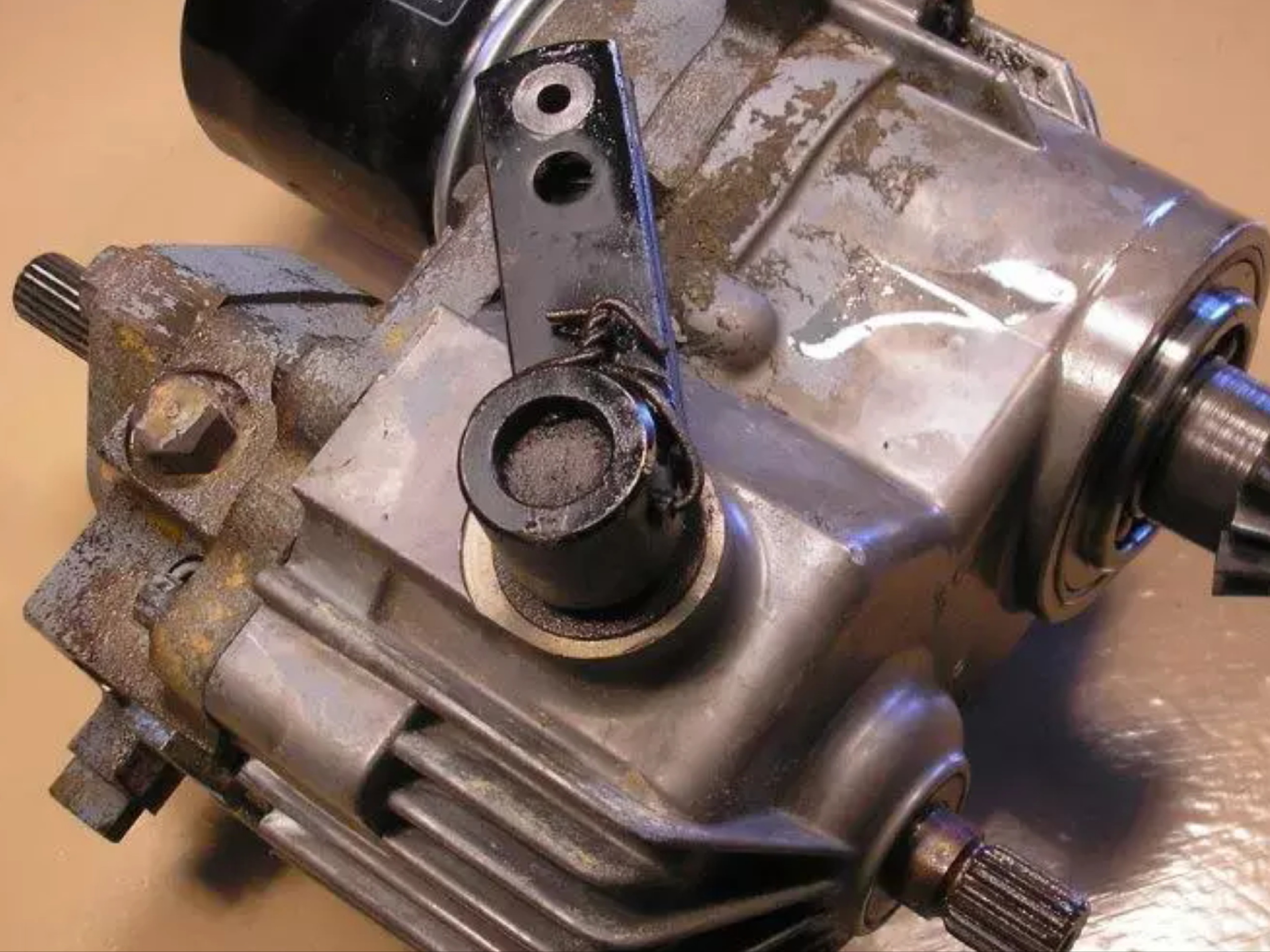

Although this is an old thread, I'll post a solution I just found that fixed the "flakey shifting" problem on my 2011 DK35SE HST.
Over the last couple of months I had an increasingly difficult time shifting from Medium to High range. I tried lubricating everything as noted in this, and other threads. Today I could not shift to High at all. The shift lever would hit the front stop on the tractor frame before it had moved the gear far enough to engage in High.
Taking a closer look I noticed the spring pin that attaches the shift arm to the shaft that goes into the transmission was protruding to the rear. I used a hardwood board and hammer to push the pin back in, and that fixed it. I am fortunate to have found it before the pin completely worked its way out.
A pin was also protruding a bit toward the front of the assembly, and I thought it might be broken. However, it appears to be a spring pin inside another spring pin shown as parts 2 and 5 in this diagram from Michigan Iron:
Parts Finder Michigan Iron & Equipment Morrice, MI (855) 265-459
The inside pin was wobbling around inside the outer pin. It may also explain an intermittent I starting problem where the range selector showed being in Neutral but the starter would not engage. Perhaps it caused the range potentiometer in the control circuitry to send out a flakey Neutral-range signal (there are two values), thus preventing starting.
Anyhow, if range shifting is flakey another possibility might be the spring pins on the shift lever shaft.

Kco, glad you got you problem resolved and shared your observations. If you are afraid the rollpins may work their way loose again you may want to thread a wire through the rollpins and twist around the shaft.
It won’t stop the pins from egging out the hole if they are that loose. It will keep them in place though.

KCO, I bolded and underlined the section of text above in your post, and have a question about it.
I too have had issues with shifting with my 2010 DK-40 HST. I notice when I go to start, the range selector will be in the neutral position in the shift slot, but the dash light will read that it is in say 'medium'. So I move the selector to medium in the slot. Then the engine will crank and start as it should. Once started the dash light will flicker between neutral and medium while operating the machine. I've done the 'reset' sequence a number of times as outlined in the workshop manual. That seemed to resolve the problem for a while. More recently, the problem seems to be more constant than not, so I just put the range selector in the medium spot to start, otherwise the starter will lockout as you described. Do you think this is the same situation you were detailing, where the roll pin(s) have allowed the shift mechanism on the trans to indicate a physical misrepresentation of the actual location of the transmission's gear selector? Curious how many hours on your machine?

I don't know if the loose pins were causing my intermittent starting problems. However, they seemed to be occurring more frequently as it got harder to shift into High. I guess I'll know if it was related if the intermittent starting problem disappears.
Re: your question about the hours...my tractor is at 1,395 hrs.

That's an excellent suggestion. I added a wire this afternoon and will keep an closer eye on the roll pins. As K0UA suggests, using two roll pins is a questionable design. I've got my pins back in but they are not completely flush on each side of the collar. If I tap it flush one way the 2-pin assembly slides. So the smaller pin is not completely in the larger pin. I got it fairly close by squeezing the two with channel lock pliers but will align them better when I can get some help. It is an awkward place to work. I can tap the larger pin from the front side with a hammer but need to use a piece of rebar to tap the smaller pin from the rear side. I'll get my neighbour to help so one of us can hold a large hammer against the front side while the other taps the pin from the rear side.

Thanks for the reply. Here's what I'm thinking about your intermittent starting issues. Since the starts became more difficult as you found it harder to shift into H, I think that speaks to not being to get the trans in H gear might also mean the 'brain' is/was not able to 'see' neutral, therefore it would lock you out when you were neither in H or N?
You might have 'seen' the gear selector as positioned at N, when the lever at the trans was sending a signal of being in gear, thus locking your starter from cranking?
Can you closely monitor what position the gear selector stick shows when you go to start, AND what the light indicates as gear position on the dash? if they're consistently the same, the 'pins' adjustment(s) and wiring them in place may have solved your issue(s).
You do know there is a procedure in the workshop manual to sync the shift selector's 'pot' with the cruise control module, which controls the starter lockout? (At least that's the way I recall it being wired last I looked...).
I'm not at my tractor currently, but we are close in hours on our machines. I find often persistent problems seem to occur at similar hours on the same machines.
Please let us know what you find on the starting; if it improves or stays the same. I'm betting on it is improved, or better yet, solved.

I've put on 13 hours (now at 1,408) since fixing the roll pin and it seems to have fixed my flakey start problems. Although I had not had outright failures to start for quite awhile I noticed that as the shifting got more difficult(and finally failed to go into H) the starter was acting strangely. The starter would engage and the tractor would start with the first "hit" and disengage before I released the key. Perhaps the floppiness in the shift linkage was affecting the pot signal? I've started it many times since fixing the roll pin and the flakiness has not reappeared.
