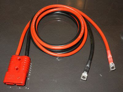

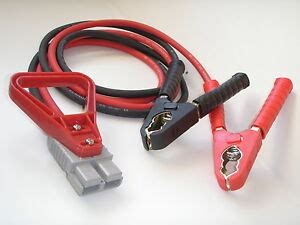

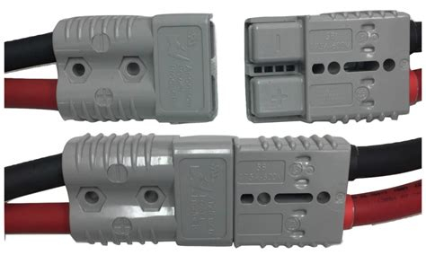

The battery compartment has a plastic cover held with 4 screws, not hard to get to but still a pain if you are just wanting to jump. I was looking at adding an Anderson quick connect plug on my DK4510MS like we used at work on all of our trucks. It looks like I could just connect the hot lead to the starter solenoid lug along with the battery cable instead of trying to connect to the battery.
Below are some random images of the connector, you can buy the parts or buy cables already made up. You will also want a short pigtail with clamps for regular use.

Thanks - that's exactly what I will do - already have one on my F350.

Thanks for the manual - I downloaded the whole thing - think I am going to mod it with and Anderson plug system.
