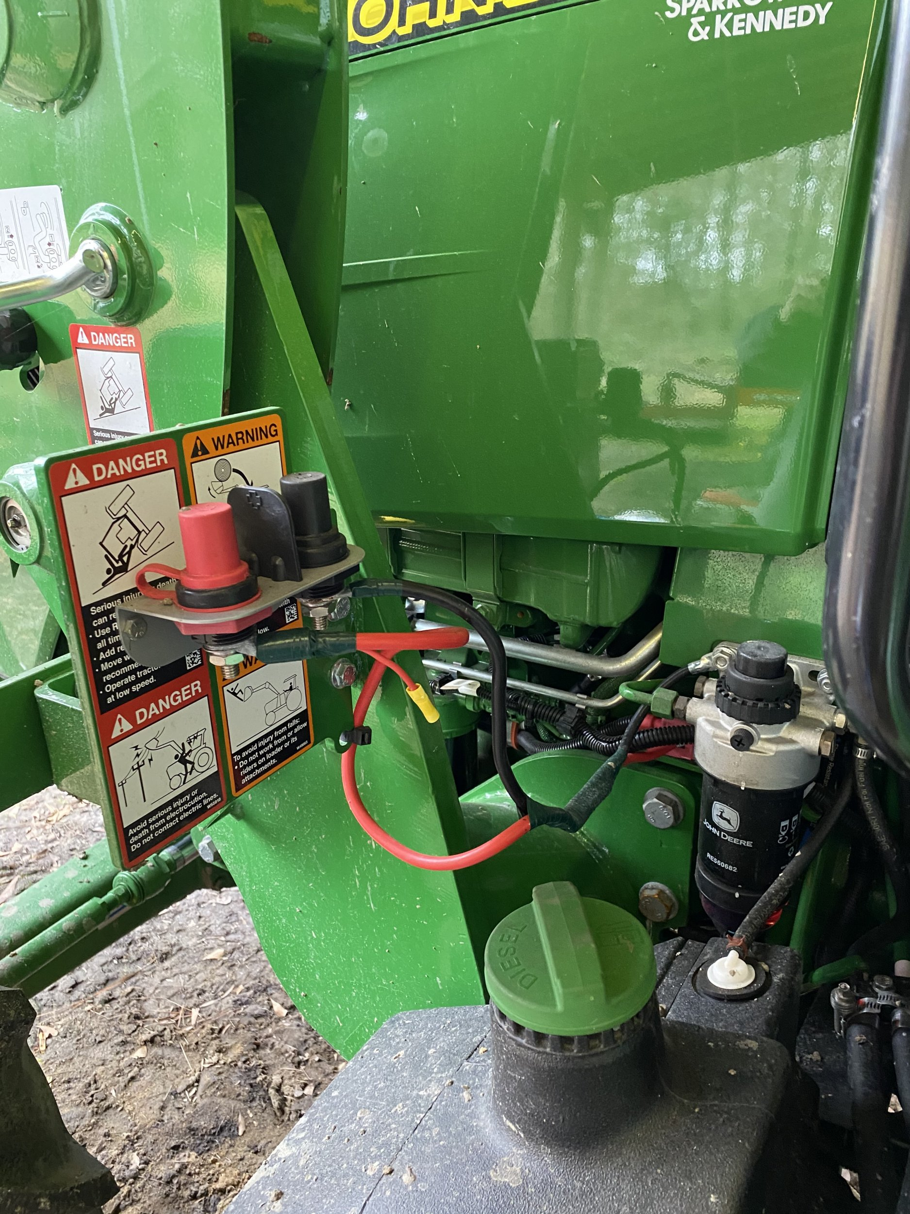

So I have a suggestion regarding the jumping issue. I installed one of these from Summit I think. It's a remote battery post setup that drag racers use. I needed it to power my 12 VDC fuel pump when I fill my tractor from my 200 gallon fuel tank that's on the trailer. This setup keeps me from having to raise the hood and fish the cable to the battery. It's also really handy for jumping other equipment off. I just ran #2 copper to it but you could upsize that to whatever you need. As far as servicing the battery, My battery in my old tractor lasted 10 years. It was a sealed battery. The replacement lasted 7 years and the third one until I traded it.

Workinonit - Thanks for the tip - I have a similar system that uses heavy duty waterproof plugs for the winch on my 350 Super Duty so I can set up the winch on my rear receiver. I will put a pigtail on the battery terminals with one of those plugs if it seems like access is "difficult".
