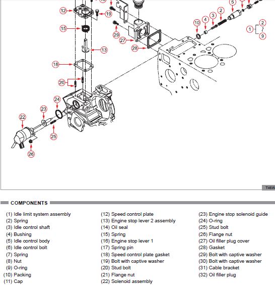

Does any one know just what the pull coil relay does and how to replace one on a Kioti DK 35? Thank you
/ DK 35 SE pull coil/ engine stop solenoid #2

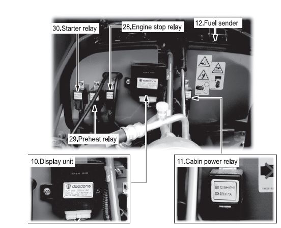

What would you like to know? The Stop solenoid has two winding's. It is easy to replace on the front of the Injector pump. The winding's are a pull coil which draws about 28 amps (low resistance coil) for 1 second, driven by the stop solenoid relay on the firewall, (very easy to replace) and the hold coil which draws less than 1 amp and is hooked to the key switch buss. The idea is that the large current needed to pull in the stop solenoid is just needed to get the pole piece (or armature) if you prefer moving, and the small current (high resistance coil) is enough to keep it back. When you turn the key switch off, then the hold coil de-energizes and the solenoid relaxes. There is more of course, as there always is... how much of this diatribe did you understand and how much more did you want?

What you have described is the engine stop solenoid, it is not a relay as such it is a solenoid. It operates the fuel rack inside of the injector pump. This solenoid has two coils and a ground connection, It seems like the older models may have gotten its ground from the chassis of the tractor, but in any case it has two coils. The pull coil, and the hold coil as I described above. The relay that "kicks" the pull coil of the solenoid is up on the firewall, the third relay as viewed in the photo from left to right. The hold coil of the solenoid is energized by the key switch 12 volt "on" buss. when you turn the key off the hold coil de-energizes, and the fuel rack moves in the opposite direction in the injector pump and that stops the delivery of fuel and the engine dies.

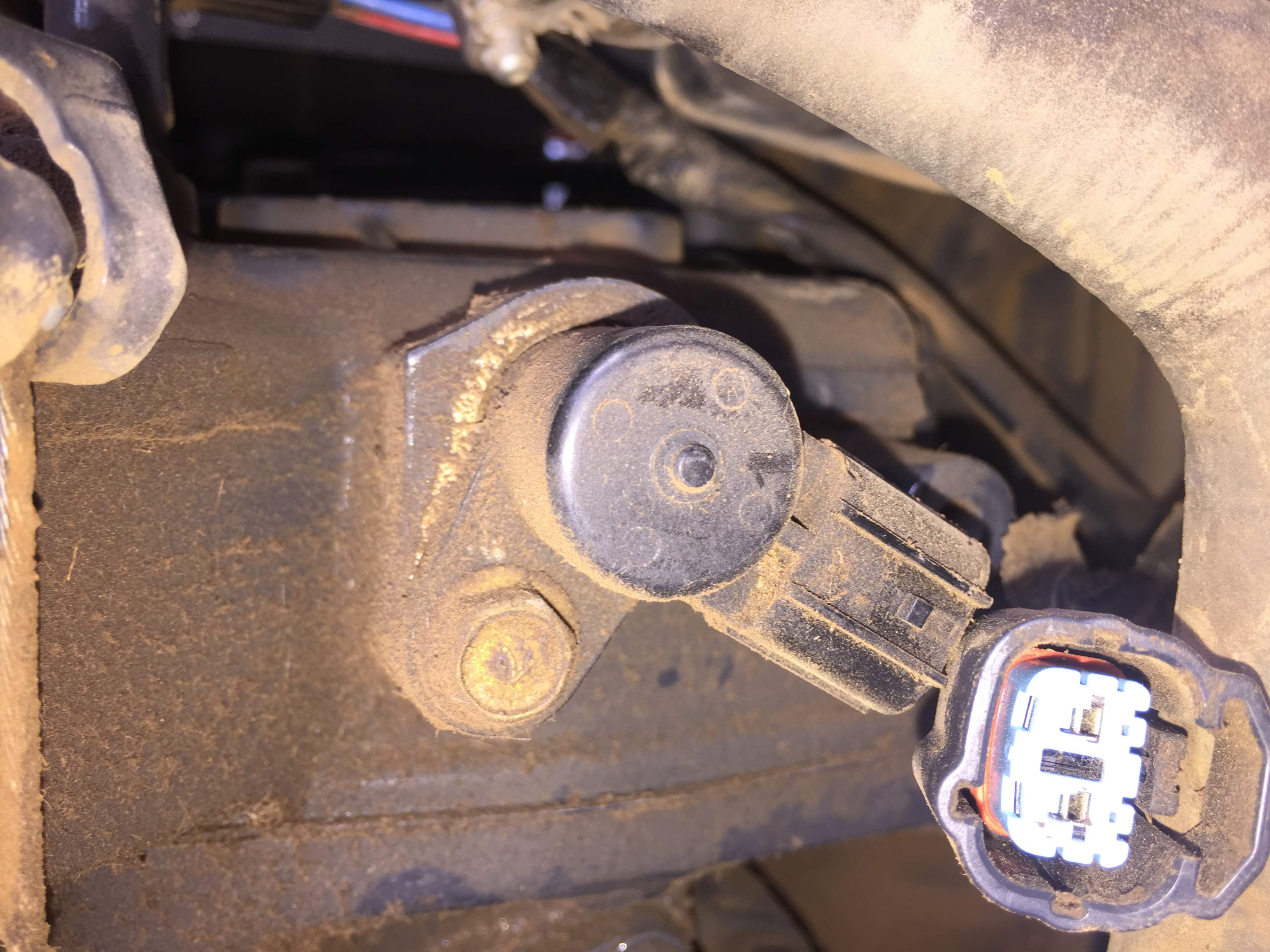

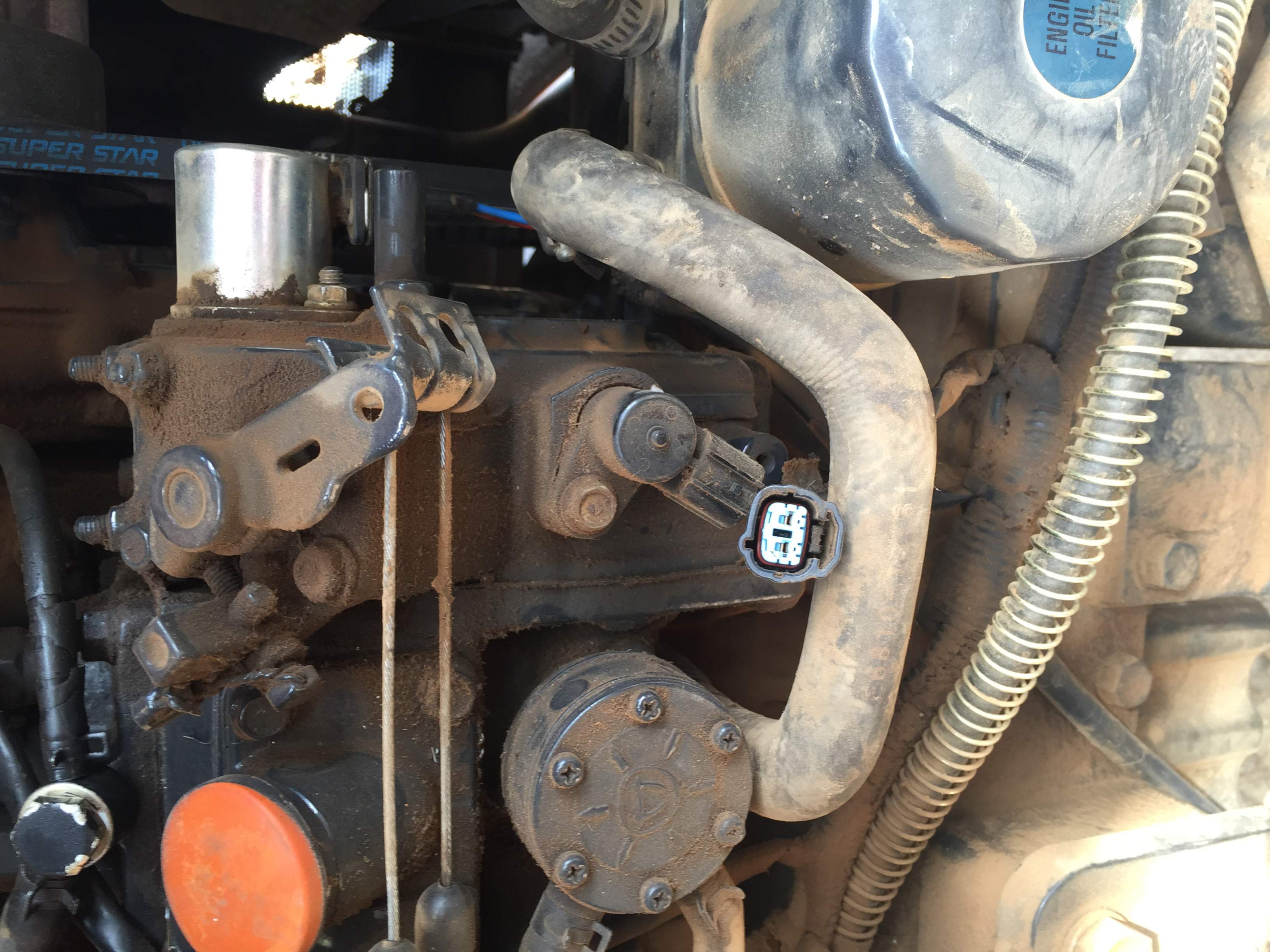

here is what I am talking about. From what I have been told the silver item upper right is the engine stop solenoid. I would like to know what the item is that I unplugged is? Thank youtractor pull coil 2.jpg

The photos show the engine stop solenoid a its associated waterproof electrical connector. The engine stop stop system will not prevent the engine from cranking. It's purpose is to close the fuel rack to stop the engine from running. As for why the fuse blew an now does not, I don't know. Obviously the over current condition has been removed. The starter relay is the first relay on the firewall. And is the same size and configuration as the stop solenoid relay. It's function of course is to provide power to the starter solenoid.
