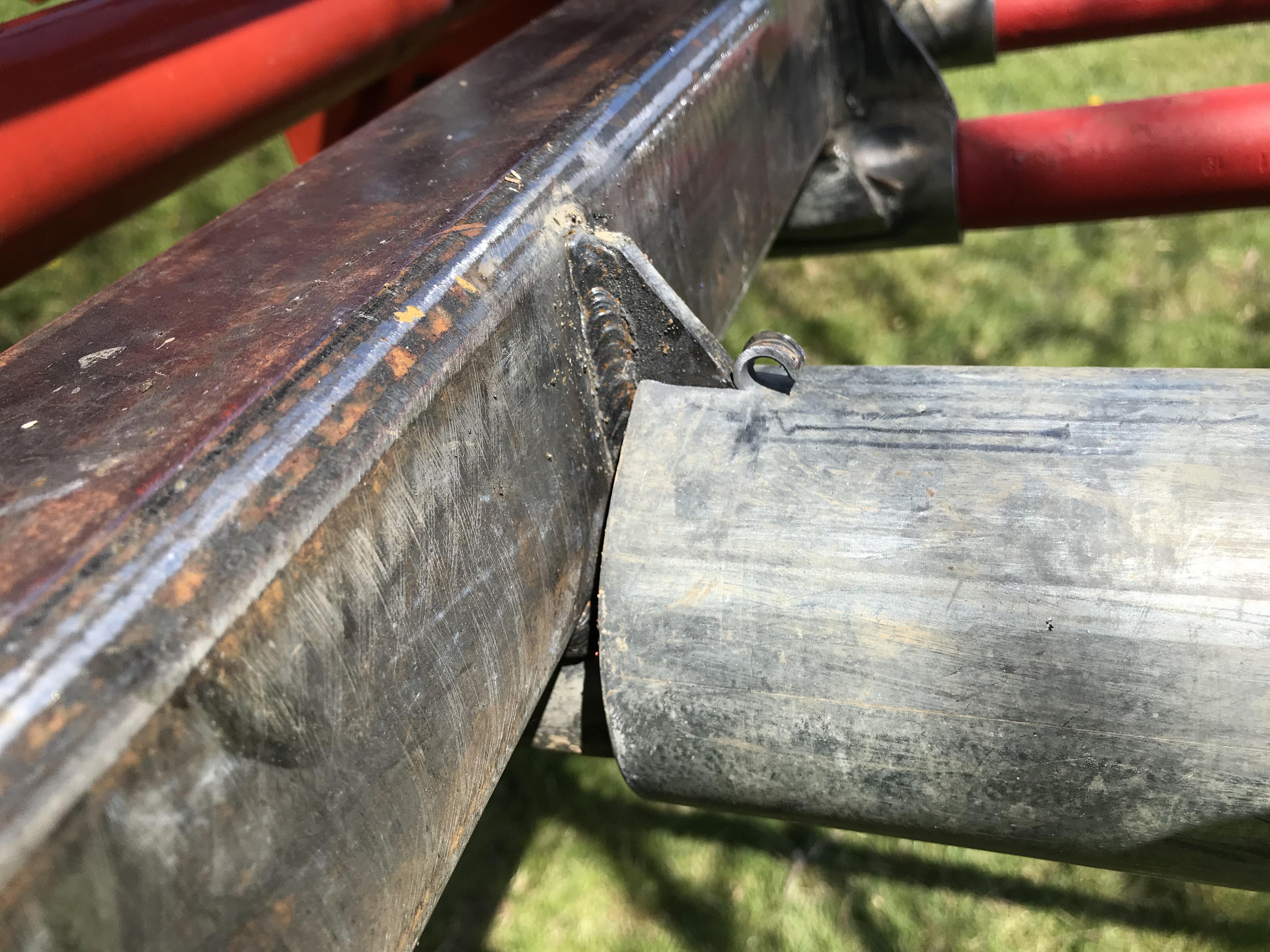

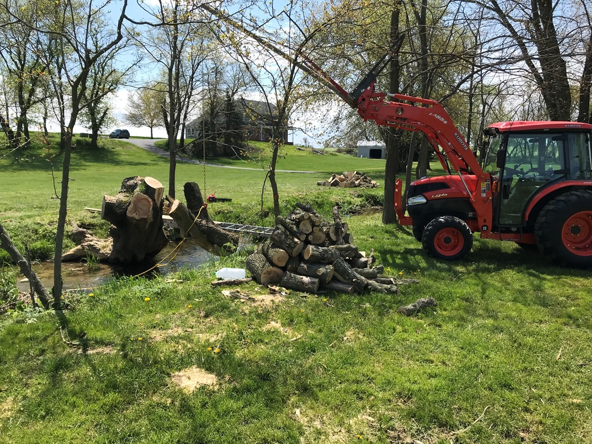

Pallets or loads that require specific fork spacing have not been a requirement for me in the 35 years since we built here. The two sets of forks I built were mostly for brush and picking up and carrying assorted "stuff".
I'm a hobbyist and have used a Millermatic 175 (some deride them as "glue guns") for most everything I made until just a couple years ago when the Everlast 200STi came along. 90%+ of the welding done with the MM175 was with flux core because of welding outdoors. There's always some wind here.
The L3200 had a pin-on bucket, so those forks mounted to the bucket. The chains on the front were only for getting the forks mounted. With the forks on the ground, the bucket was put into the dump position, chains were dropped into the slots. Then the bucket was curled and the bucket edge went into the "receiver" on the forks. Actual fastening of the forks was an unseen binder on the back side.
The L4240 forks are made from 5 bale spears. These have been abused. While working on a tree trunk I did have one rear wheel lift off the ground and the forks are still OK.
In the one picture below there's a 10' piece of 3" EMT on one tine so it could reach over the creek to catch a piece of a tree trunk. The EMT was slipped on and two chains were run to the slotted angle on the fork frame. When the trunk let loose the EMT was shock-loaded enough to shove it back onto a gusset that curled it open like an old Spam can. That helped allow enough of a change in the setup to bend the tine down quite a bit. If you look closely you can see the tips of the four unused tines are maybe 10" higher than the one inside the conduit. When the load was removed the tine went right back where it belonged.
