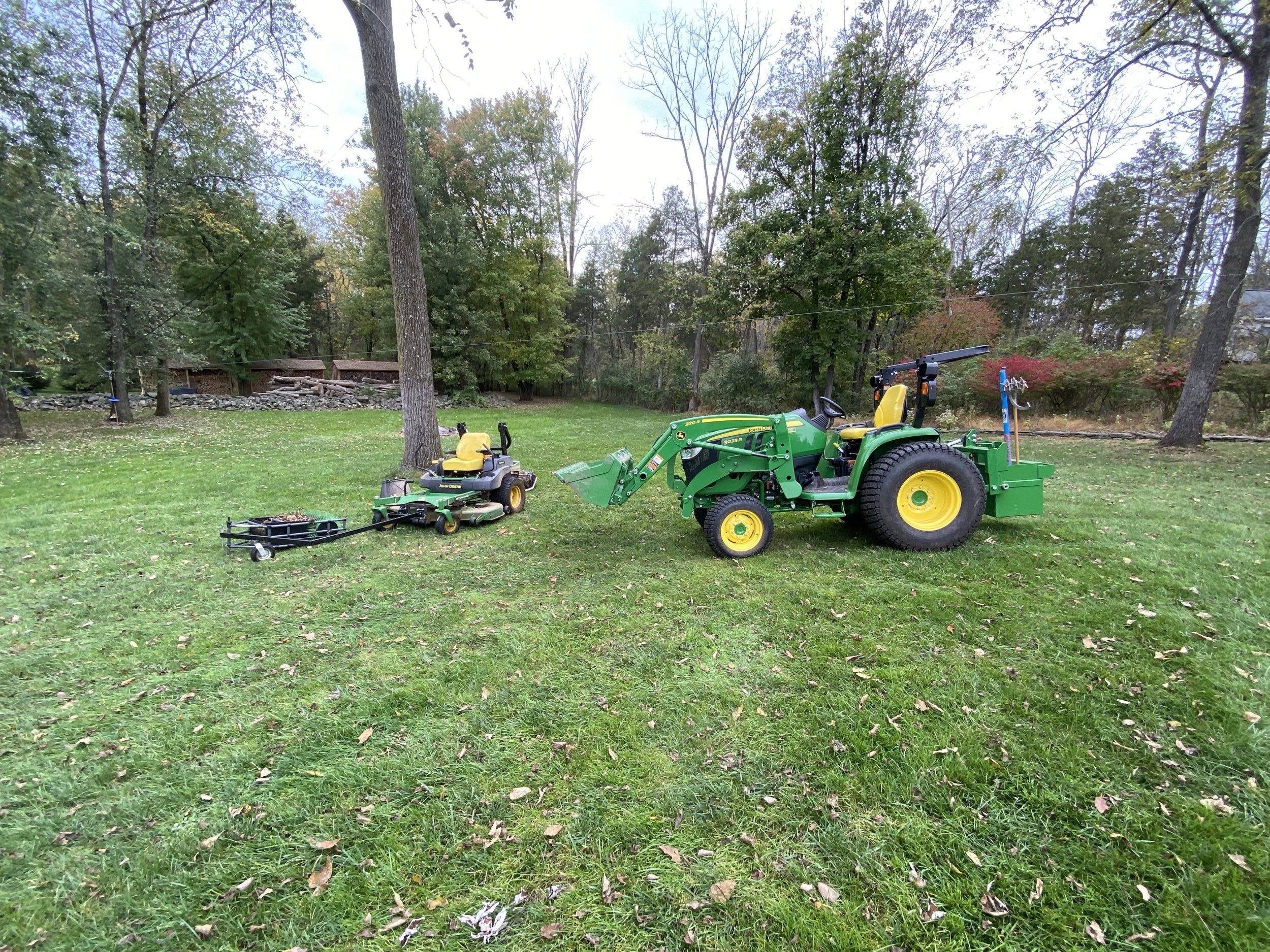

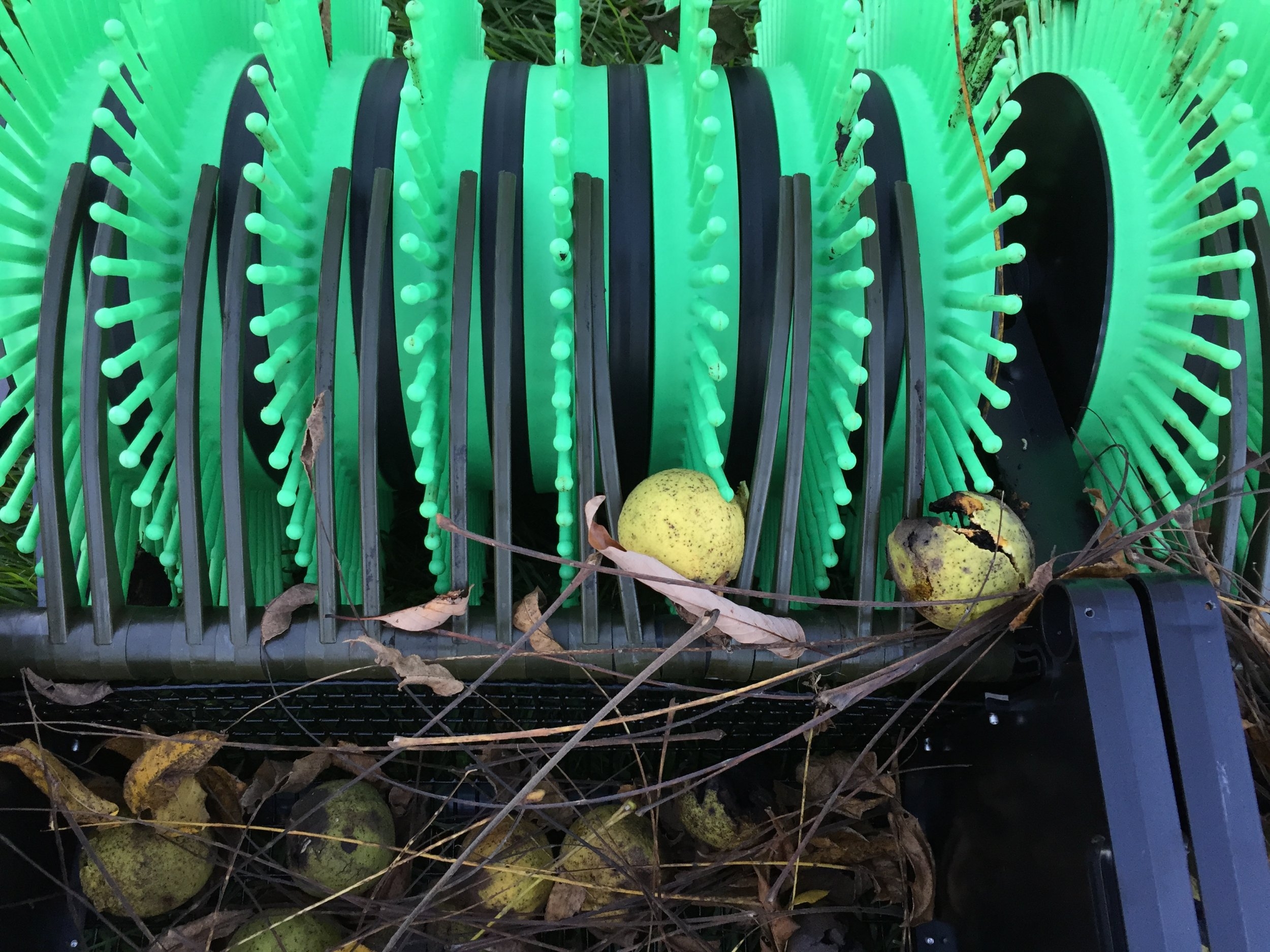

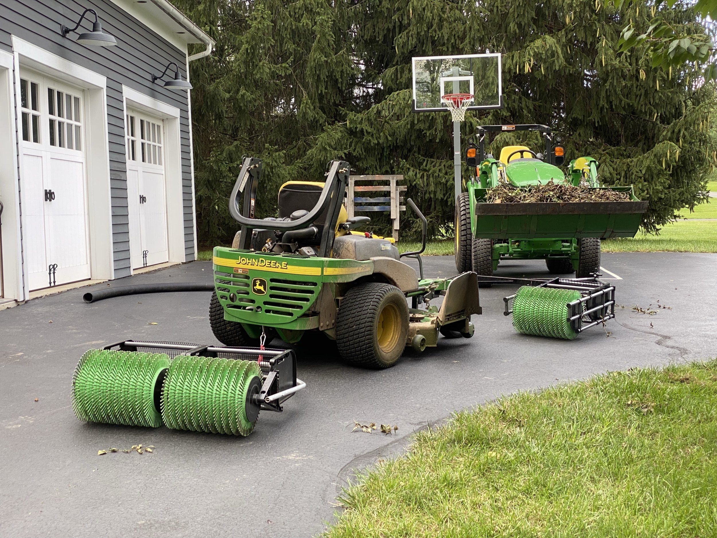

This reminds me of "generation 1" of my walnut picker, which used to attach to the front plow bracket of my Deere 855. Same exact issues with pneumatic castor wheel on the front of that, re-tubbed vs. tubeless.
I could push the picker with the FEL bucket held right above it, such that when the picker baskets were full, I could quickly dump them into the loader bucket. Even had a setup where I could dump the loader down a ravine without removing the walnut picker push frame.
Then I sold that tractor and had to adapt the rig to my zero turn. Works nearly as well, now I just park the 3033R with loader in the middle of the area being harvested, and return to it with the zero turn each time the picker baskets are full. Of course, that loader holds a bit more.
