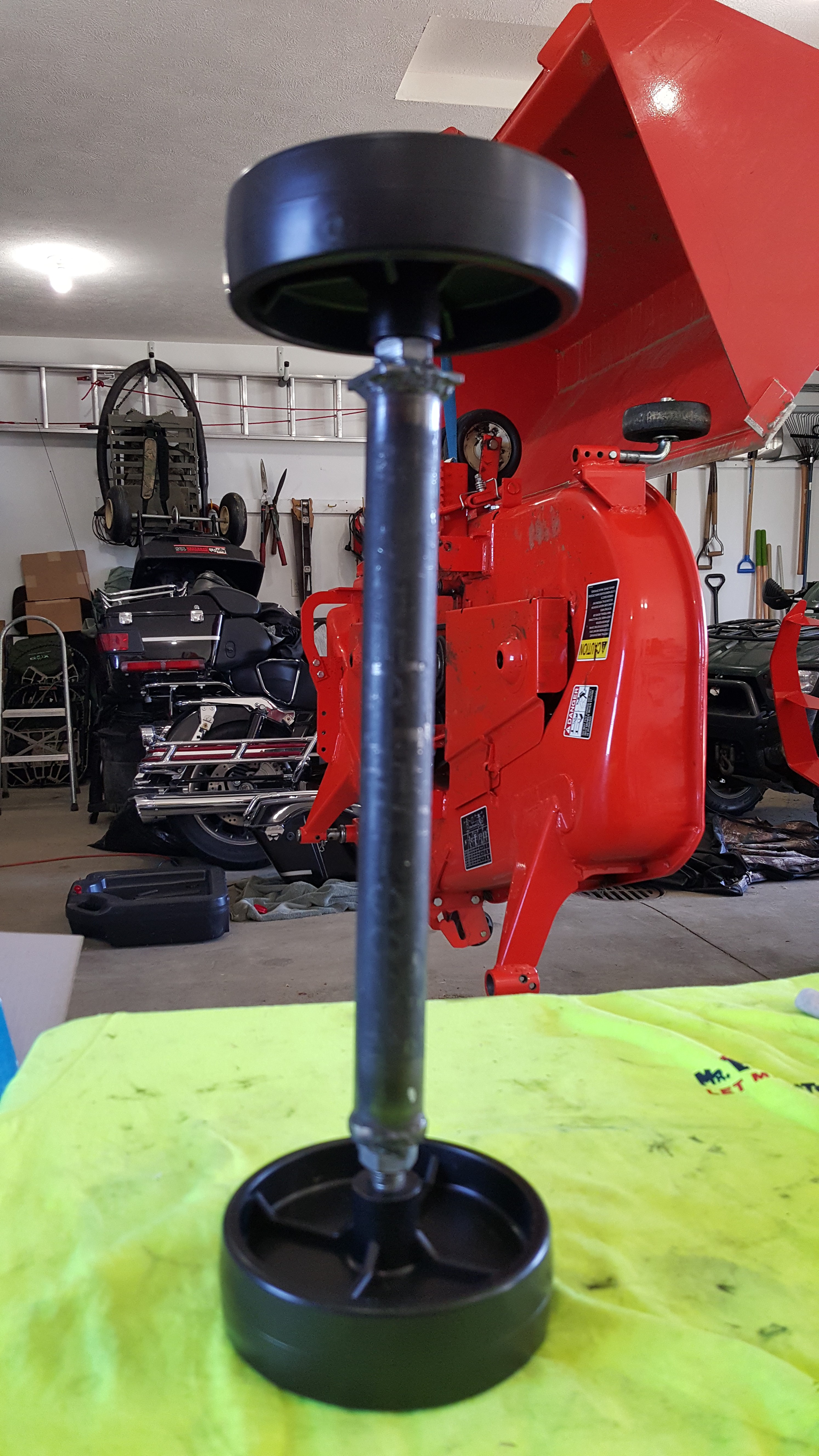

Not sure the deck number, but the ones I made for my 60" deck on from my BX2360 are about 16" long and the hole for the pin is about 4" from the end. Nothing to scientific about it, looked right to me. The short side goes toward the bottom of the deck. I bought some plastic wheels from Surplus Center, drilled and tapped the ends of the axles for a 1/2" shoulder bolt I got from McMaster Carr. In the fall, put on the axles, pressure wash, spray with Fluid film and roll into the back of the shop.

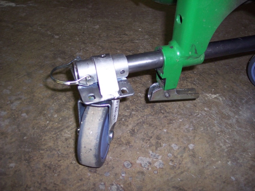

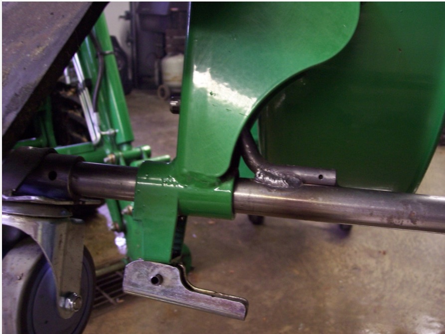

Thanks very much for the response. I'll probably put the hole for the clevis pin around 5 inches from the end since I have 18-inch axles. I'm using stem casters for wheels. It should look like this one on a JD deck. Mower Deck Caster Wheels.jpg

Keep in mind, with swivel casters, the load center changes as they rotate. Look at the JD deck you pictured. If you try to pull that deck away from the wall, or toward the top of the deck, the swivel will turn and the wheel will be too far under the deck. High risk of tipping it over.

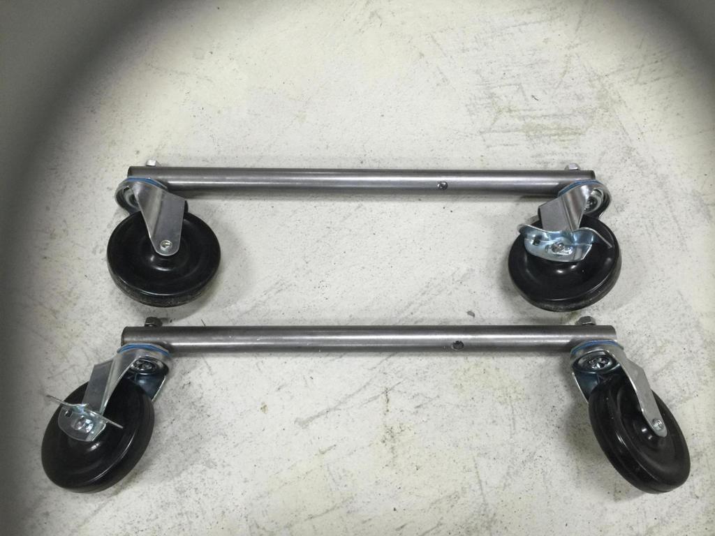

Excuse the crappy picture and shoddy workmanship, but here's an example of what I mean. If I pull too hard on the top edge of my deck I risk tipping this over. I am used to it so know how to handle it. I certainly wouldn't want my casters any further under the deck. The stems of my swivel casters are 14" apart. The centers of my rigid casters are 16" apart.

I used 18" axles too for my 72" deck. It's very stable at least on a concrete floor.
I did later add an indexing pin to the axle to keep it from rotating even the slightest amount in an effort to make the casters swivel smoothly. Used 4" casters and 10"wheels on the fixed axle. Caster mount.jpganti rotation .jpg

yes. mine are drilled at 6.5" on 18" axles and the RCK54-23BX deck is stable on them.
no casters since i wanted them to be simple and tool-less. the hard wheels skid laterally well enough when i need move it twice a year.

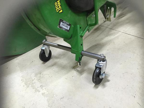

Thanks very much for the response. I'll probably put the hole for the clevis pin around 5 inches from the end since I have 18-inch axles. I'm using stem casters for wheels. It should look like this one on a JD deck.View attachment 531043
Does anyone know if the gauge height pin is at the same angle on the 60D deck (in the picture) as the caster stems? It is not at the same angle on the 60HC and I have spent tons of time trying to figure the angle to drill the gauge height pin hole in relation to the caster stem.:confused2: This project has stumped many a local machinist too.
