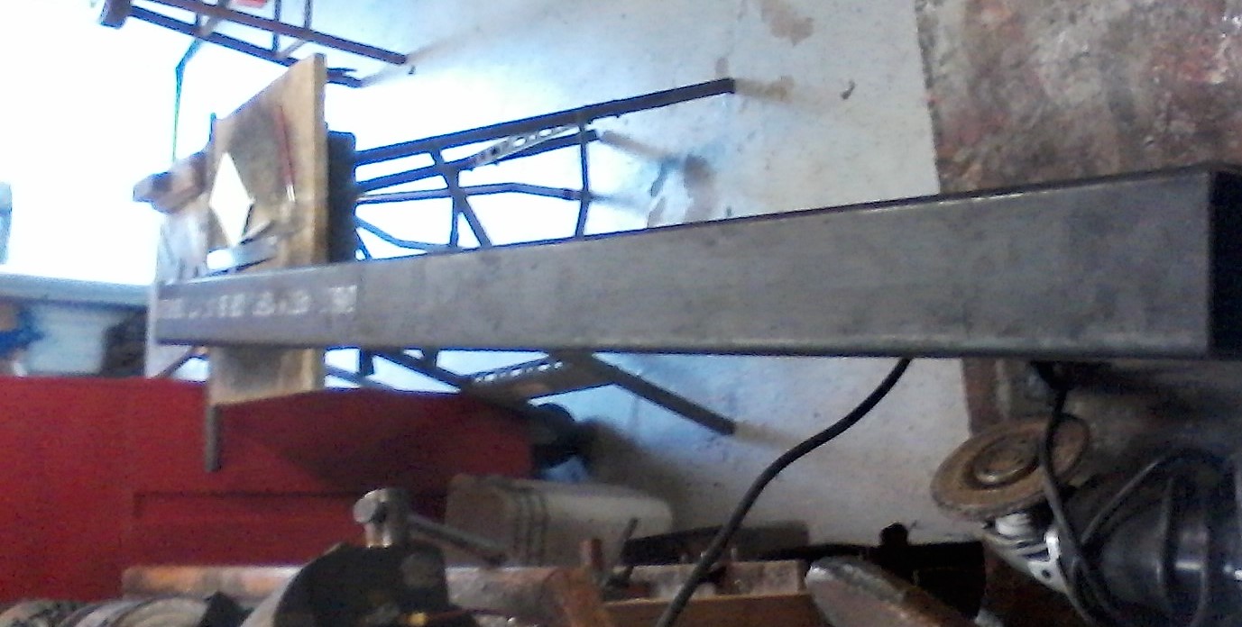

So far -the only things purchased was a 4"x 4" x 72" square tube that will split to be used for the uprights and a 2 foot section of 7/8s round stock for the pins.

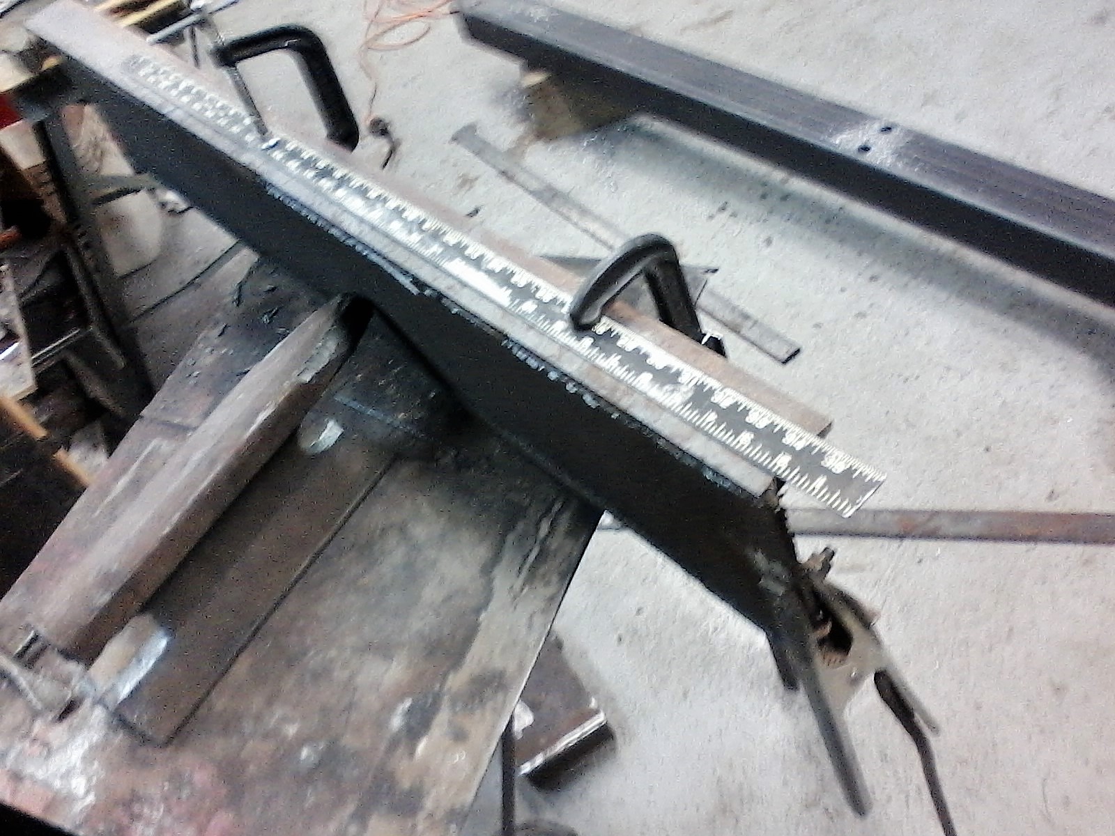

Thicker walled steel for the uprights would have been preferable, but the only square tubing that the local Pacific steel carries is only .188 walled and they didn't have C channel with the right dimensions either, so the 4x4 is what i ended up with to be split for the uprights.
It does (appear) to resemble what the HF 20 ton presses uprights are built from- but we don't have a store in town to measure them from and the info does not show up in their manuals either so it is what it is...

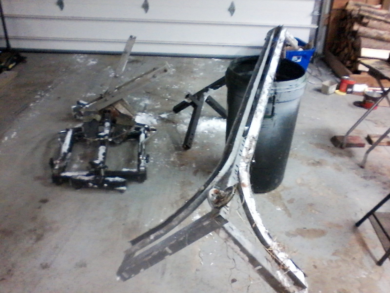

parts off junk garage door rails -plan on adding a hand winch to lift the aprons will salvage the cable pulleys, also need the springs to retract the hydraulic jack
old boat winch, will use to lift the aprons
part of a weight bench square tubing frame- think this will work for part of the base for the jack and guide between the uprights

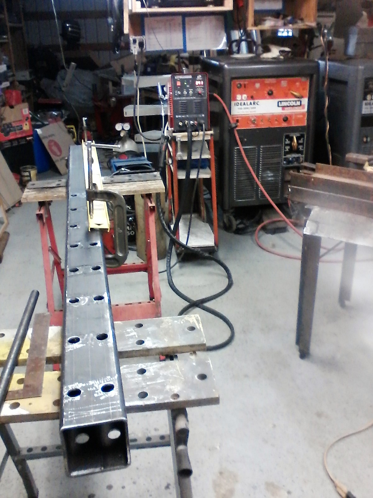

12* in the shop when I laid out the 7/8" holes for the pins and scribed the lines to split the 4x4 in two.
Had warmed up to 26 when the hole drilling was done- Man drilling 32 holes in a row by hand is a work out:D

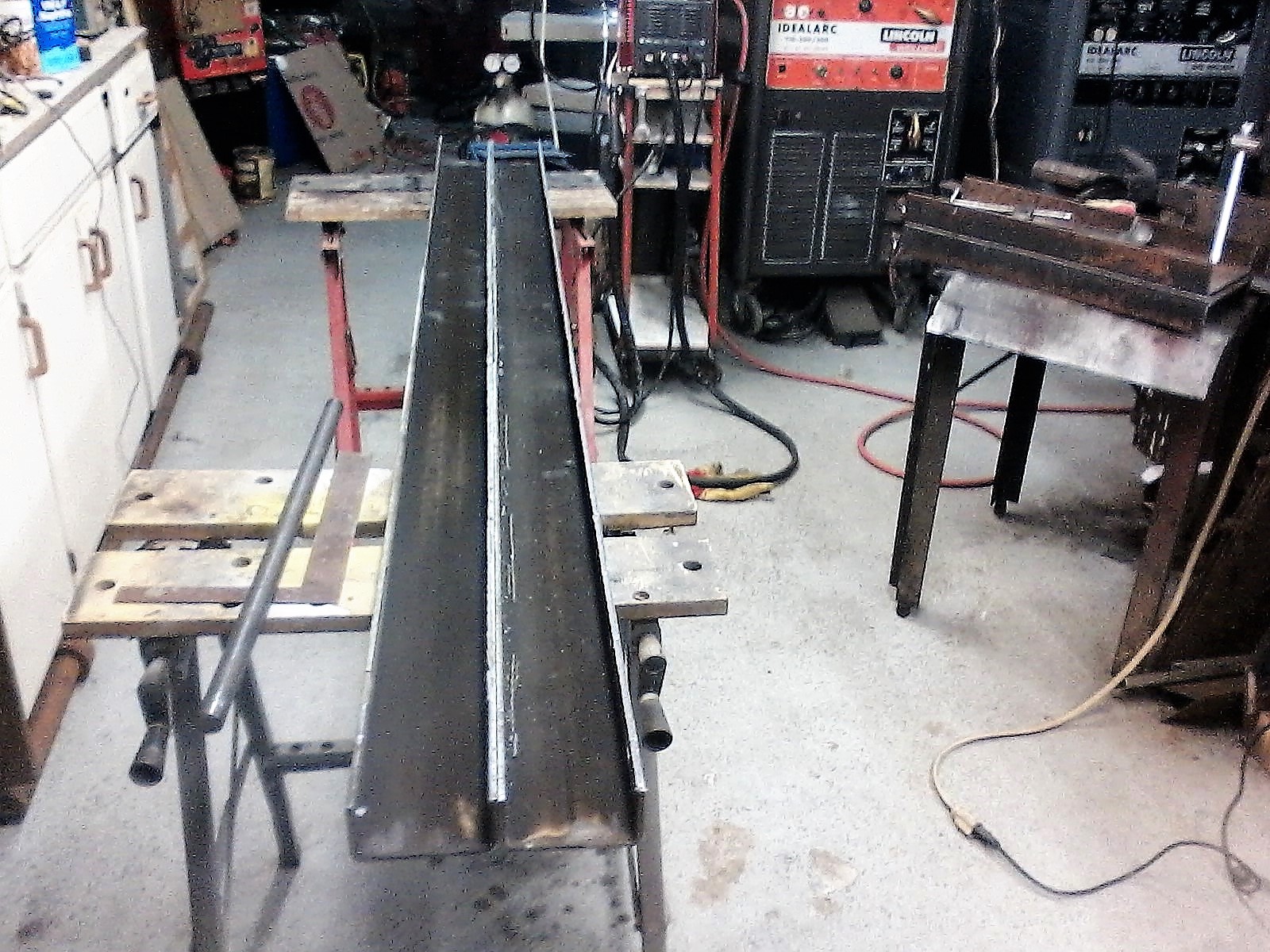

press build 3.jpg also began plasma cutting by splitting one side off of some of the 4 x 8 C channel and also splitting a 44 inch one in half to be used for front and back top plate pieces.
I beam cut.jpg another little project in that picture- plasma cutting and shaping a piece of railroad rail into a small anvil, it should be handy
I was a bit concerned about firing up the plasma on my 3 in 1 machine in temps this low, but wanted to get going and thought that it might help to turn it on and let it idle for a couple minutes and then set the amps to just above minimum and lightly gouge a couple inches on the scribe line and warm the mosfets up a little bit before cranking it up to cut so that is what i did
press build 1.jpg press build 2.jpg It did a decent job of cutting the 4x4 piece into two but i left the very ends attached hoping to minimize warping, but even after letting it cool down there was some.
Next cut the bed frame rails and drilled holes in the uprights.

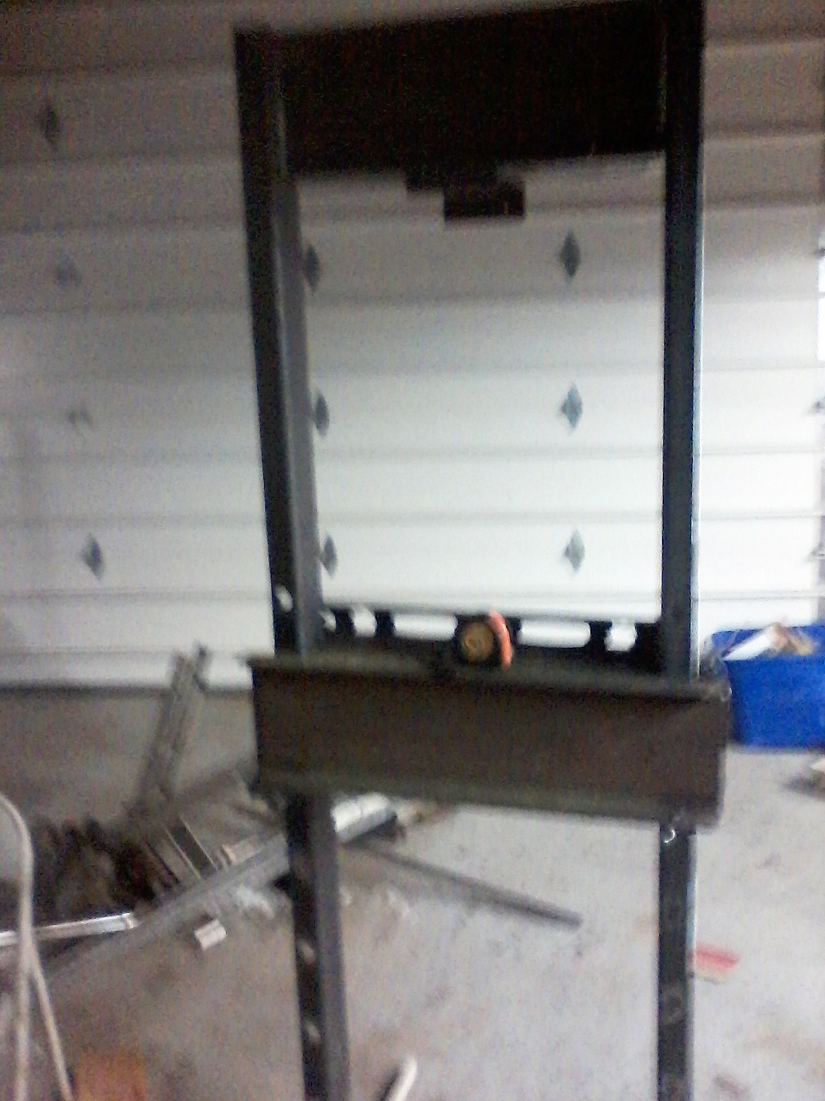

Welded the 2 trimmed 4 x 8 C channel together to form the top press piece with a void in the middle for the jack retract springs. Used 1/8 6011 and did my best to get full penetration in the gap between the 2 top plates added a piece of trimmed channel for where the jack seats on the top frame used 1/8 7018 for those welds.
Squared it up as much as I could ( sure would be nice to have a steel build table) :D -Someday
and welded the uprights to the center piece with more 1/8 7018- also added the (feet) thought i took some pictures but can't find them.

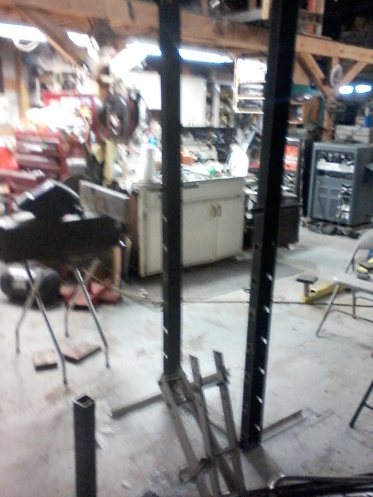

Here's the basic frame standing

I have no idea if Your idea on letting Your plasma cutter " Warm Up " per say really works But I have been doing the same for over 5 years now :rolleyes:
The reason I started doing it is I had a small t.v. in my semi and turned it on one weekend while home . Truck was really cold inside , worked for all about 4 or 5 seconds then all kinds of weird stuff with the screen , picture , even the sound started happening . Took it in the house and let it warm up and tried again . Nothing then , zero , ziltch . Recycled the t.v. but for some unknown flippin' reason , I had saved the remote and just recently found it when I traded in that old truck for a newer one :confused3:

Not sure how much it helps but don't think it will hurt, years ago worked on an oil exploration crew in the recording dog house, and we weren't allowed to start up the electronics equipment until the temp reached 55*
But that was so long ago the system used reel to reel magnetic tape to record digital data:laughing:
