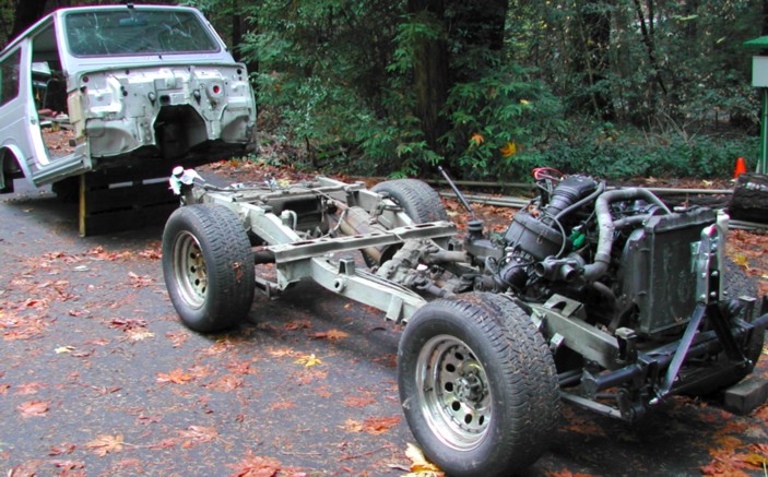

I am working on a Sammy, too, with the idea of making a nice
utility vehicle with hyd dump and 4WD. I do wish I had the AT
instead of the 5sp. I can get multiple 86-89 vehicles here for
$500 each.
Questions: Why do you want to narrow the wheel track (axle width)?
What is wrong with using the existing 1.3 liter gas motor?

While the sammy is not a large vhic, it is still a bit wide compaired to a compact tractor. I need something that can get down fence lines and buildings in the city (5').
I guess there is nothing wrong with the 1.3, I just wanted diesel, better low end power and safer than gas.:)

I snuck in a little time on the project after work tonight.
Heres the rear axle apart. Needs to be shortened 8-5/8".
Here the axle tube is cut and the bearing housing retainer is trimed off. Notice the piece of tube inside the retainer ( lower right), I just pop it out and press the housing on the cleaned up tube end.
The bearing housing on the shortened tube. I've checked "caster" and camber, I still need to check toe then weld it up.

I find the Suzuki to have very similar track and wheelbase to my 2
compact tractors. Indeed the super-short wheelbase of only 72" is
one of the reasons these vehicles are so prone to rollover on the
hwy. I see that the folks who modify these to make "rock-crawlers"
out of them like to eliminate any anti-sway bars to increase suspension
travel. This exacerbates the rollover tendency.
Since you want to make a tractor out of the Suzuki, are you going
to eliminate the suspension? If so, you will want to incorporate a
front axle center frame pivot.

That is my plan.
Any idea how much front pivot " swing" there should be?
Say, I notice in your PP there is a pic of a Backhoe mounted PHD.
It looks like the PHD is powered from the bucket cyl hyd's?
Does it use the same control valve also?

How much swing? I have not measured it, but it is prob 2" of
swing at 12" from center. There will need to be a firm stop for
the frame to rest when the axle is firmly pivoted to full swing.
Yes, my hyd PHD is a Worksaver 714H unit, adapted to my hoe,
using the curl circuit for the hyd motor. Works great.
4-wheel steer is a cool idea. I would love to try it some day.
It would work well for a low speed tractor, but poorly at higher
speeds unless Rears turn only a few degrees.
