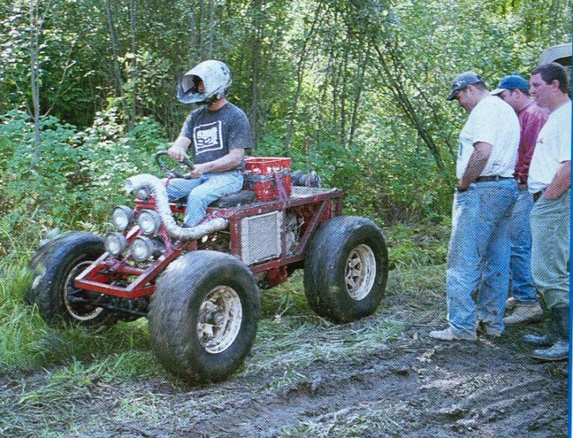

I built a tractor / mud buggy this way using a Honda Civic motor with the auto trans (welded diff) and a set of full size chevy diffs (also welded) but I offset both pinions to the right. Loads of torque and a top speed of 30 MPH.. works awesome.

/ DIY Home built compact tractor #333
That thing is cool! Now you need a captains chair from a conversion van, some cup holders, and a rear facing bench seat for passengers. :D
/ DIY Home built compact tractor #335
Neat toy, but still tryin to figure out the helmet! LOL
