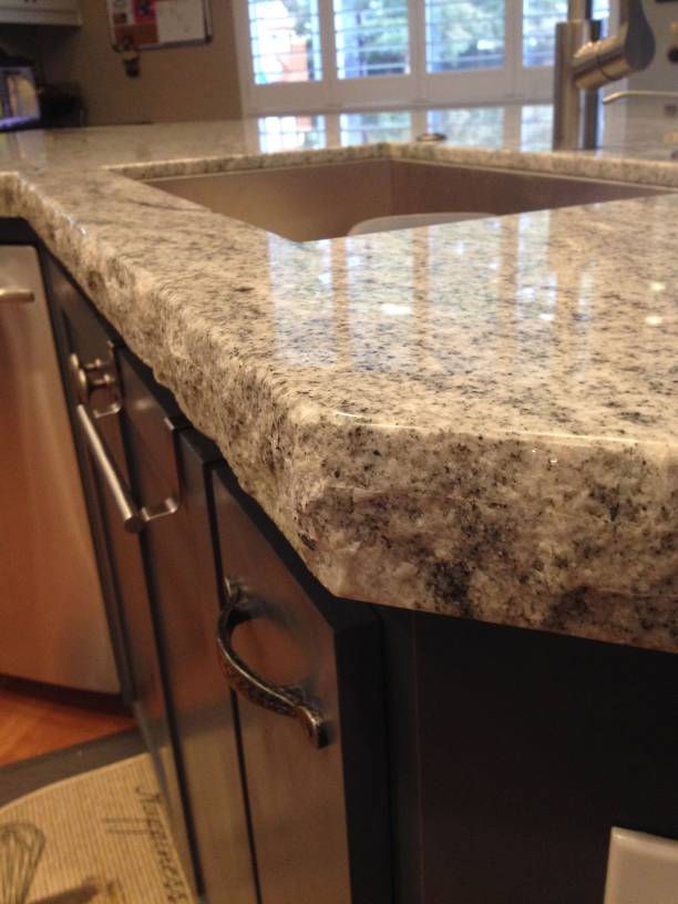

The live edge seems like a cleaning nightmare and even worse for sanitation.
I guess sanitation might be a problem for a messy person whom eats off the edge of their counter top, or a clean freak that can't seem to get anything clean enough.
But for average people whom eat in public places and/or people whom clean up after themselves, I can't see where it would be much of a problem.
Touching your mouth, rubbing your eyes, touching your nose, would be a bigger sanitation problem.

I don’t disagree but why make something needlessly worse? I don’t like the looks anyway.
/ DIY Granite countertop? #24
Yes, when I first saw it in my friends house, I did not like it and I wondered why they cut corners or tried to save money. But, in less that 10 minutes I began to like it. I liked it enough to ask my better half if she might want to do that in our house.
