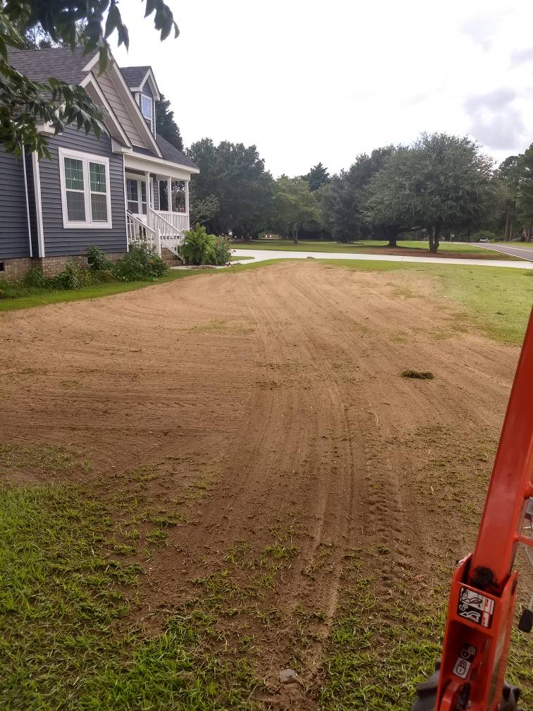

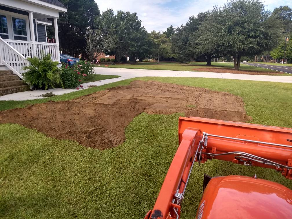

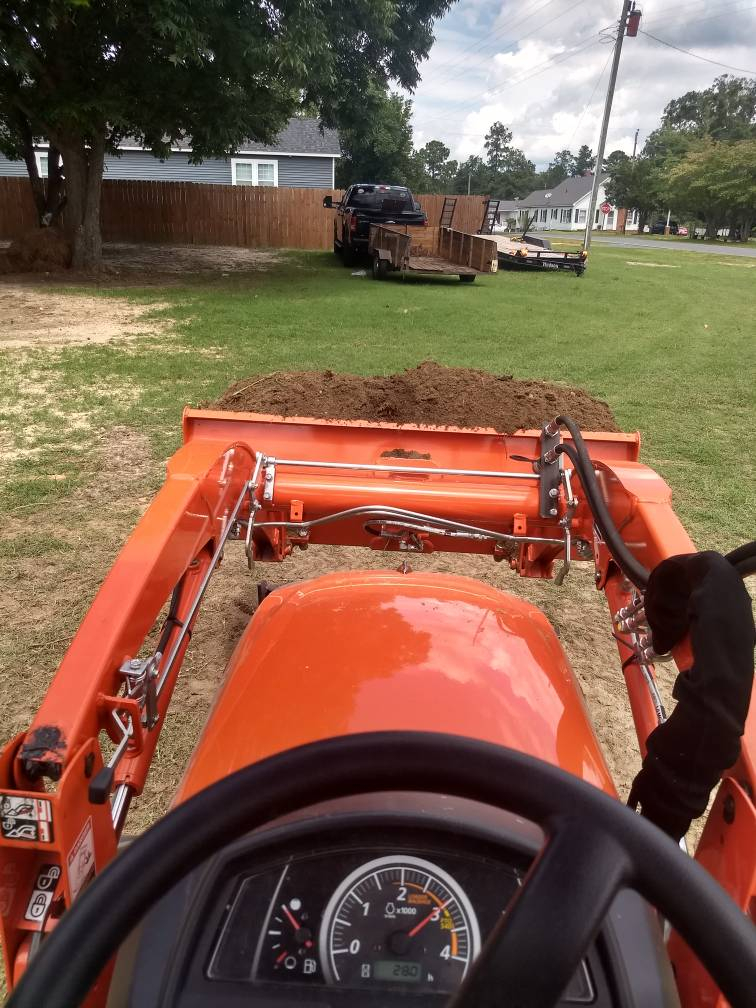

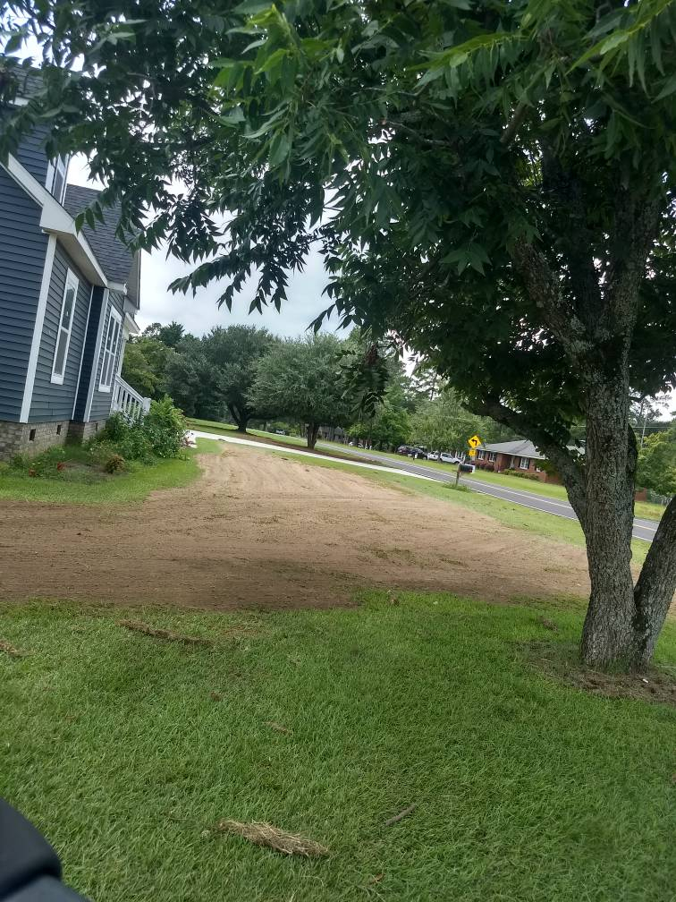

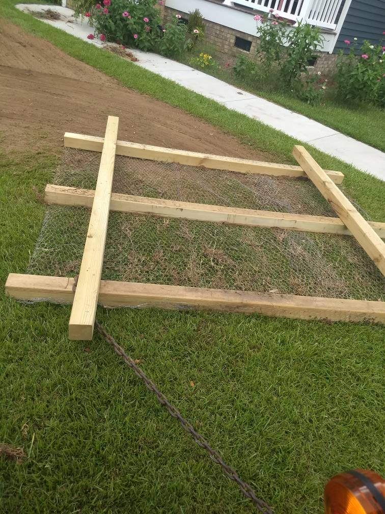

Okay, by no means is this really worthy of a "do it yourself". I'm aware all I did was pop a few screws and attach a chain. BUT. I had been doing some grading and felt I was at a point where I had done all I could do with the tractor, and I needed a drag or to start working it by hand.
Well, I have this old tractor tire I will flip for exercise, and some old treated 4x4x8 posts, so I put this together with a chain and drug it around and it actually worked really well!
I needed to throw something together with what I had on hand. First I tried to just screw one 4x4x8 to my (~30') chain with a long length behind the post but it didn't do much. This actually works! By no means did it eliminate all hand raking but it made it minimal.
/ Diy drag #2
Nice work! The only problem I see; you can't back it up. :ROFLMAO:
/ Diy drag
I definitely can't back it up. Haha. I was very careful with my lines and a time or 3 I had to get out and man handle it over one way or the other.
I can lift or lower the 3ph though depending on the situation to adjust the aggressiveness of that front 4x4.
I would like to pair this with a boom pole to lift the back and then I might really be able to back up.

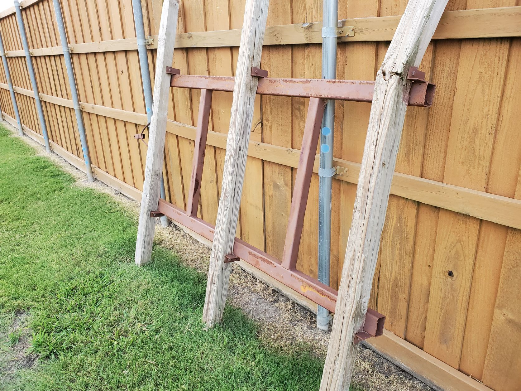

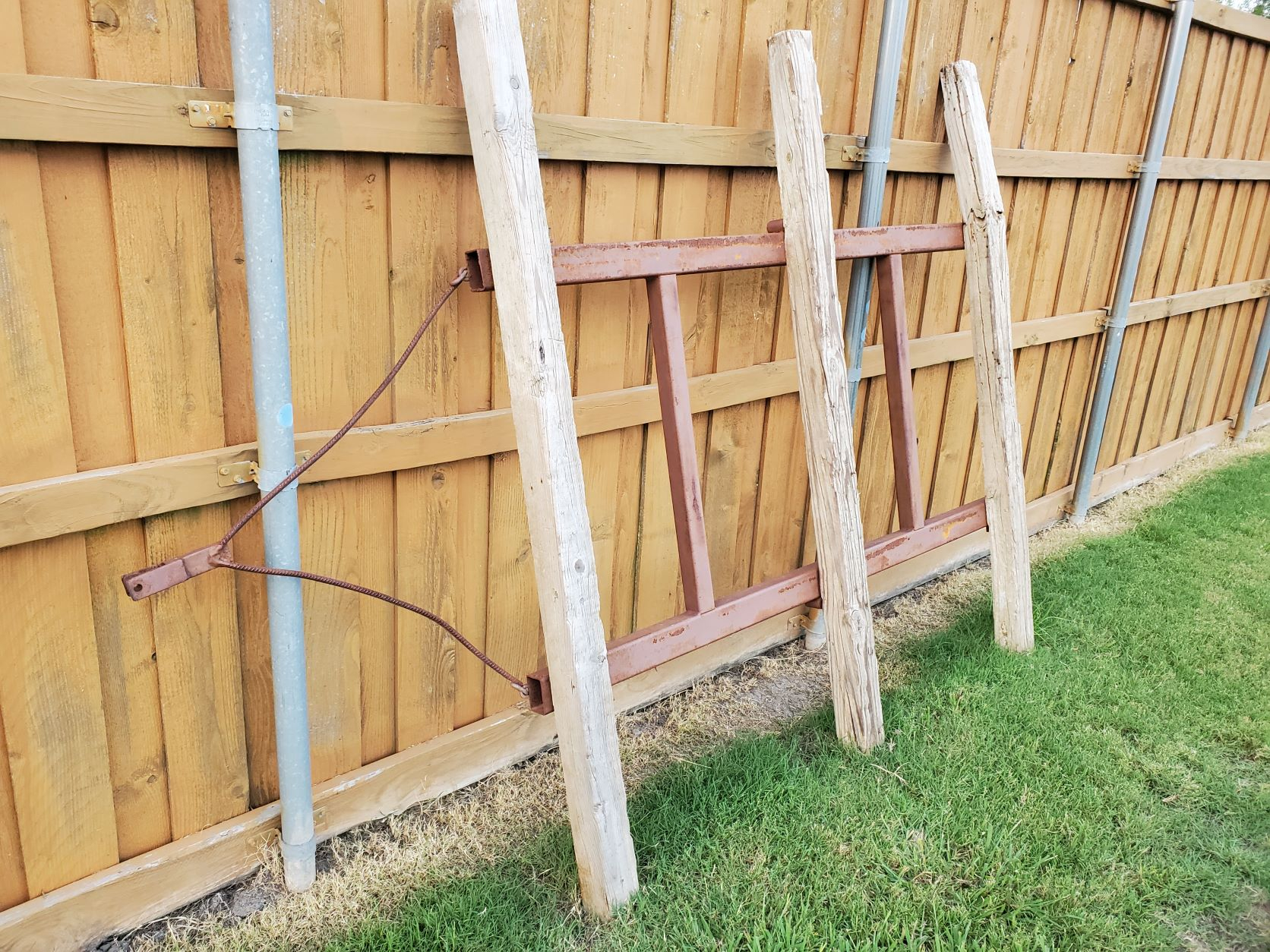

Here's one I made years ago out of scrap I had.
I just bought some Rough sawn oak 4x4's last week in MO. to replace the old treated pine ones that are cracked, broken and worn out. It has provisions to add some weights to it, although these new oak posts are so heavy, probably won't need to use any.
I'll have to take another picture this weekend of it in use when I replace the 4x4's

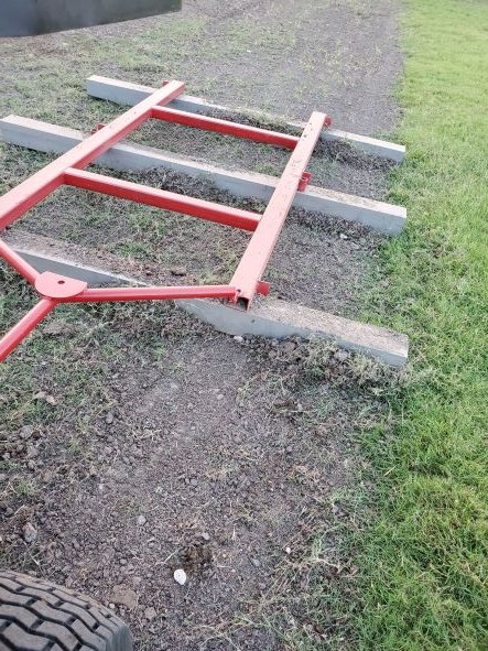

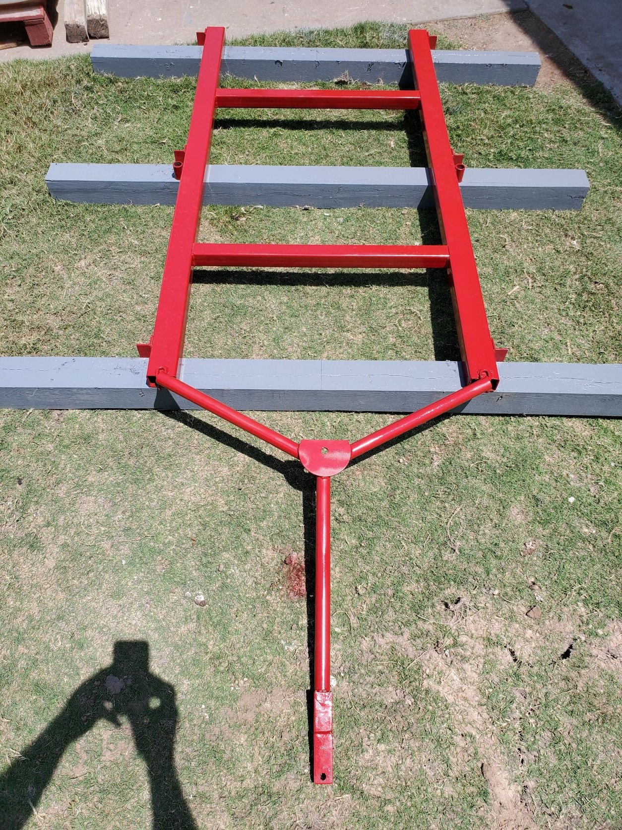

/ Diy drag #12
Here it is as Rev2. Upgraded the hitch so it can be backed up and near 90 degree turns can be made without hitting the wheel of the JD or ATV.

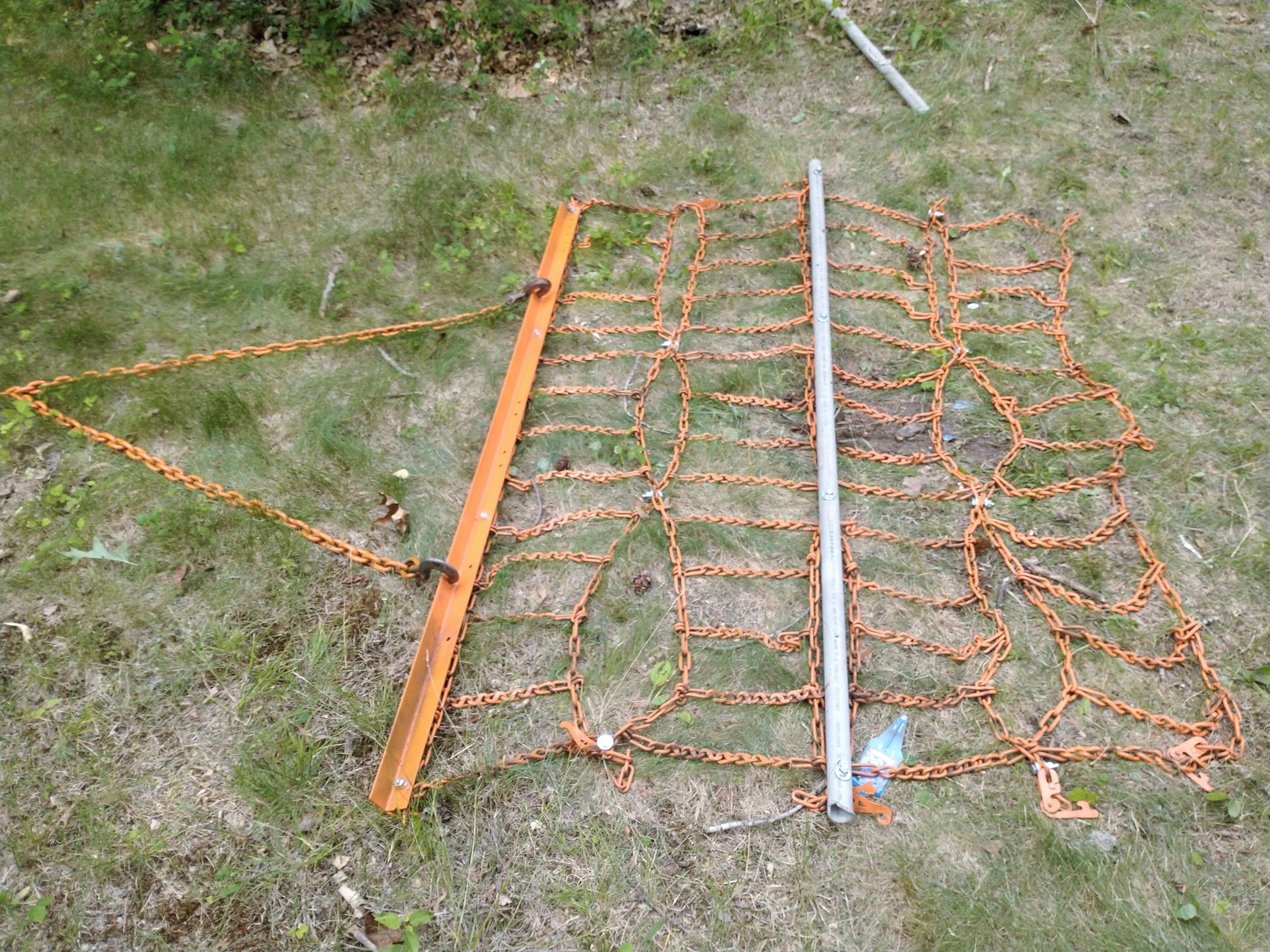

Here's one I made to lightly drag soil over seed that needs a shallow cover. Angle iron, old tire chains and a piece of PVC pipe.
