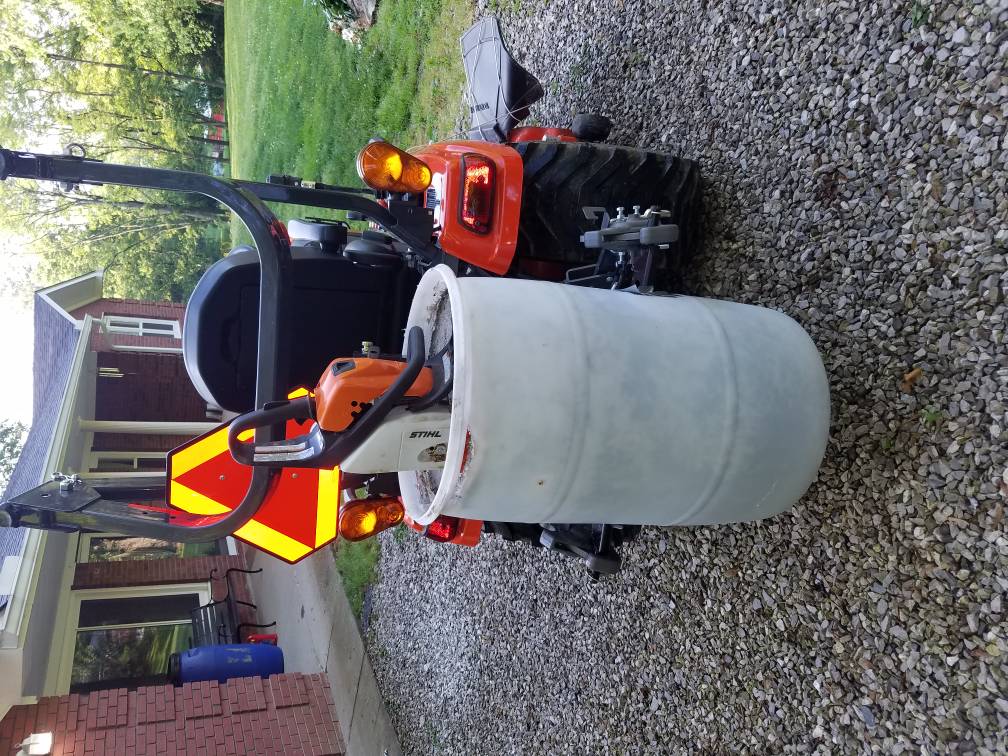

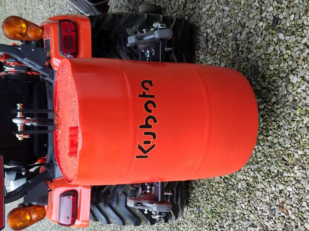

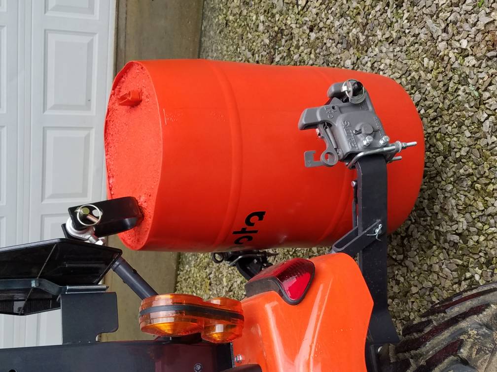

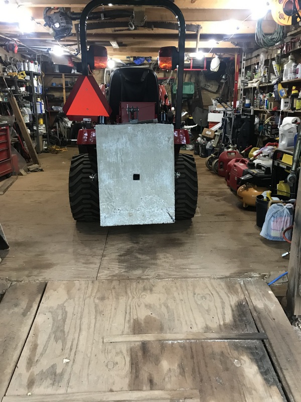

I did make it heavier than i had needed or planned. But, it's not past it's limit, and feels great when it's back there. Very easy to hook up and move around.
Nice job but ~600# on the back to counter act ~600# on the front seems to be a lot of extra weight to be carrying around on a subcompact.
/ DIY counter weight #23
Nahh... CB65 backhoe is 600+ lbs. These GCs have practically the highest loader lift capacity of all subcompacts. They'll take 500-600lbs ballast all day

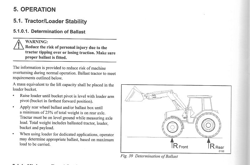

This is what came out of my MF GC 1715 manual.... IT sort of vague but if you can fined the numbers, it can be determined how much ballast is desirable...

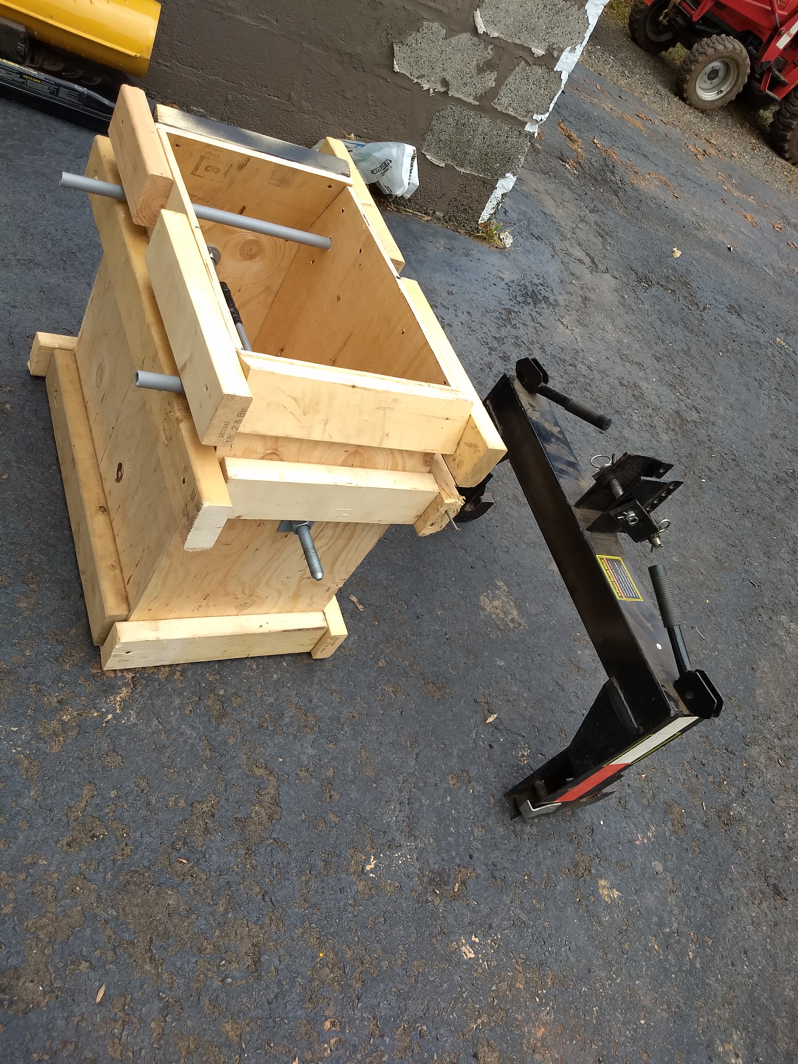

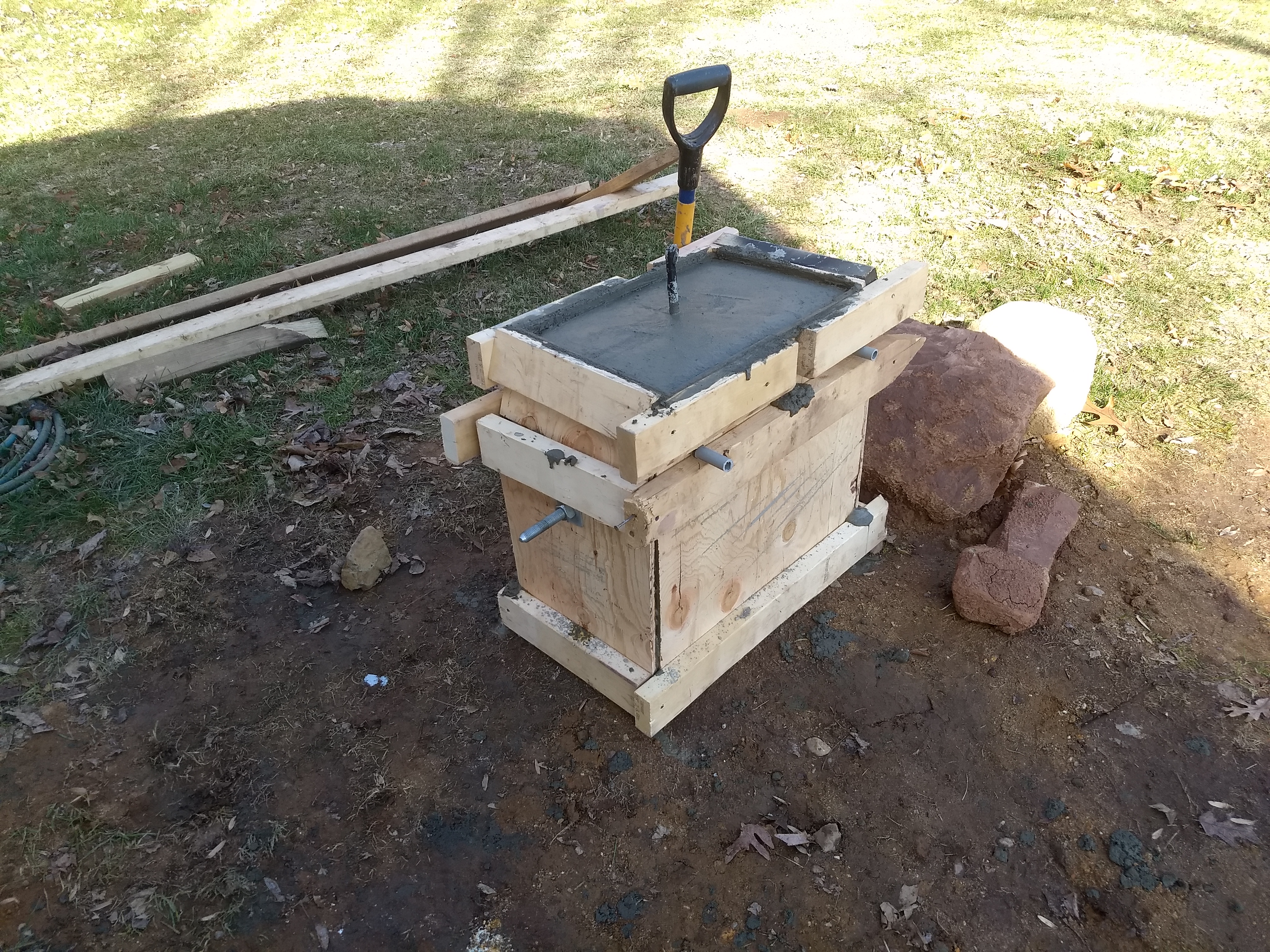

Some thoughts ...
Make sure design will hook up and unhook up from 3 PH (or quick hitch) with ease ...
Make it capable of carrying some tools, like tubes set in the concrete for shovels and rakes or hoes...
Be sure you can set it on ground without using any blocks for height (my mistake) ...
Also think about some sort of rear "hitch" so you can drag harrows or tow trailer or whatever... Maybe even lifting loop on top incase if falls over or you need to lift it for some reason where 3PH won't work for you...
Dale

Interesting. Though that blurb in not in my 2009 GC2600 manual I wonder if anyone here with a Massey subcompact has actually used this method under max capacity.
/ DIY counter weight #34
I think almost no one has the capability to check their axle weight so that guidance is of limited value. John Deere provides actual weight recommendations for specific tractors.

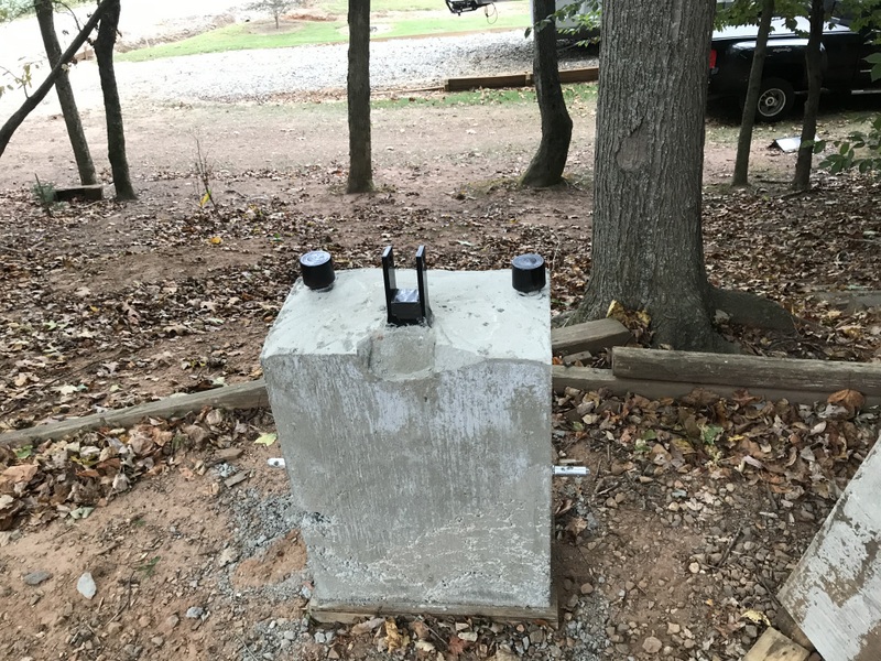

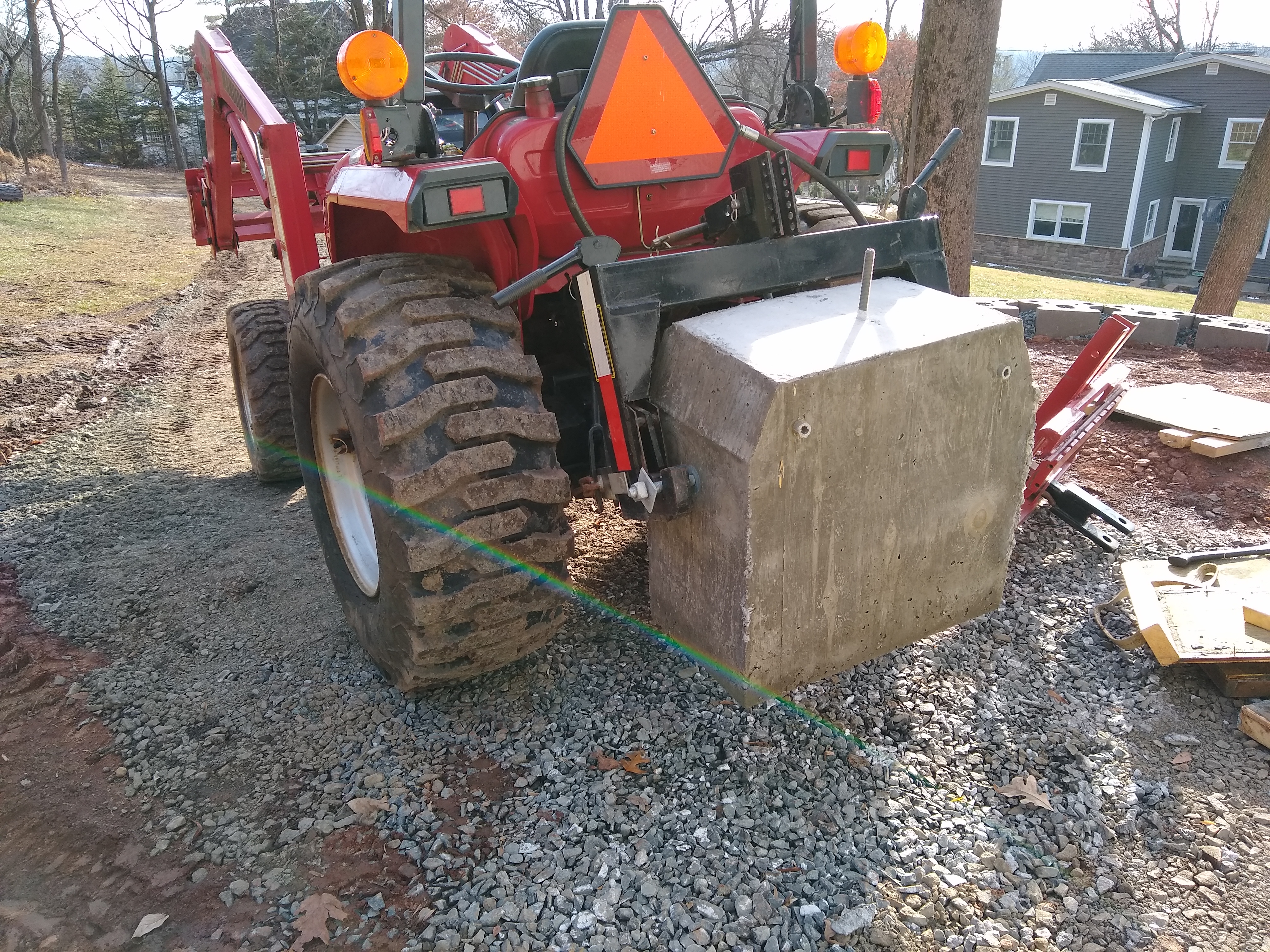

Since I have a quick hitch and a 2 inch square receiver attachment for the quick hitch, it was easy to build a concrete counterweight. I just imbedded a 2 inch square tube with some rebar in a form and poured a convenient size block. It's really easy to take on and off.

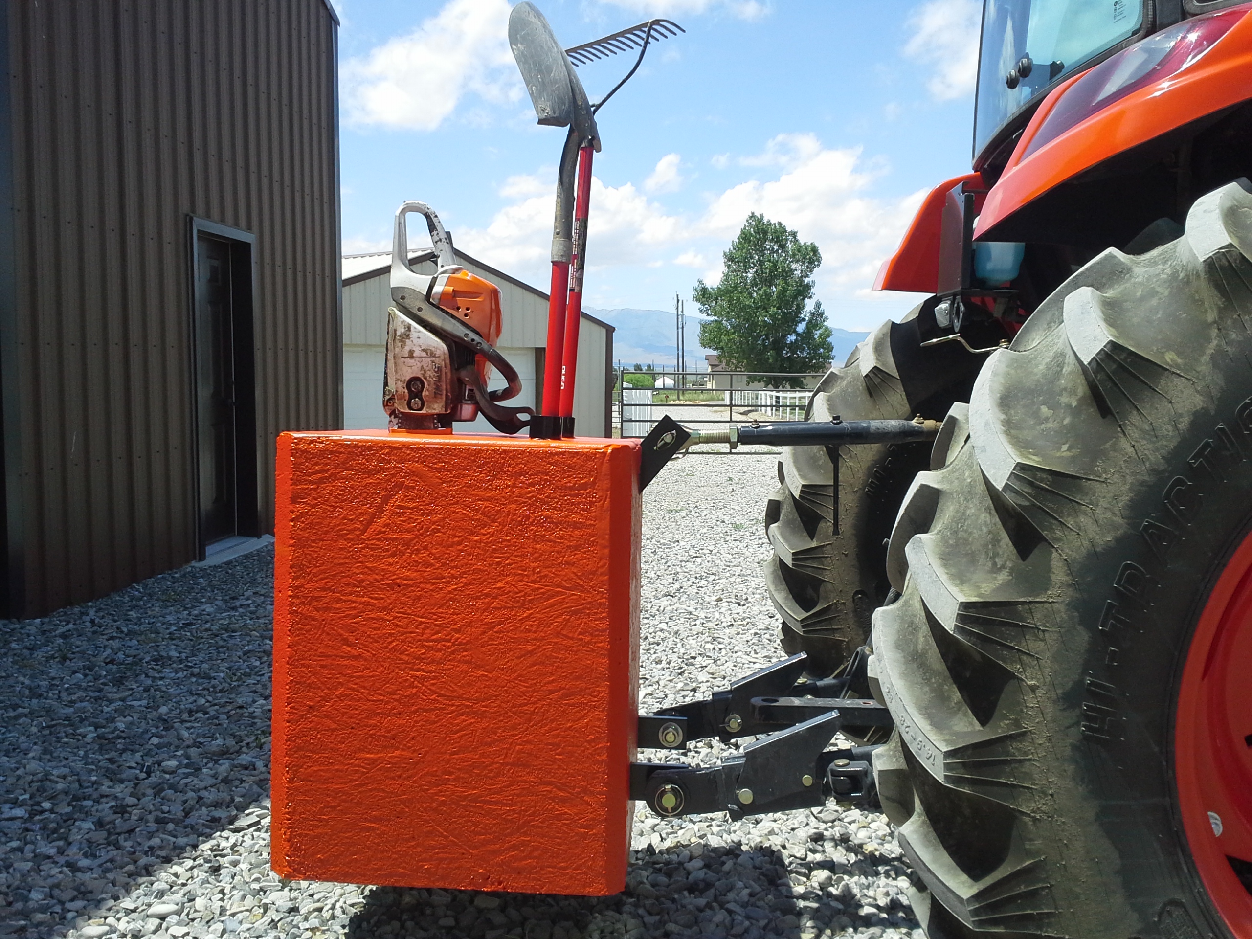

This is what I use for ballast;
my home made weight box, approx.. 600 pounds,
or my Frontier 48" Box Blade (BB2048L), 275 pounds.

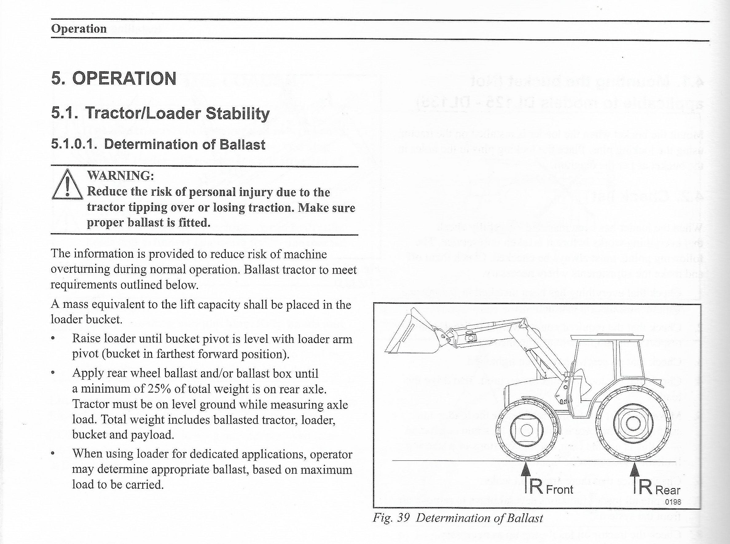

My 2009 MF DL100 Manual, has the same information as your manual, but it also has additional specific information on page 26 shown below:
It states a minimum weight of 280 pounds.

What I did was not having weight of FEL, I guesses it at 800 pounds...SO 1340 for bare tractor, plus 800 for FEL and plus 850 pounds lift capacity.... And then dividing by 4 to get 25%...
1350 + 800 + 850 = 2950 / 4 = 737 pounds (or 25%)
So at 600 pounds (+/-) I think I am in safe range...
