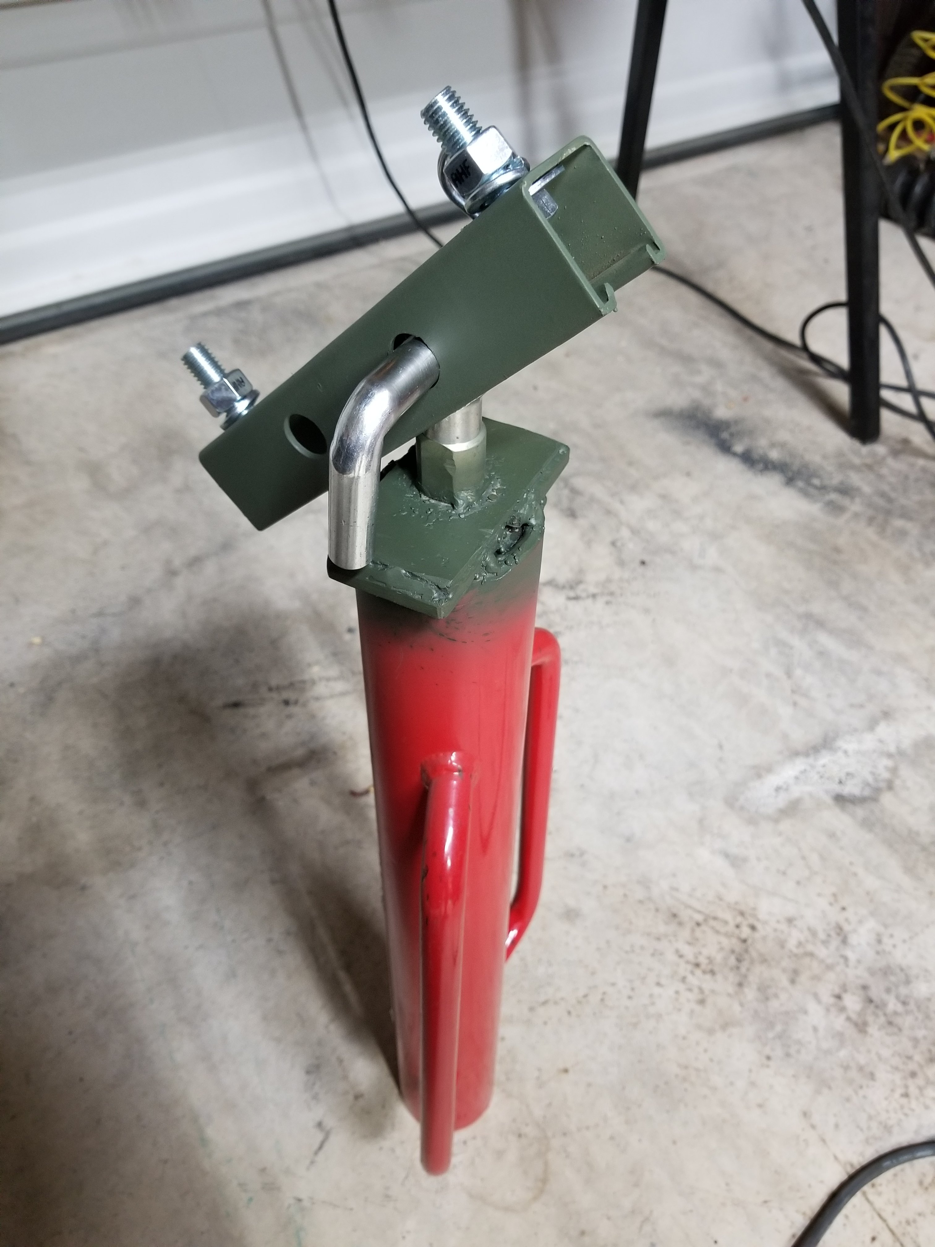

I know there's a guy who makes these in OK but It looks far too simple to spend $150 on one when I can do it for under $50 myself.

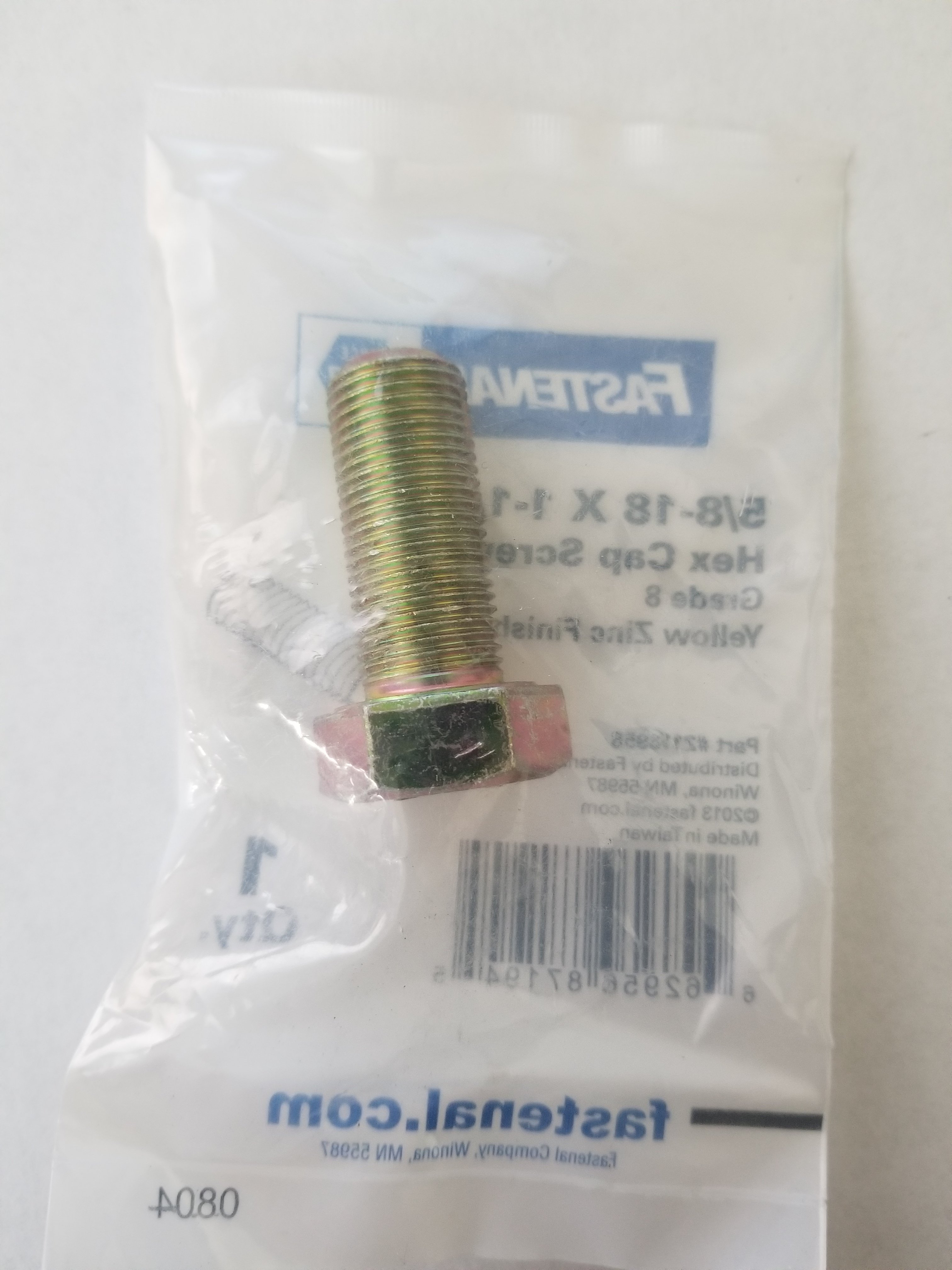

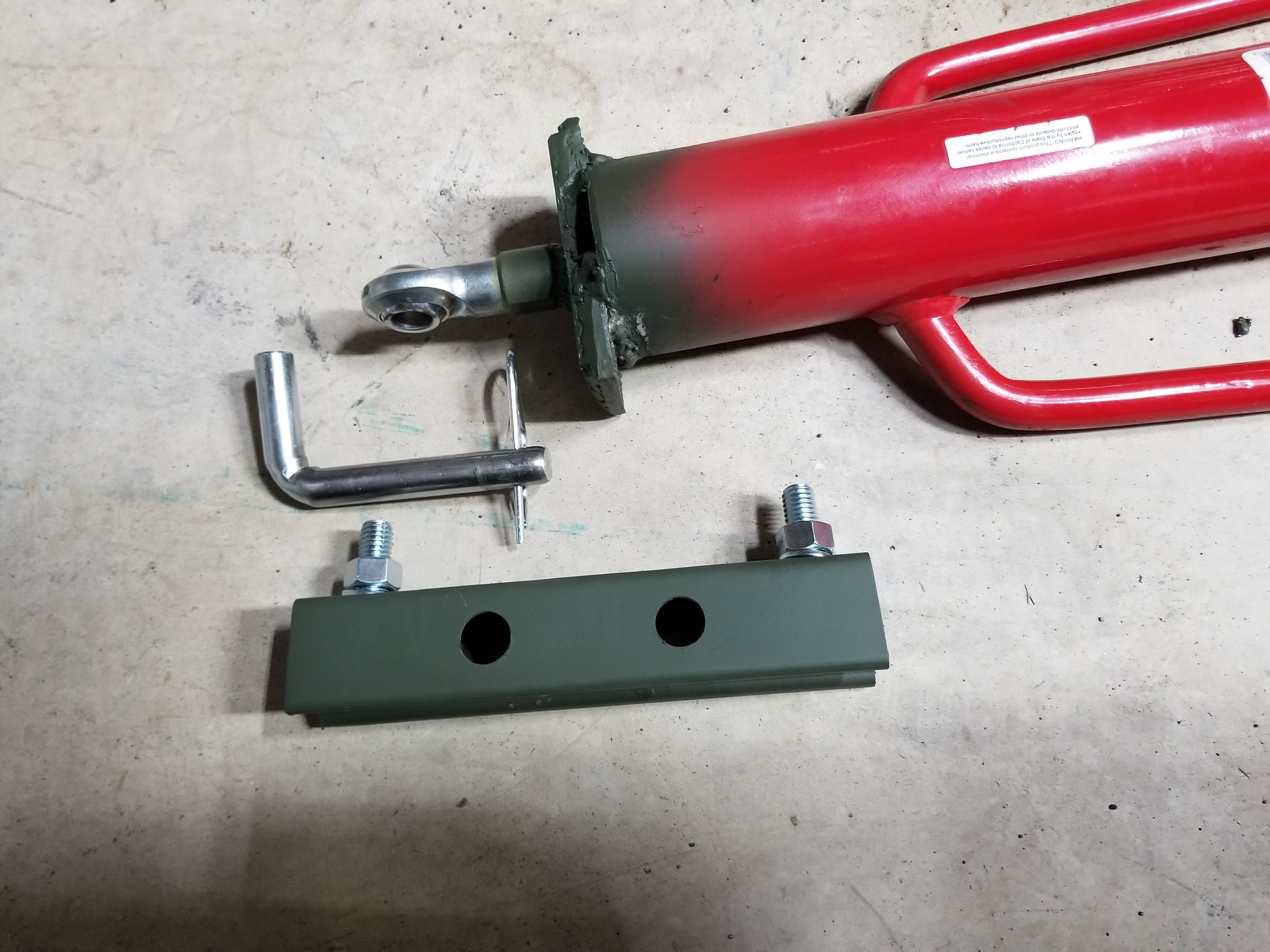

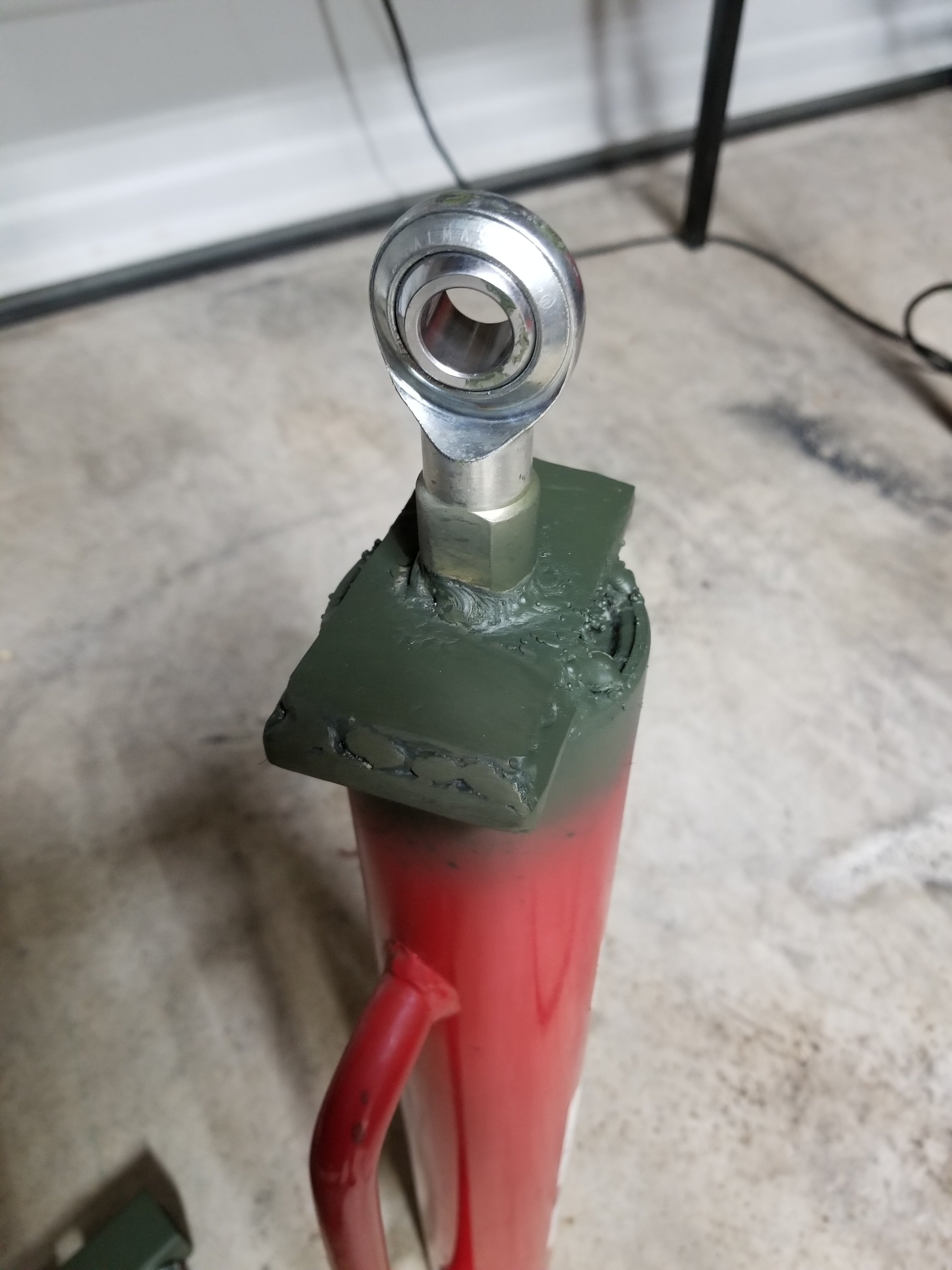

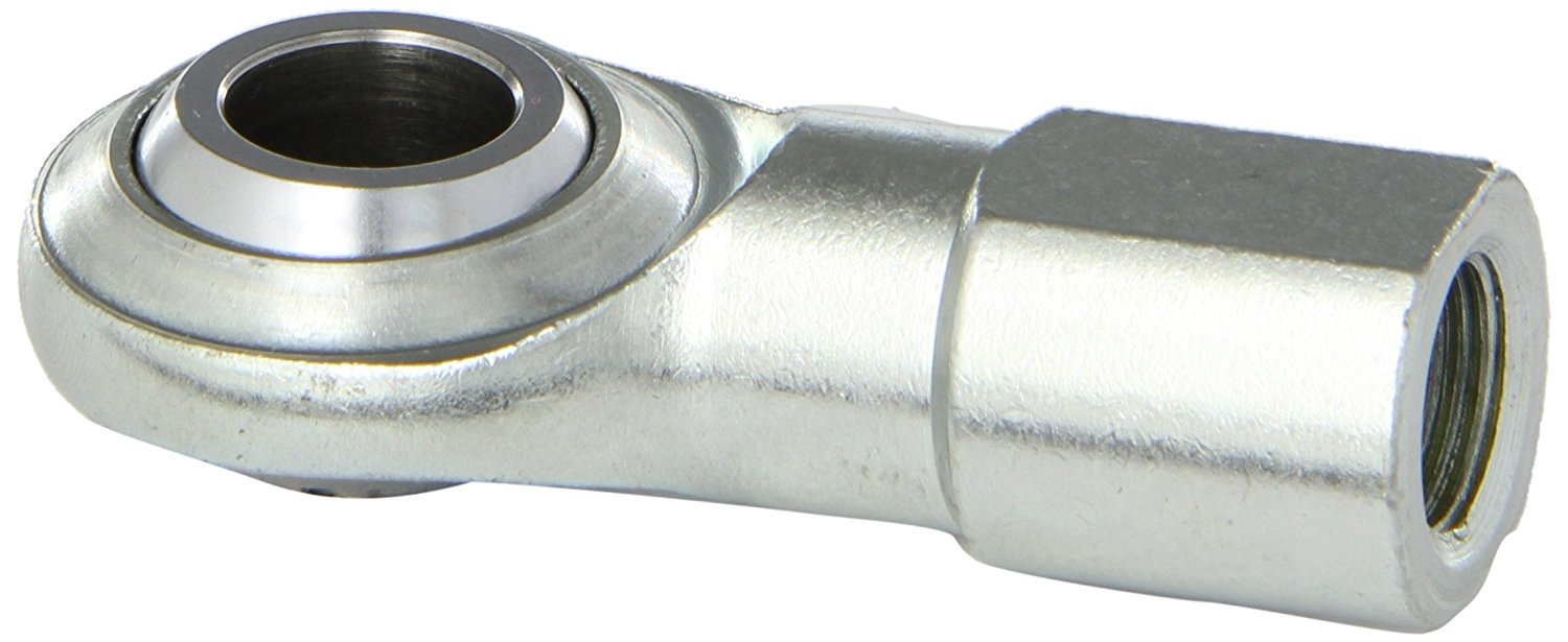

I bought a 16 lb T post driver and had a 5/8" receiver pin handy. Some 2" x 1/4" flat steel and a piece of strut channel was laying around. I had to buy the rod-end bearing, a bolt to fit it and two 1/2" bolts with washers and nuts.

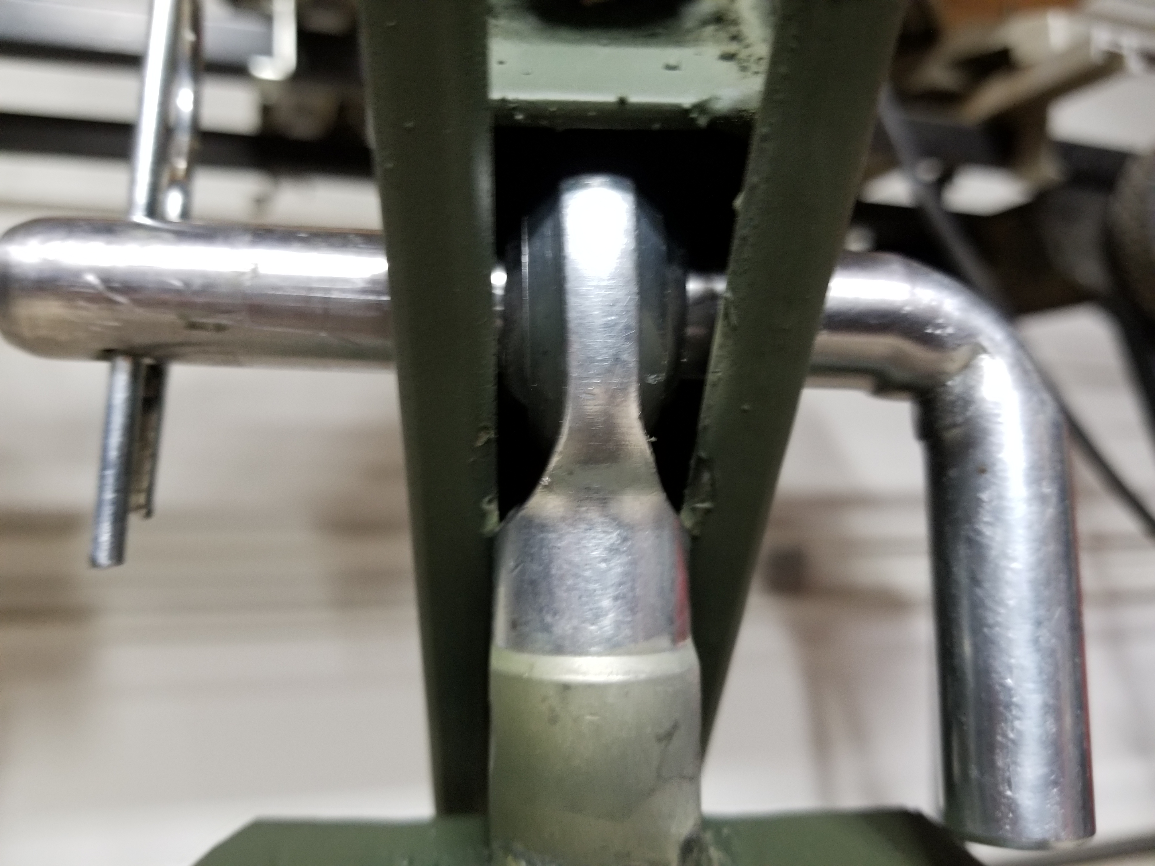

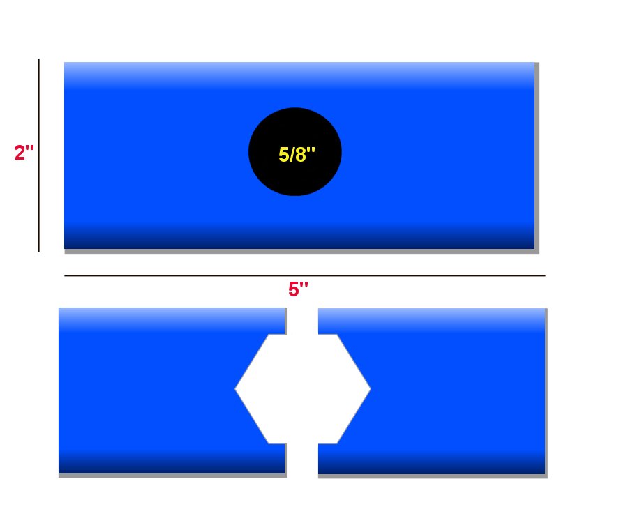

I cut three pieces of the 2" stock and center drilled the 5" piece to receive the bolt for the rod-end. I bolted the rod-end to this steel then notched the other two pieces of steel to fit around the hex head. The thickness was needed to clear the bolt head on top of the post driver. I welded the rod-end to the plate as well. The bolt was to add strength to the rod-end to be sure it didn't collapse. I ground off the powder coating from the post driver and welded this to the top. The rod-end is rated for 10,000 lbs. I took a piece of strut channel and drilled two sets of holes through the sides to put the hitch pin through. I then added two gussets to be sure the strut channel doesn't fold or collapse. The second hole in the strut was for a long carriage bolt where I will attach a length of chain with a steel plate at the other end to mark the T Post depth. I'll have an updated photo of that once the paint dries. The strut will mount to the under-side of the bucket with two drilled 1/2" holes, the driver will suspend from the strut channel using the hitch pin. I'm quite certain this will be more than adequate for driving 300 posts. I will try and get a video if us in action when this does take place.
I know, my welding leaves a lot to be desired... I'm still learning!

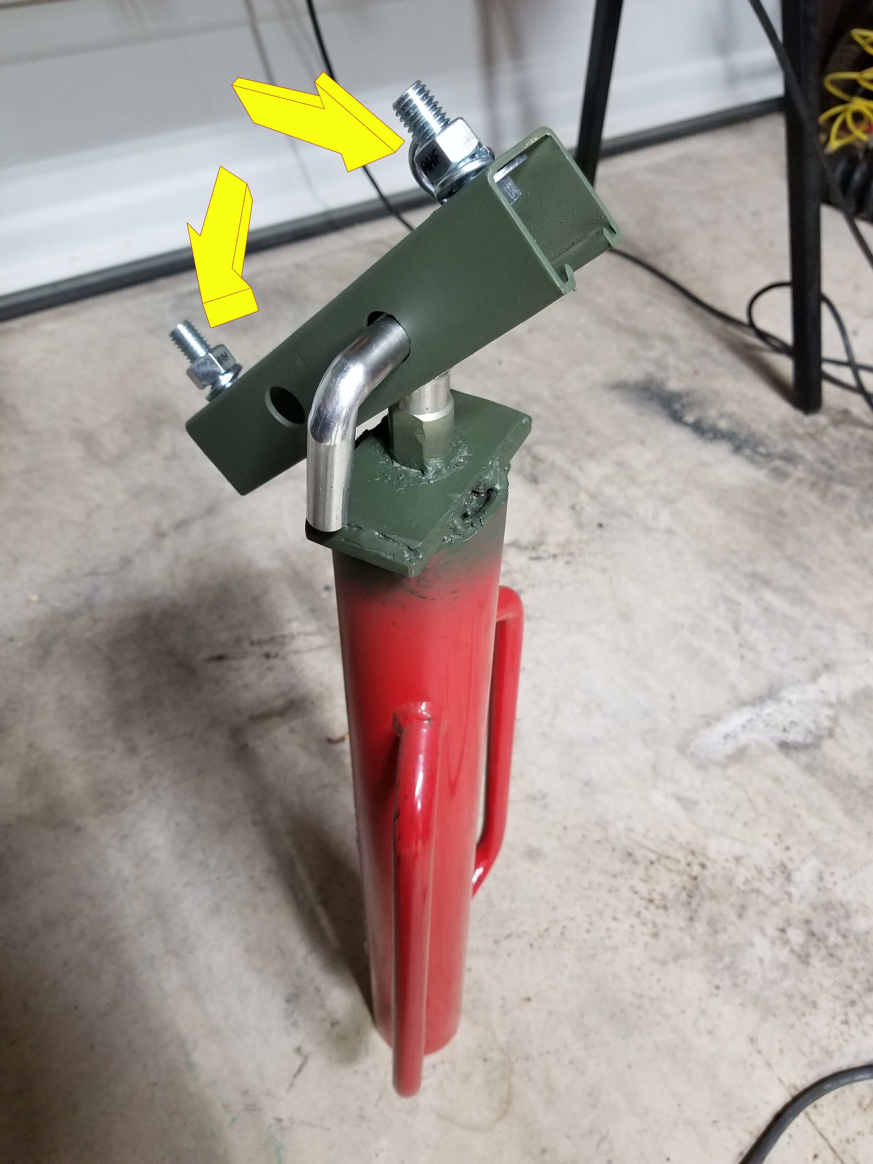

Can you show it attached ?
My tractor isn't in yet. LOL! But, in the first photo, the two bolts you see will be securing this rig to the bottom of the bucket.

Any concern in driving the t post in at the side of the bucket - unbalanced force on the front end loader. I would take a blank quick attach plate and rig it up in the middle so you get even load on the loader arms.

No concern since it is a slow push and a t post will give up and bend before the tractor is stressed. A smaller tractor than the 2538, I might be concerned though.
We thought of pushing bucket only but I wanted something less dangerous. One slip with the bucket can be serious. This allows us to set a post without someone holding it.
That is the guy and the video I watched. Great idea but easy to build your own. Just need to learn more about my welder. Lol! I am confident the ugly welds will hold though. You don't have to be perfect, just good with a grinder, right?
