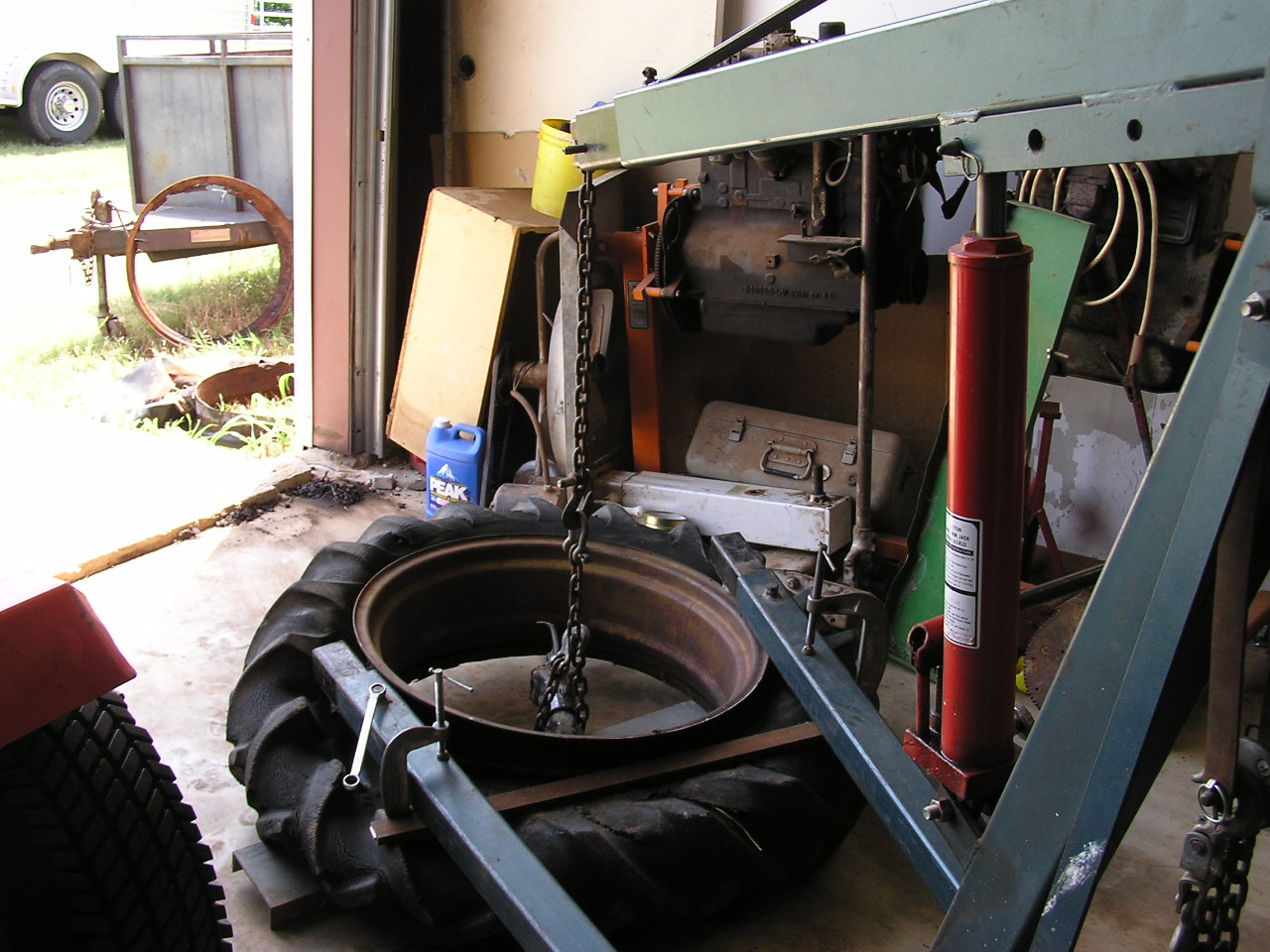

I've been doing this for years, but I just use the frame of my truck or tractor as the anchor point. I just find a 2x4 and a block of the right length. As far as getting them back on, I don't have any magic methods other than getting the bead started down in the deepest part of the rim. Soap for lube, several tire irons, a hammer and lot of effort. Having two people helps.

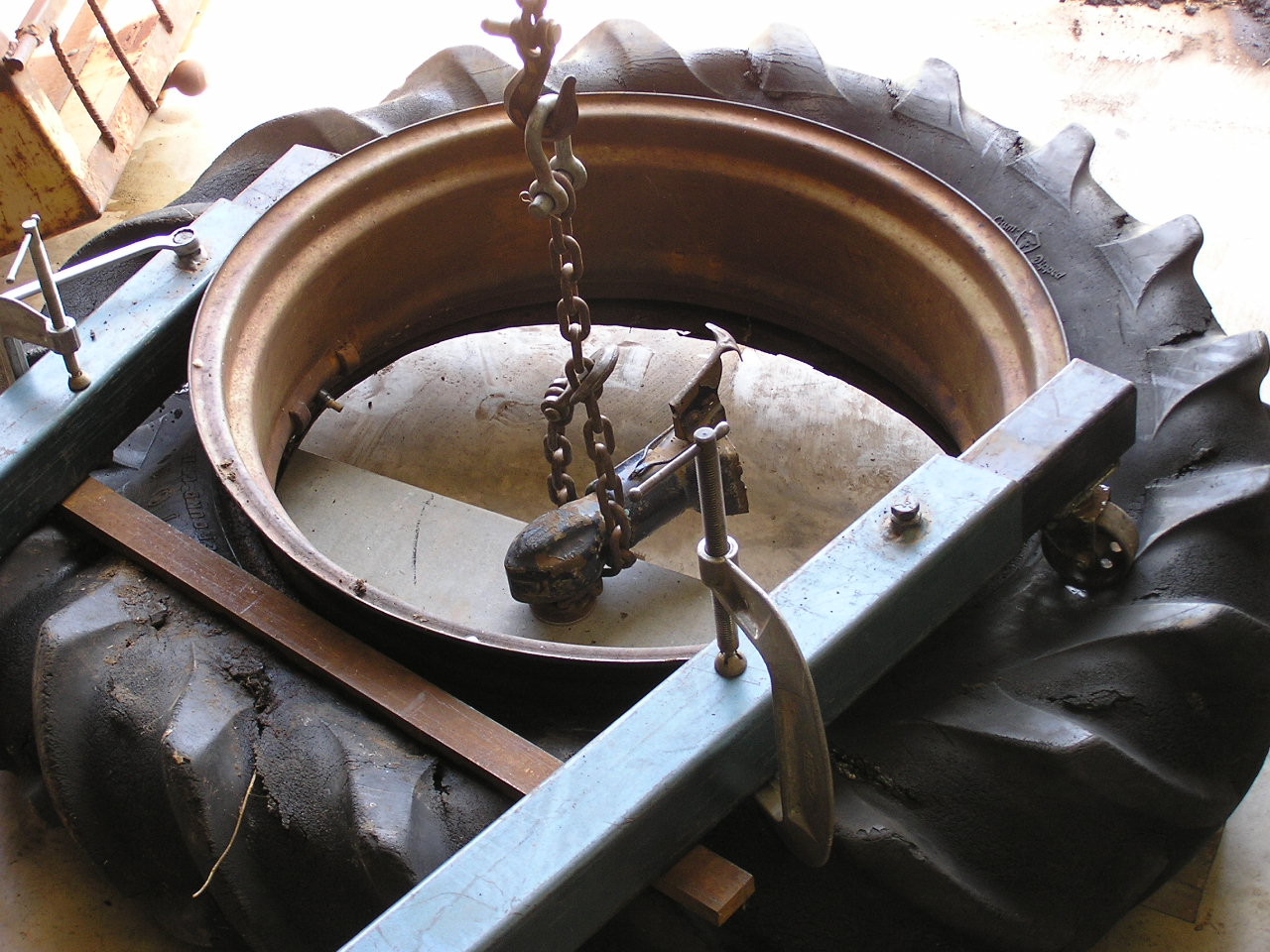

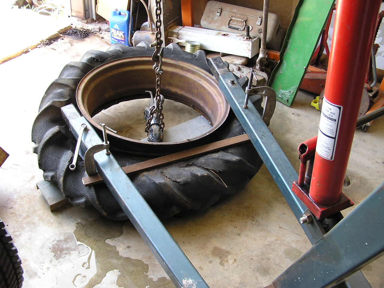

Here is another way to do it, from when I didn't have a FEL.

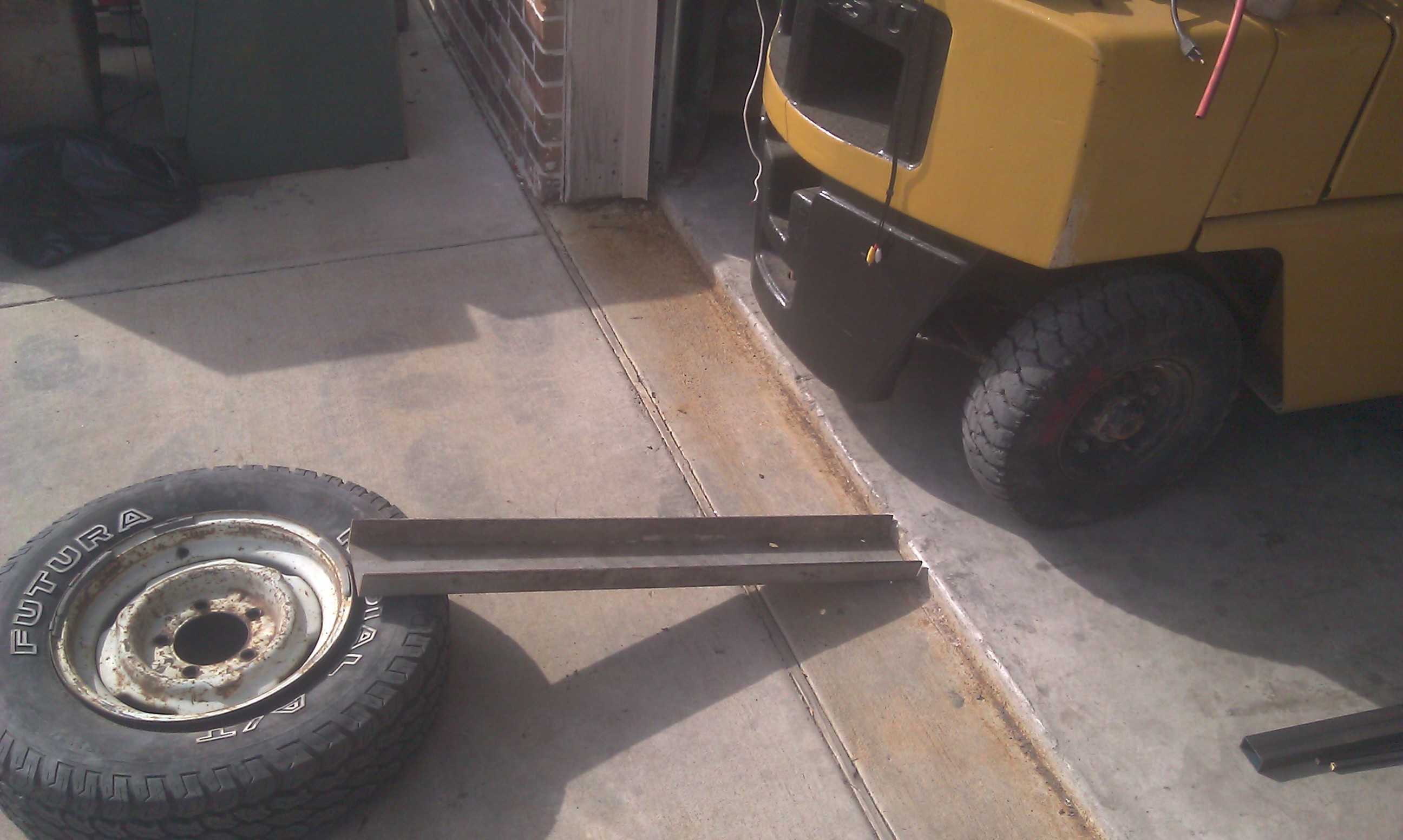

I have a tire machine at the farm but needed to change a valve stem a while back here at the house, just laid a section of channel iron on the tire and drove up on it. Simple, cheap and quick.
