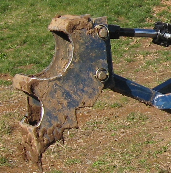

I built a 5" bucket based on the cad plans design. It was a total failure in my heavy clay soil - it took a long time to chip the concrete like compacted clay out of the bucket. I decided to use the bucket to remove small stumps, so I cut almost all of the back out, but the clay still compacted in the bucket. I finally removed some of the sides, and now it works great as a stump ripper. Also - since I use my buckets "occasionally", I don't bother with the super steel edges or teeth - I use regular steel, and if they ever wear out, I'll weld on something new - two backhoe buckets and a skid steer bucket, and no problems so far.
I am facing the same problem because I have an over abundance of rich clay soil.
