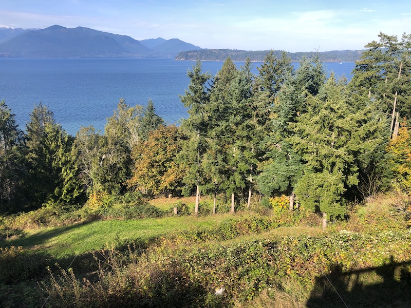

I have several choices of trees to extend to from the house. To the NW, W, and SW directions. No clue as to what makes sense. My property slopes down and is about 1:2 to the NW, and level to the SW. Any clues on what makes sense direction wise. My preference I think is to string to the NW down (actually almost at a level height) and attach about 50 to 60ft up a 75ft fir tree. Going to need some bungee type of restraint as the winds can really cause the trees to sway!

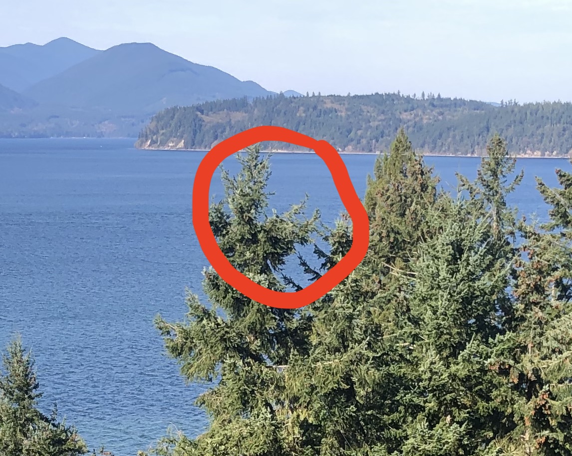

I decided to string the antenna to the NW to the left most fir tree in the pic. This is the view looking NW from our deck. I am guessing the tree is about 70ft tall and maybe about 140ft from the house with the top about eye level. Second pic is zoomed in view of the top of the tree and the target area for the antenna end.
While I was looking for a suitable rock or old baseball to attach some fishing line with the thought of throwing it over a tree branch, my wife came up with the brilliant suggestion. "Why don't you use your drone?". I did just that... I taped the fishing line to the bottom of the drone and flew it just above and just to the right of the top of the tree, circled around the back and flew it 'home'. My SIL let the fishing reel free wheel with a bit of thumb drag to keep it taut. I was pretty nervous as I feared the line might get caught up in a prop! Lots of things could have gone wrong.
Too bad I didn't think to video the event. I feel very lucky it was uneventful and successful on the first try. I was able to navigate the drone and place the line exactly where I wanted! :cloud9:
Now I am just waiting for the antenna to arrive.
