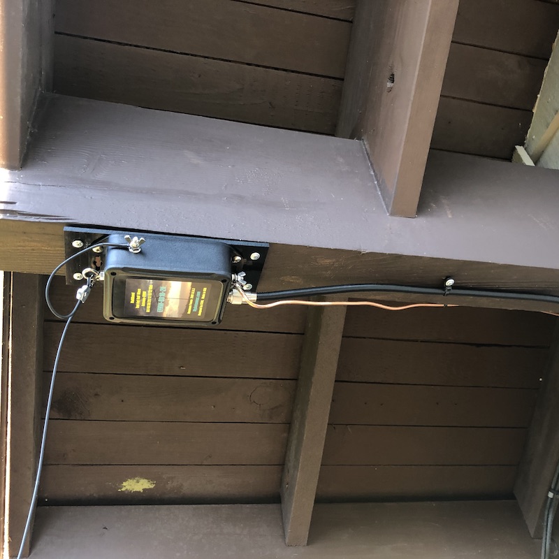

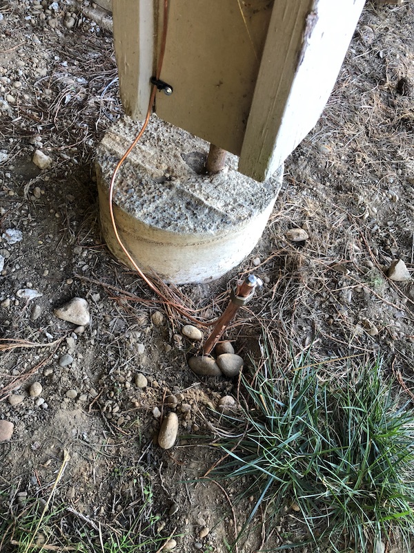

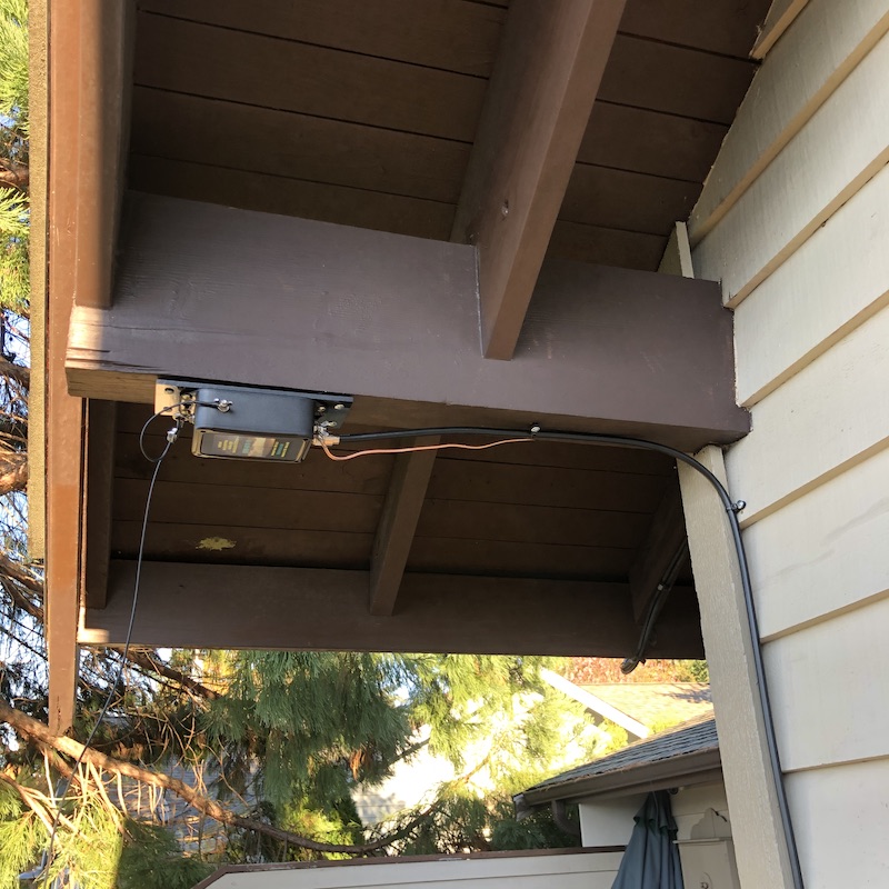

Okay guys... up and running.
Got the antenna properly grounded... still lots of noise... about. S7 to S10 depending on band.

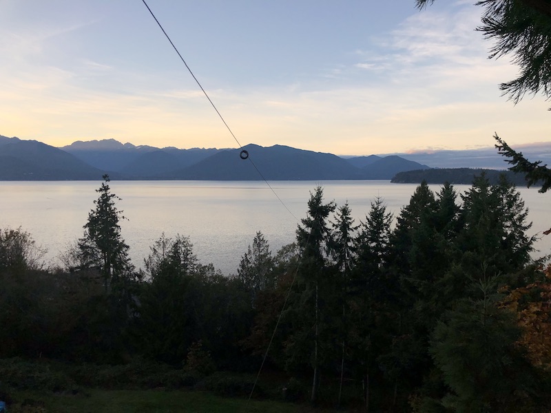

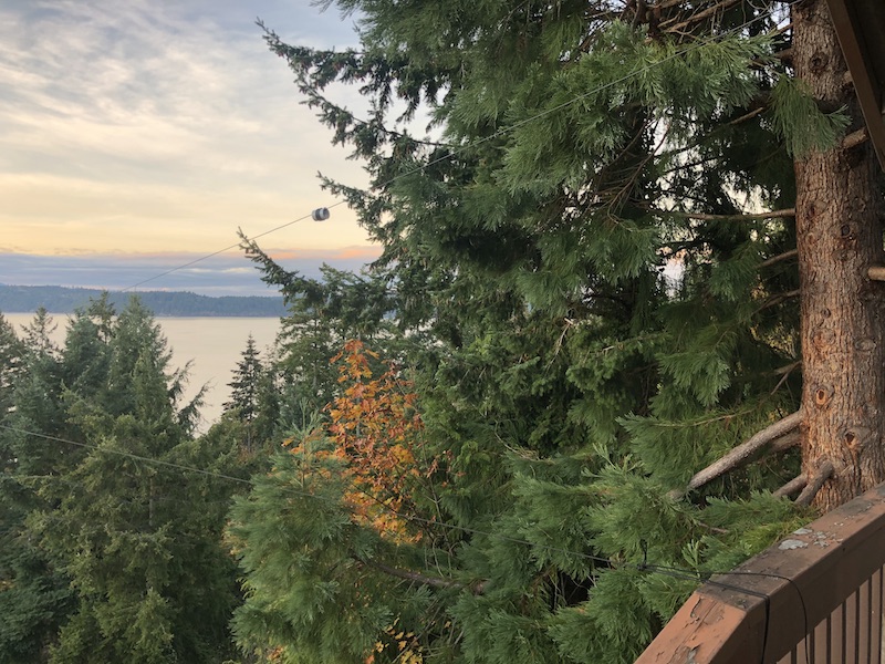

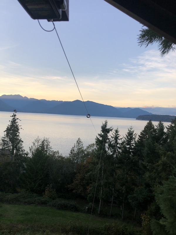

The big job was to pull the antenna out to the tree. First I tied some 1/8in parachord to the fishing line and slowly fed and reeled. Once the parachord reached the tree, it hung up of course... even though I was extra careful to make sure the transition between the lines was smooth. :smiley_aafz:
After some back and forth, it freed and I had the cord coming back at me. :dance1:
Still nervous... the drag was getting more and more and I started worrying that the fishing line might snap. I used what on a reel and probably 15 years old and maybe 20lb test?
Anyways, worked it a bit like bringing in a big fish. Reeling when I was walking toward the line to lessen the load. I was so happy. when I got my hands on the parachord. Turned out that the distance to the tree is about exactly the length of the antenna! :eek:
I pulled the antenna out and the end terminal/pulley reached the tree. Don't know how these pics will show but...
