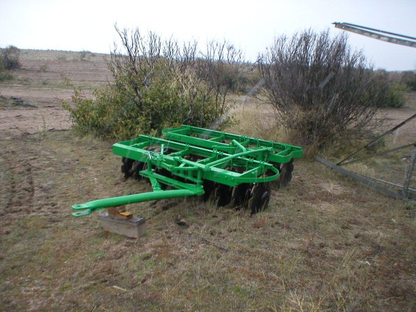

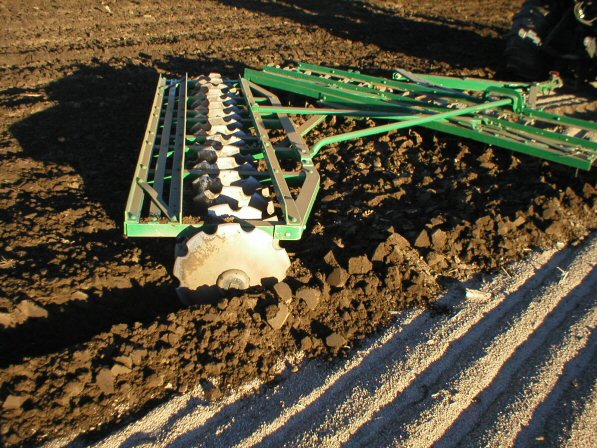

Everyone's conditions vary, and for what ever reason everyone else seems to be able to pull a much larger disk than I seem to be able to. :confused: But I use a 75hp 4x4 tractor that weighs over 10,000lbs with the loader off and all that I am able to pull every where on our property is an old 8' offset JD-Kielfer disk with 22" notched blades that weighs between 2000-2500lbs. We have what I consider pretty good ground and normally on the second pass I am cutting down to the hubs.
I guess what I'm getting at is that there is no way that I would consider anything over 7' for your size-weight tractor. But then that is probably just me and I'm talking about 20-22" dia disks and an overall unit that is about 2000lbs.

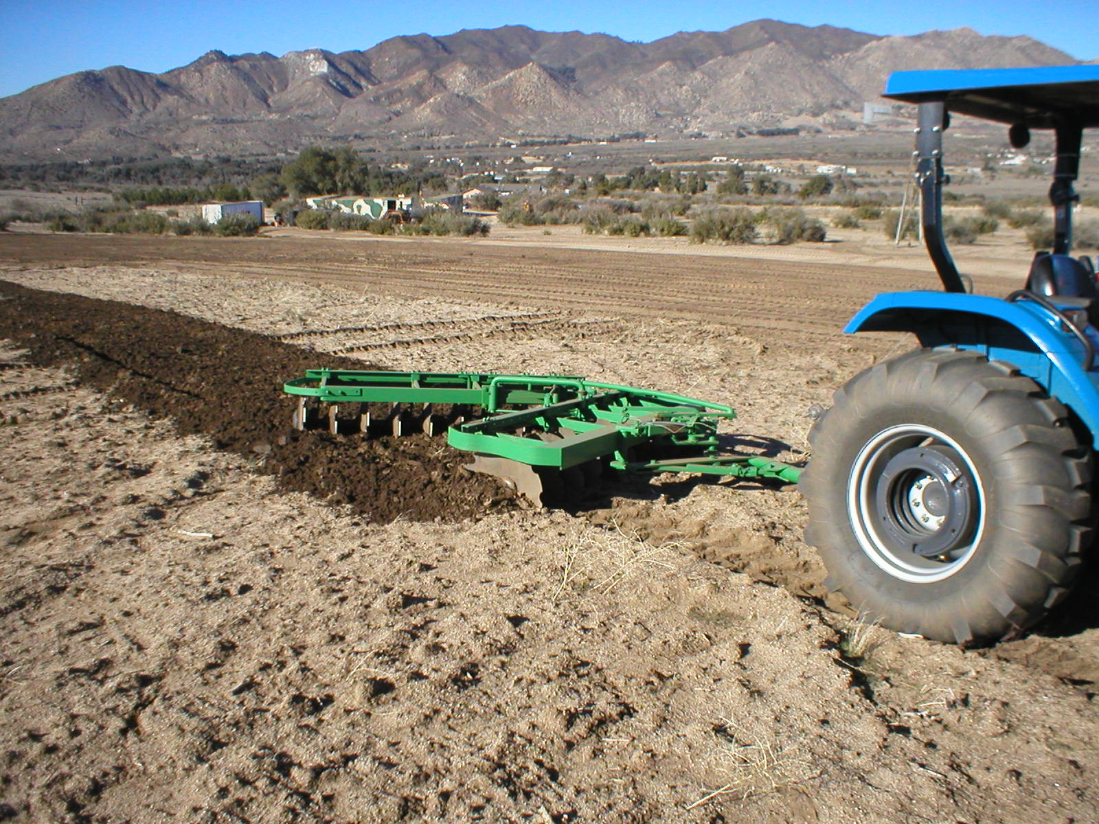

Towed Tandem Disc Harrows without transport wheels, such as Massey-Feruson #25, require more power to pull because ALL the harrow weight bears directly on the individual pans, that is why 6 to 7-hp per foot of width is necessary.
Check out MtnViewRanch's NO WHEEL, towed Off-set Disc Harrow in Post #6 and you will see why more power is necessary. Think of the draft force!

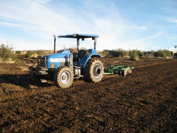

We also have a 12 footer of the same type. The 75hp tractor will pull it on flat ground for a first pass only, it won't do it after that. We use our old CAT D6 to pull it over most of our land and if the conditions are right, even it will get the tracks on the CAT slipping (spinning out). :eek:

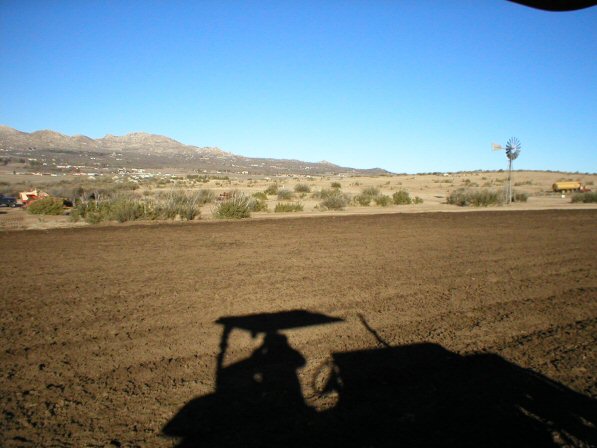

WEEDS. :( We were burned out 12 years ago, :eek::thumbsup: I just keep things disked up when I have a chance. We had another BIG wildfire a year ago or so, came within just over 1000 feet of our place on the East and South sides of our property. If I can ever afford to get a bat wing, I will just keep most of it mowed. ;)

No problem turning, as long as you turn left. Disks pop right out of the ground. Cutting depth is adjusted by the angle, less angle=less depth. Transporting on the ranch is no problem, set the disks straight and they just ride along on top of the ground. Sharp turns, no problem, but only as sharp as the draw bar allows before it's up on the tire or track. :eek: If a person knows what they are doing, the only time that it's tough is when you are on the first row and you have to turn and come back right next to where you had just left. You get use to it and it becomes automatic. ;)
First row is hard, need to keep it straight and that is hard when you can't see the other end of where you are going. Second row is easy after you make the super tight turn. lt's easy after that. :thumbsup:

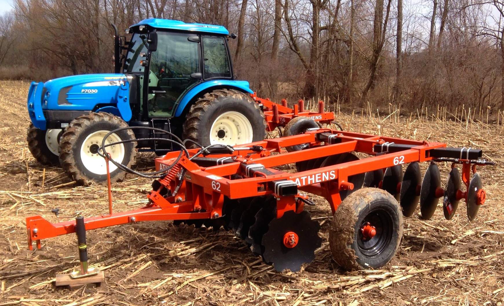

I have an Athens disc that is right at 100" and with the scrapers weighs in at 2000 lbs. I have a clay soil and am constantly dealing with wet conditions and even with 88 hp and R1 tires it will bog down. I think you might be ok in good conditions with a wheeled disc if you went just slightly wider than your track. You can put some weight on the tires to cut down on drag but would want to be able to run it most of the time in a wheel up position. Do you have R1 or R4 tires?
