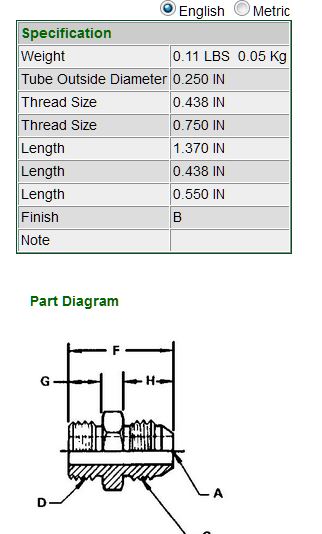

Type end "03" is a female swivel (Thread Size 0.438 IN) for a JIC fitting(photo attached) so hose will attach to "A" end of fitting in schematic.

Jim,
With that additional information, I can determine that you need a 1/4" JIC Female Swivel hose fitting.
I would specify your hose as R1-04 HOSE with FJX-04-04 E/E 223 IN OAL, $35.38 fully assembled.
