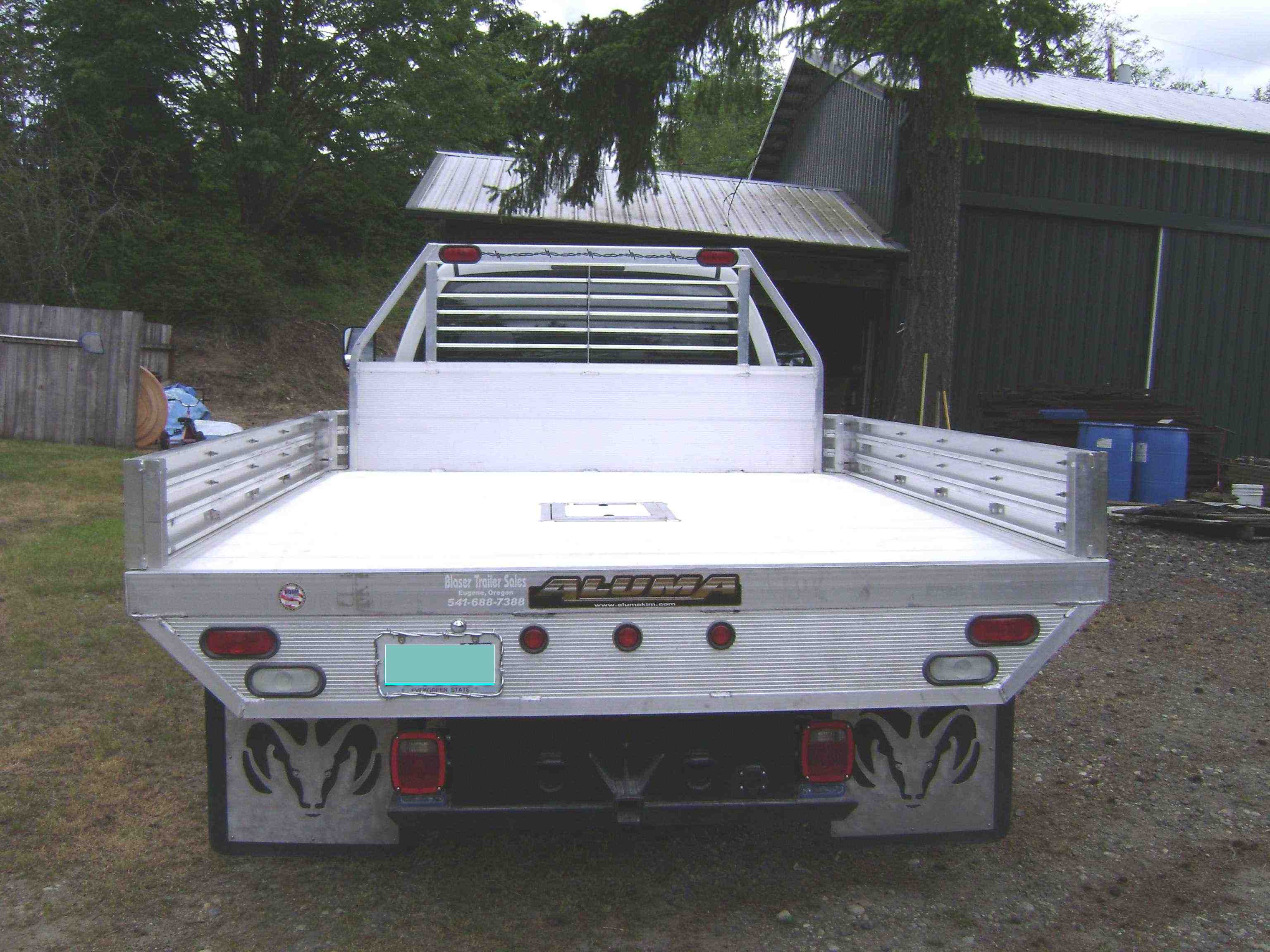

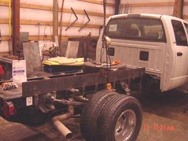

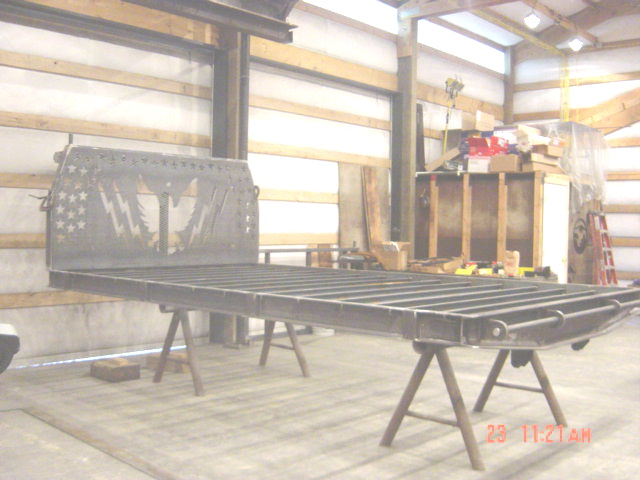

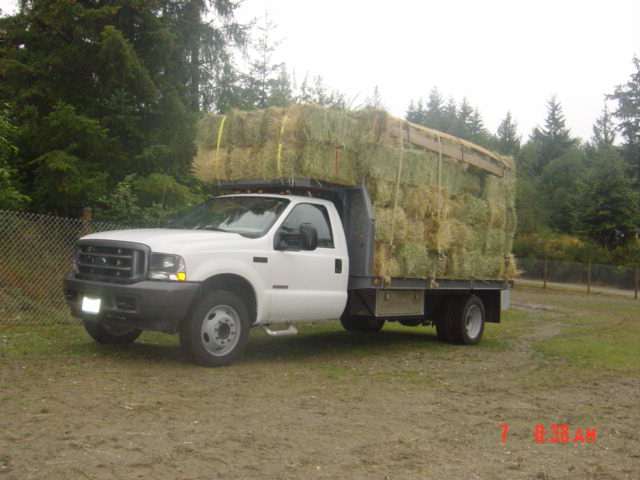

In 2004 I bought an F-550 cab & chassis, built a 14-foot flatbed dump for it. In the up fitter's manual it said to disconnect both batteries before doing any welding. 2007 I sold it and bought a Dodge cab & chassis, bought an aluminum flatbed for it, but made the bumper, and a sub frame to attach the flatbed to the frame of the truck, again in the up fitter's manual it said to disconnect both batteries, which I did.
Now for the catch, I've done a few little welding projects on my JD tractor, never once disconnected the battery. Couple years ago I ran out of fuel, but the gauge said 3/4 of a tank! Circuit board in the dash went out. John Deere wants a $1,000.00 to replace, (yeah like that is going to happen)! So the question is, did I burn this board out by not disconnecting the battery, or just one of those things?:confused:

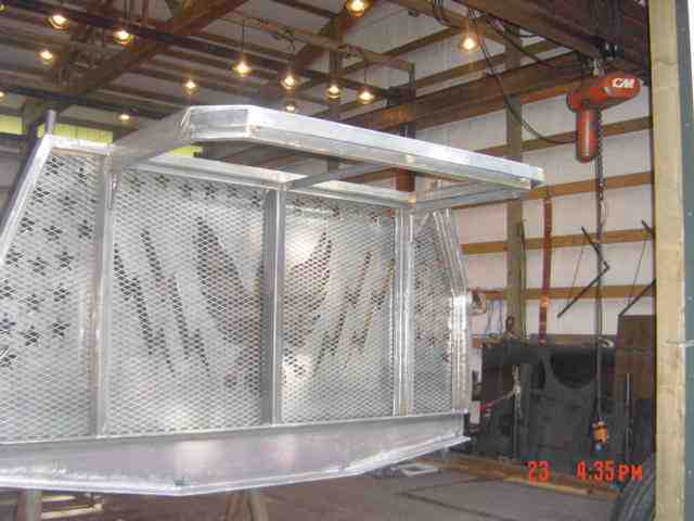

My curiosity was whether or not there were any electronics I would damage when I do this weld. As I said, I was told to unhook the battery when welding on a vehicle with a computer, and wondered if it was necessary on my tractor. Thanks for all the responses. BTW, that's a great looking headache rack, Shield Arc!
/ disconnect the battery..... #25
Thank you!;)
Would you believe when I got through with that truck, adding the hoist, hydraulic pump, tool boxes, and bumper, I added 1-ton to that truck? All it did was make it ride a little better.:laughing:

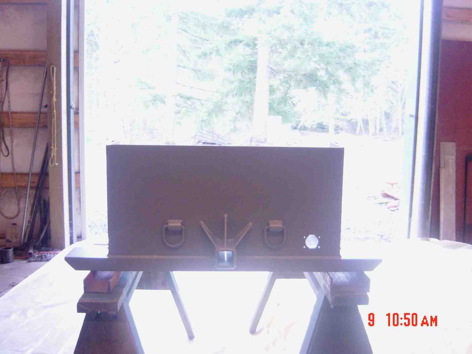

Couldn't find any pictures of the hoist, but here is one of the bumper I built.
