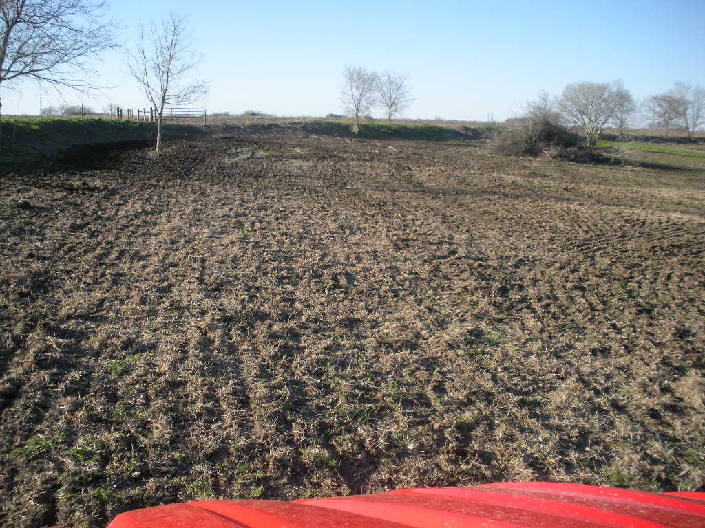

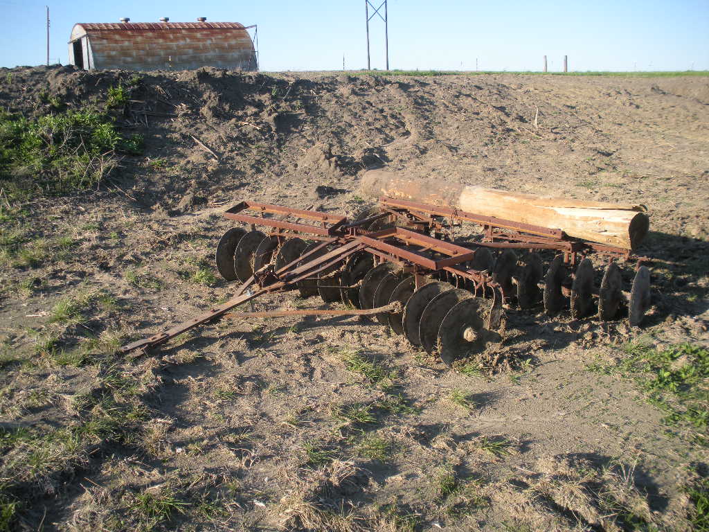

First time using a disc today.
Pics are of one pass over the ground. It is recently cleared and I am looking to make it into pasture.
It does not dig in deep enough. More passes at an angle and more weight on the disc? How much weight would be in the ballpark?

Add weight till you get the desired results or the tractor can't pull it.
You might want to look at the angle too.:D
/ discing #3
Sometimes it is too dry to disc. As far as weight goes it's whatever you tractor can pull. If the disc axles are riding on the ground it's time take some weight off.

I have an old Ferguson 7' disk that weighs about 600#. On the first pass over new sod it goes about 4" deep in soft soil. Three passes will get me 9" deep and the ground will be worked nicely. I can't add weight. My B7800 won't pull it. I only use the disc for a small food plots.
/ discing #6
for one pass, that looks pretty good. Sometimes I make as many as 8 passes if the soils is hard and never worked before. THe other option is either a heavier disc (but would still take several passes) or do what I have started doing-using a moldboard plow first. It greatly speeds up the discing.

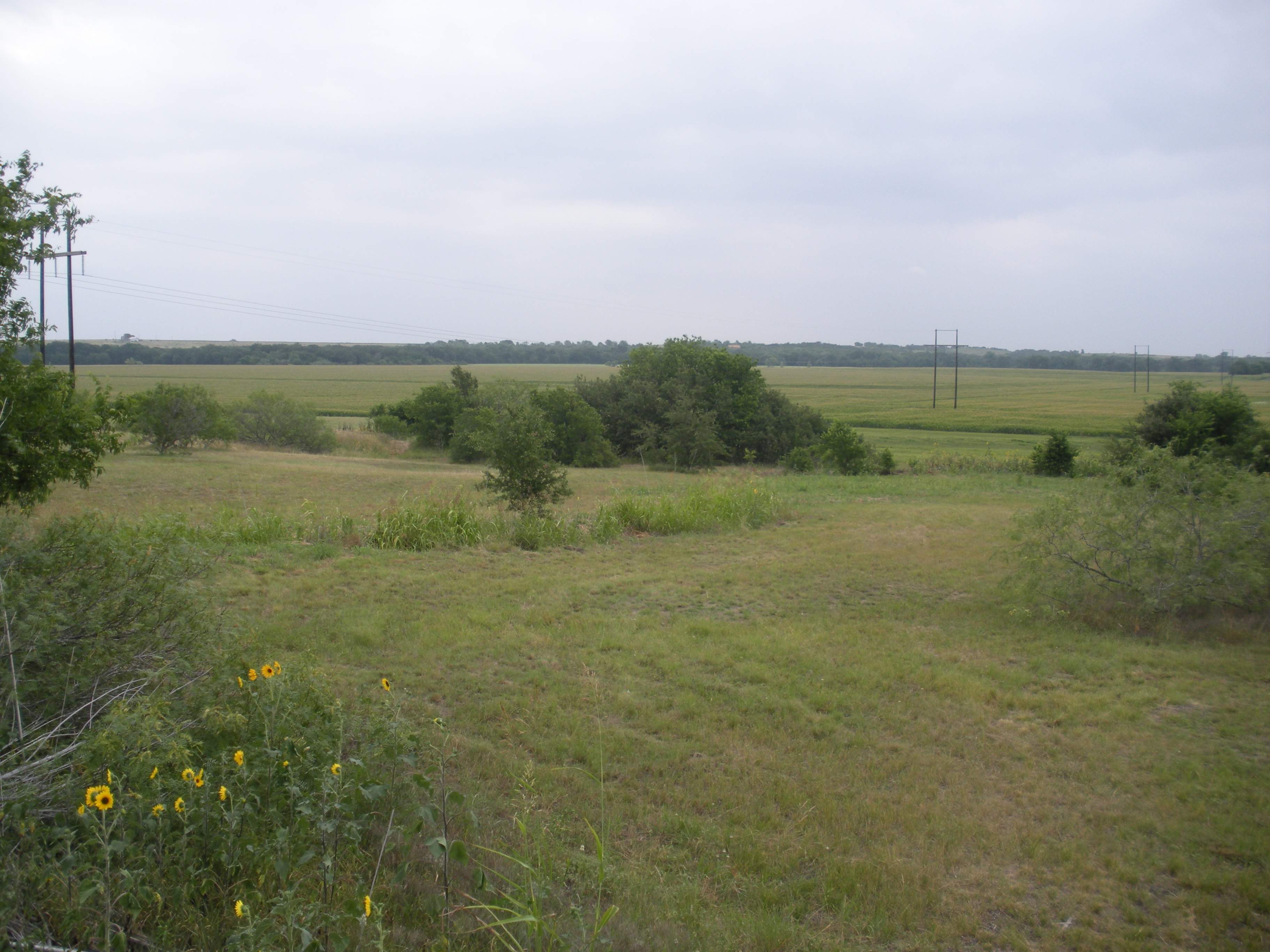

This ground falls into the not worked in decades category. Below is a pic of an area after I had mowed it a few times for the first time since the early 80's at least.
I was thinking of buying some plastic containers and casting some concrete weights but the size of the weight platform is an odd size at 8x30 in. and I have not had luck finding anything.
I will try several passes over a realtively small area and see how that goes.

I would measure the top boxes and build some cement forms out of 2x6 lumber to make some weights, that disc looks light. It will take several passes with this disc to get results, be patient.

Looking at the disc pics, I think the disc blades may be worn a good bit judging by the clearance from the frame to the blades. That might affect how aggressively it cuts.

Your disc looks a lot like an old 6-ft Ferguson disc a bought a few years ago.
I use a 6.5 ft Towner offset disc for primary tillage. It's a heavy dude-600-700 lb. I add about 480 lb of weight (four 120 lb concrete weights) to that disc to get it to bite. You need to pull discs at 4-6 mph to get them to work properly.

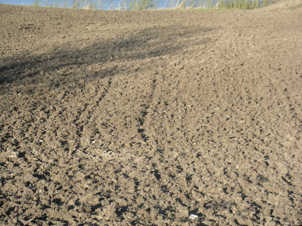

I have added 300 pounds to the disc and made 2 more passes in a crossing pattern on one area. It definitely works better and has cut in 3-4 inches.
You are making progress. That must be some well packed, hard soil. I wonder if it might be a good idea to go over it with a sub-soiler. How deep do you need to get for a good pasture seed bed?

For grasses, I would think you've tore it up enough. Good job.
For potatoes and other gardening plants that need a 6-8" bed, that job would be a whole lot quicker by breaking it first with a inexpensive middle buster type tool. That is why those MBs are so darn popular with guys here at TBN.
For what you are gonna do, what you have there will be fine, I should think.
