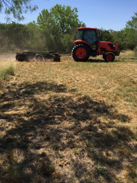

/ Disc Questions - food plots #4
Picture is my primary tillage tool for game plot. Heavier is better.
