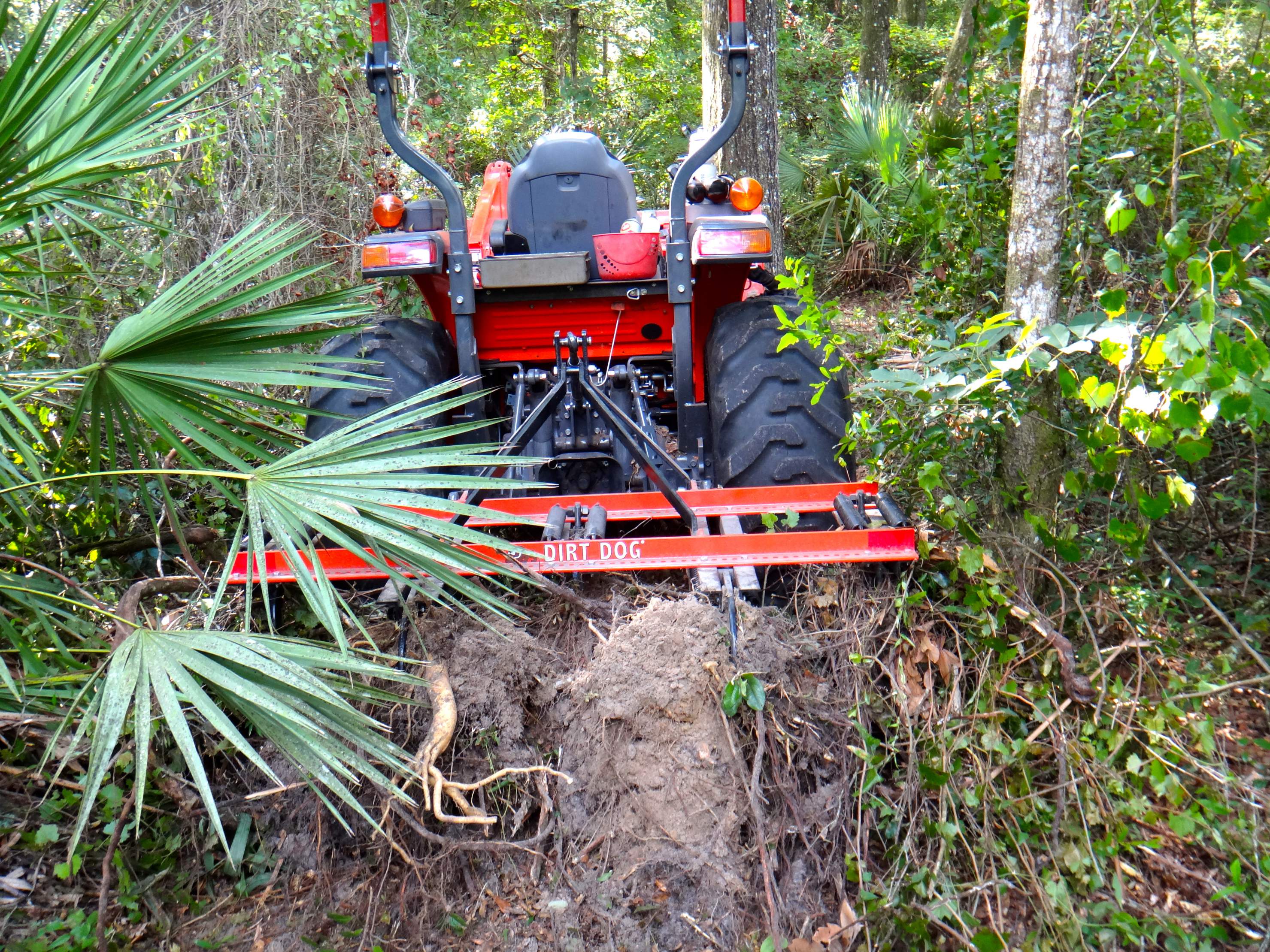

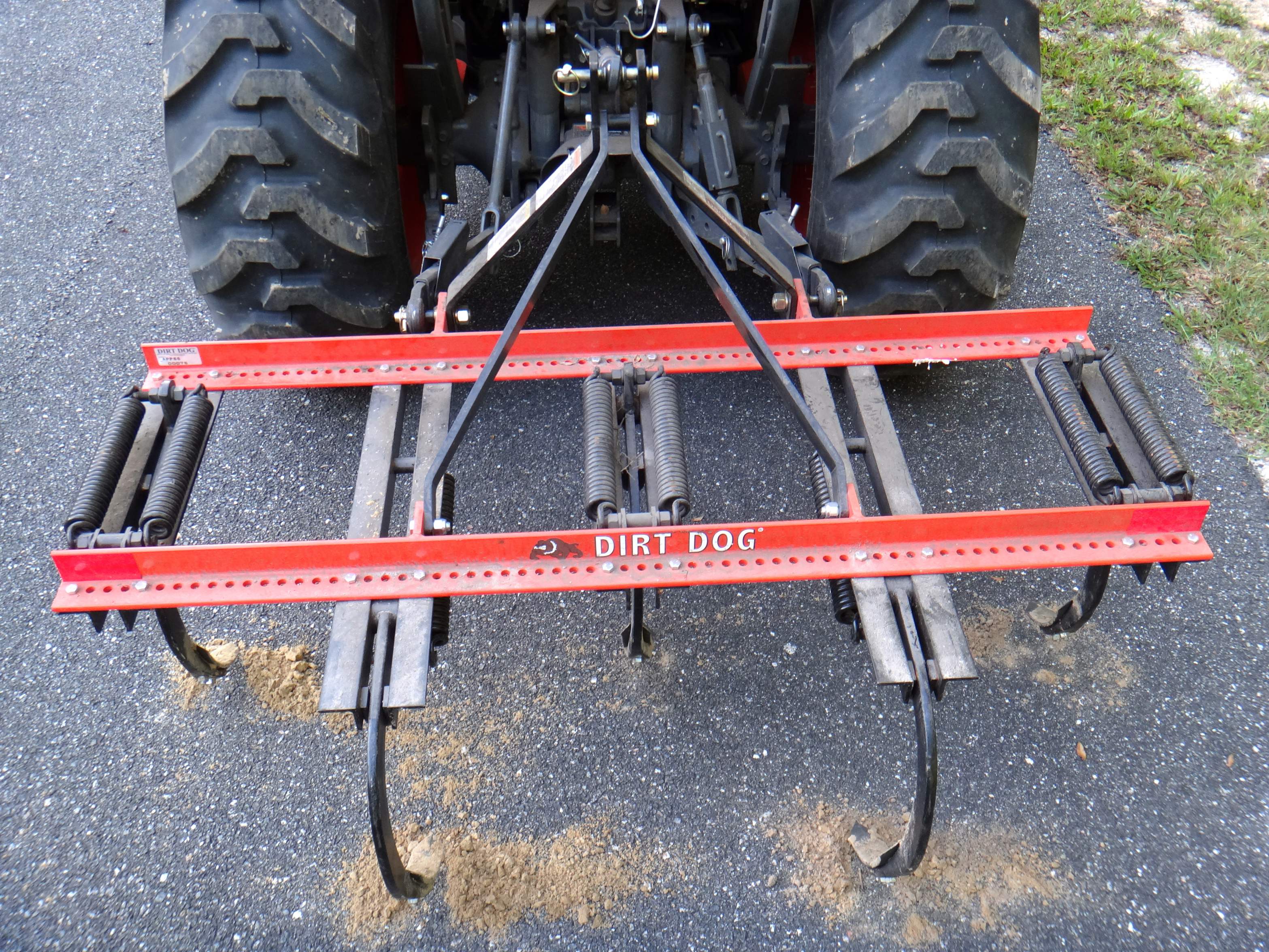

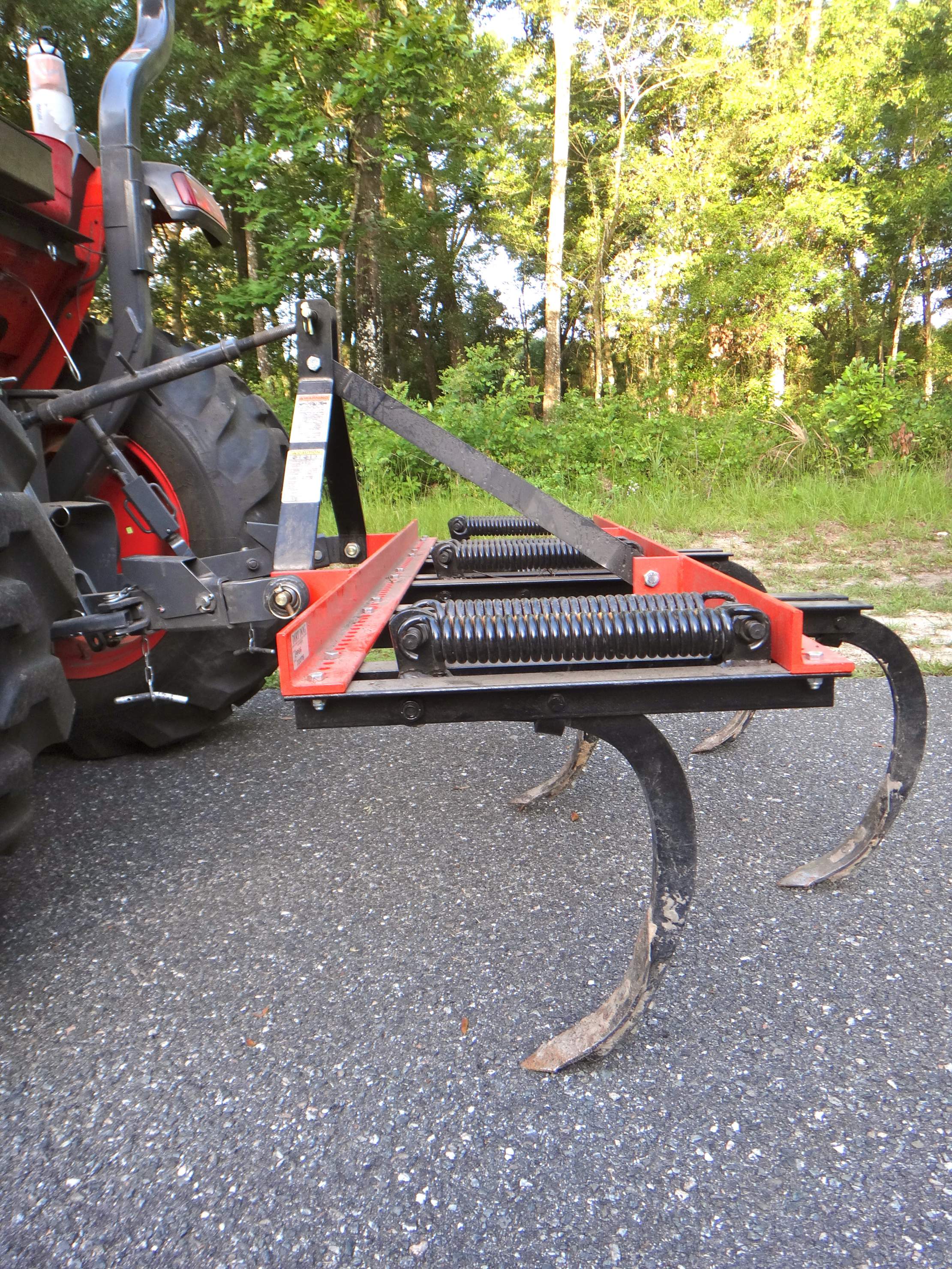

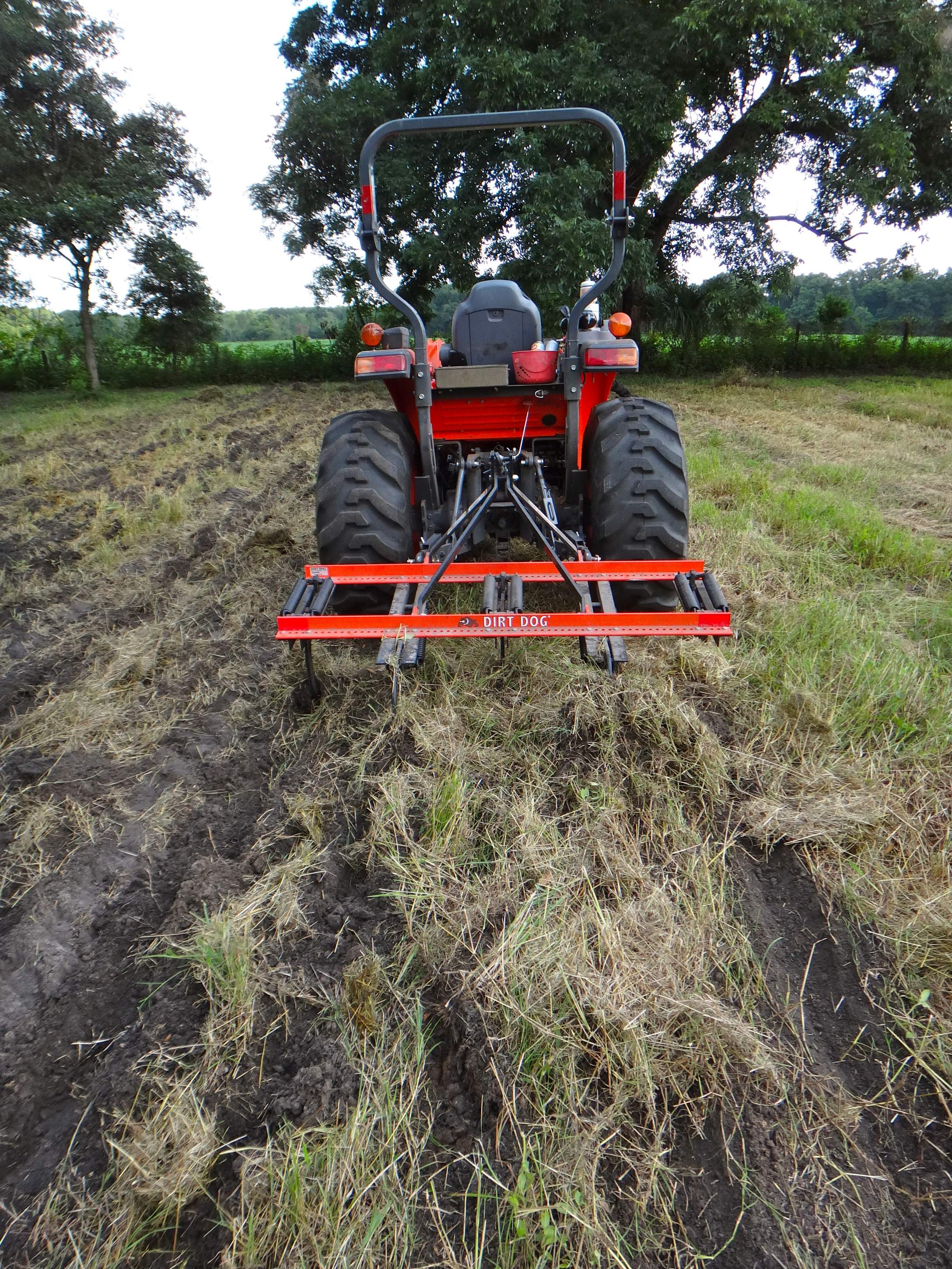

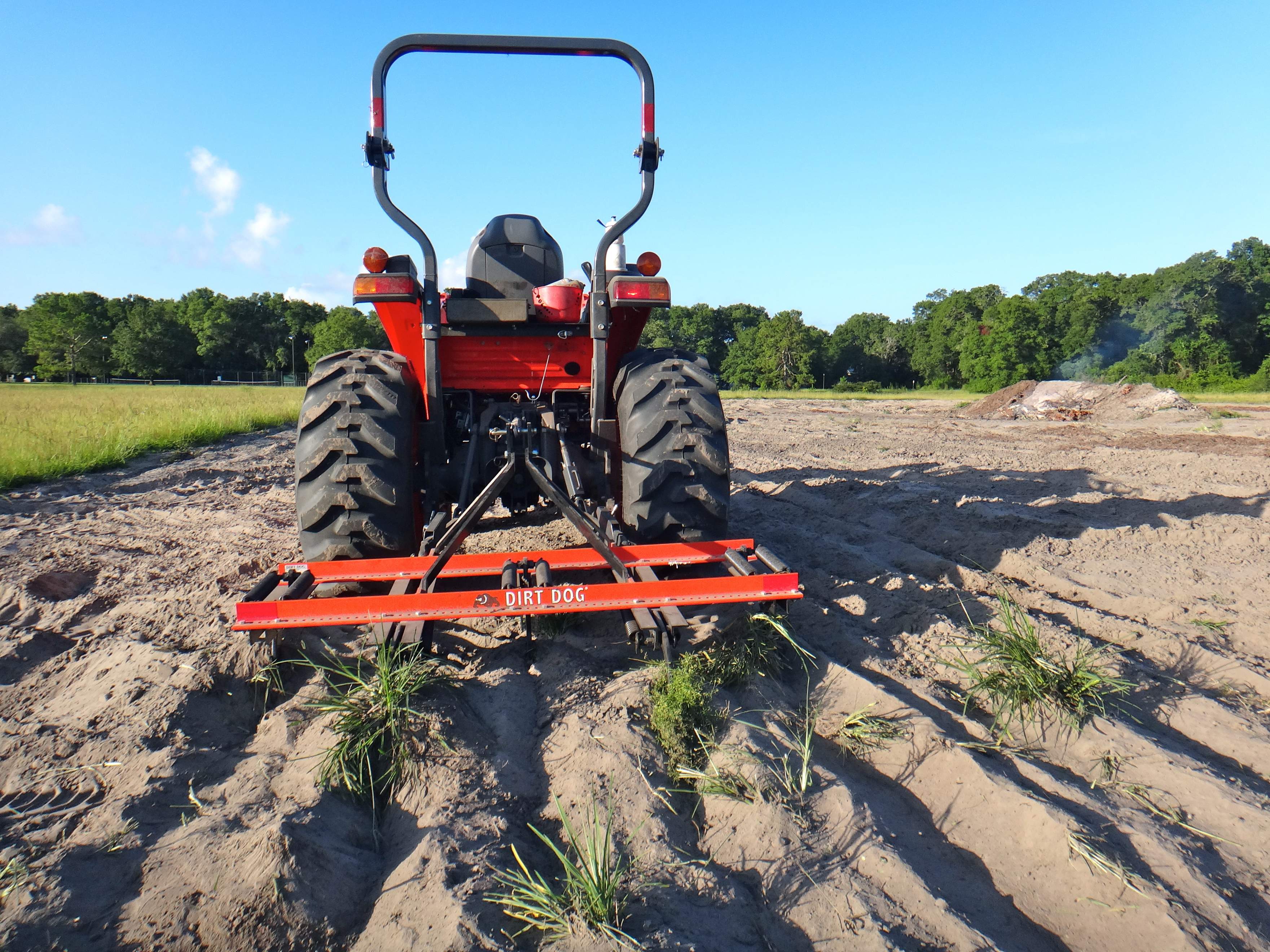

Disc Harrows do not become effective until pans are at least 20" in diameter, which requires a minimum 3,300 pound bare weight tractor with 4-WD to pull. Disc Harrows with 20" diameter pans have ~~45 pounds~~ harrow weight bearing on each pan; the key metric for mounted Tandem Disc Harrows.
Consider a three-shank (for BX) Field Cultivator for aerating/tilling animal compacted land. A three-shank Field Cultivator, which is a type of Conservation Plow, will penetrate 10" behind a BX.
Field Cultivator: A Three Point Hitch mounted, secondary tillage implement, used to perform operations such as soil aeration, sub-surface vine and root removal and eradication of deep rooted weeds. Field cultivators are equipped with parabolic curved steel tines, typically spring mounted to permit the tine to move within the soil and shatter clods. Field cultivators are constructed similarly to chisel plows, but are more lightly built.
Today the Field Cultivator is NOT one of the best known Three Point Hitch mounted implements. It is, however, one of the oldest designs, having been patented by Harry Ferguson, inventor of the tractor Three Point Hitch, in 1932-1933. The other earliest Three Point Hitch implements were the Ferguson Moldboard Plow, a Ferguson ridger for potato cultivation and a Ferguson row crop cultivator.
Harry Ferguson, the inventor, termed this implement a 'Tiller'. Ferguson patented arrangement by which the tines are spring loaded, allowing them to kick back if an obstruction is encountered, then return, undamaged, to normal operating position. Field Cultivators sold today are contemporary replicas of the 'Tillers' sold by the Ferguson organization from 1934.
The Field Cultivator and its heavier relation, the Chisel Plow, are both used for conservation tillage.

S-tine Cultivators are for gardens maintained in good tilth. You will break the tines on S-tine Cultivator trying to penetrate animal compacted ground.
You need to find a spring-protected Field Cultivator with parabolic shaped tines.
Field Cultivators and Chisel Plows have parabolic shaped tines in common. Parabolic tines pull much easier through soil than angled shanks, such as those equipping Box Blades. From my observation, this is because parabolic shaped tines have the forward part of the tines in nearly a horizontal position working the soil. Field Cultivator tines are tipped with sharp, chisel points further reducing draft resistance. Spring protection allows tines to store energy when encountering resistance, then to snap back, releasing stored energy to break hard ground.
VIDEO: How to Use a Ripper / Field Cultivator - Gardening Series - YouTube
Haye's Ripper would be more robust than Haye's S-Tine Cultivator but from my experience I doubt its ability to penetrate adequately. Tines are not parabolic shaped. Nor is shank spacing adjustable.
FIVE TINE TRACTOR RIPPER - Hayes Products - Tractor Attachments and Implements
eBay.Australia: T-YK-9 CULTIVATOR / PLOUGH | eBay
Field Cultivators are bolted together from parts. If a nine-shank Field Cultivator is available, surely five-shank and four-shank Field Cultivators are available too.
From $2,225 nine-shank price I think I can guesstimate price of three-shank at ~~$800.
