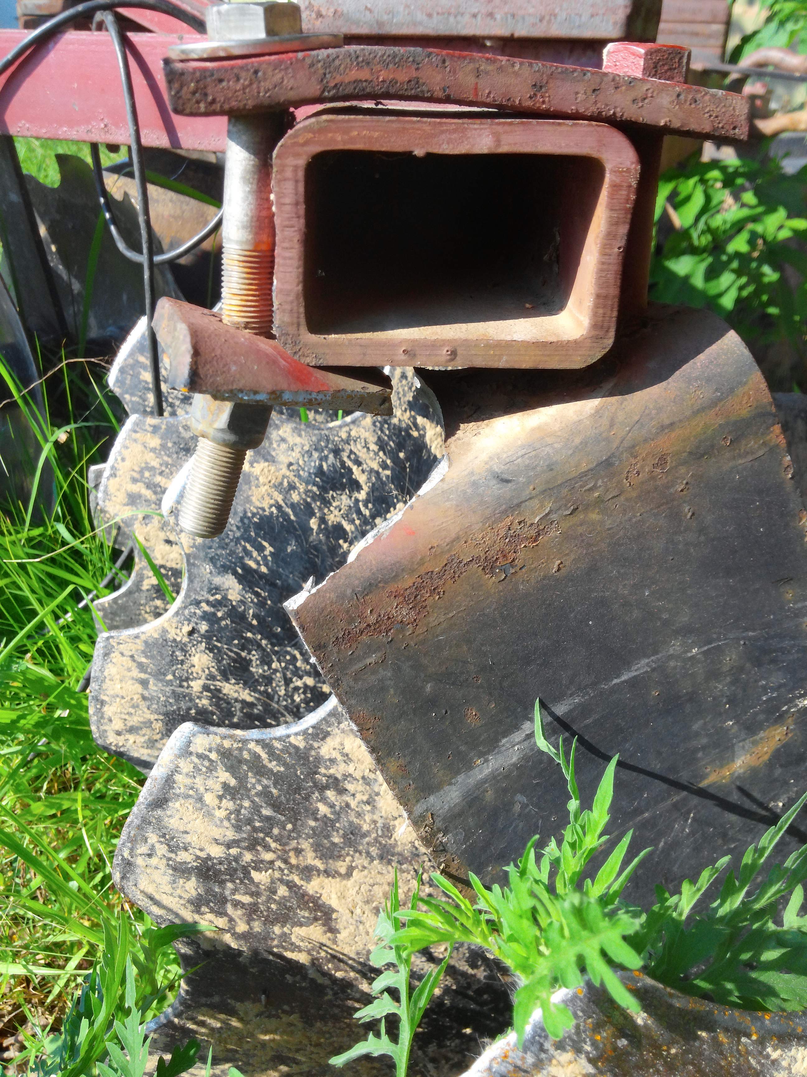

I wouldn't worry a bit about a 3/4" hole in the frame as it would do little if any weakening of the material. I have seen crane booms that have major holes cut in the boom to lighten the load without weakening it that much.
I would get the Howse since it is cheaper, blades are in much better shape too and it looks like the frame material size is typical for both disks.
I don't think I have ever seen a disk with turnbuckle adjustment of the 3 PH to put more pressure on the back. You can do that with your top link on the tractor so that disk link is not needed.

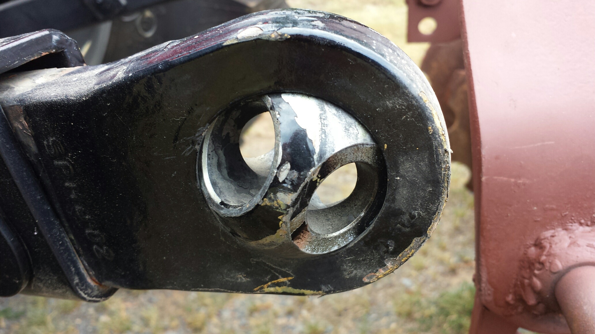

it has not been said.... hooking a cat 1 equipment up to a cat 2 tractor requires some sort of bushings / pin adjustments. pending on the cat 1 hook up on the equipment. (cat 2 has bigger holes / larger diameter pins) some cat 1 equipment are setup so they can be interchanged between cat 1/2 (for example cat 1 inside, cat 2 outside of the Triangleish frame mounts)
when getting up into cat 2 tractors. sometimes they give different holes on rear end of tractor, for lower lift arms and top link. to adjust between cat 2 and cat 1 setups as well.
Mine has the dual hole setup for Cat 1 or 2 on the lift arms. The top link is the same for either one.
   / Disc Harrow - Too MUCH hp? #45
That is a great feature. Mine is Cat 2 all the way around. So its bushing for all Cat 1 implements. I lose bushings all the time & some have to be wider than others - duh, duh, duh etc.

I have a Howse disk and bent one of the crossmembers at old hunting club when it hung on a big pine. I took it off and bought a thick wall tube, had it cut to length amd drilled the bolt holes. Replaced all of the arms and added 100 lbs to the disk. Pull it with a 5500 4WD and it works good enough. I would like to find a wider and heavier disk.
It will still break!! But the arms will hold up to a lot of force!! LOL
Ouch! I bet you felt that! Luckily for me, I have no trees to get hung on. Just a couple of power poles so if I run into those out in the wide open then I probably need to park the tractor for a day or two. :laughing:
I ended up buying the Howse. Everything looked pretty solid on it. The bearings were in good shape and the disks almost looked new. It's twenty-two 20" disks with 9" spacing. It's 7-1/2' across the front and 8' across the back. I put an abrasive wheel on my cordless drill and took off the little bit of surface rust that was on it and hit it with some primer. I'll paint it when I get a chance as the Howse red is darker and dull. I'll see if I can make it a nice shiny Mahindra red.....or close to it.:)
