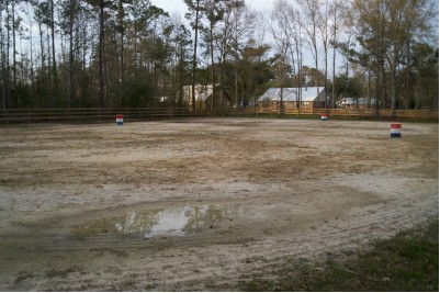

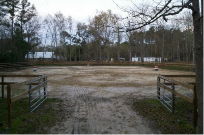

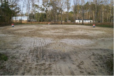

Down here is South Louisiana!... I hired a guy who owns his own tractor and figured i'm a girl.. so he could name his price.. becuase I needed the work done. That is why I am going to do the rest myself. I just about wanted to grab him off the tractor to show him how to do it since he could understand what I wanted him to do when I asked him to clear the land.. I had to call my horse trainer (guy) to come and tell the tractor guy exactly how to do it.

If your arena is like cement, I am not sure if a disk will work. If you have made a slight exaggeration :D then the disk-harrow will work. You might have to make several passes over the arena to condition the arena to your satisifaction. Also I think that you shouldn't let it set that long without re-conditioning the arena. :)
Good luck and let us know how it works out. Pictures are good to show off your work. :)

As I stated, I work the pen with the drag just about daily after riding, but when it rains and I cannot drag the pen and the sun beats on it for a day or two then the middle gets very hard and the teeth of the grader will not penitrate into the ground. some sand will cut but now as deep as it needs to be to have good footing for the horses. I think the photos of the small 5ft. disc is what I'm going to have to get to chop up the ground and get the slight impressions out of the arena.. I can drag with my grader after tearing up the ground to level it and get it nice for riding.
Thanks for the input guys.. I will be looking to purchase a 20-25hp JD w/front end loader and attachements soon... I don't want to have to depend on getting someone to help if I can do my work myself. I use to live in New Orleans till Katrina wiped me out... I now have this 6 acres and am trying to get it up and working for my horses. (race horses & barrel horses)
