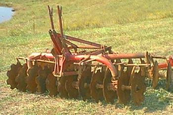

I saw a 7.5' 3PH Massey disc go for less than $300 about 6 weeks ago at a sale, it was in excellent shape. I thought about buying it, but was worried it would be too much for my tractor in transport position. The 6.5 foot Massey I am using now causes a lot of bounce in the front end while transporting, although it pulls with ease in use. I'd like to find a good 7.5' wheeled disc, as it would be easier to transport, but still pull fairly easily.
Here is a pic of a Massey 3PH disc that has been mentioned in this thread.

THAT'S IT!
4 more spools, 4 more disc pans, 4 axles about 8" longer than what your 6-1/2'er has, probably add around 125lbs, with half that WAY out back on the rear gangs. If you're "close" now, that might put you over the edge.
I wish I'd been at that sale . Been eye-balling a 7-1/2'er that's priced @ $800. Still a tad rich for my taste.
A wheel disc not only handles better tan a lift disc, but it USUALLY does a better job. (More rigid, yields "flatter" field. Longer framed, helps keep good down-pressure on back gangs) It's a personal choice when it comes to manuverability though. 3-point units win by default usually.
And if you're loading and unloading from a trailer, 3-point is DEFINATELY the way to fly.
