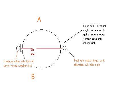

Thinking again...sorry /forums/images/graemlins/smile.gif Someone on here is using a piece of pipe that is slit for the back blade for snow removal, well that with your LOTO idea got me thinking. Why not split some pipe a little larger than your cyliders shaft and weld tubing to form a hinge then use the same idea with 5/8 on the other end for a trailer coupling lock. Does that make sense to anyone but me ? If you looked at it from the side it would look like PAC-MAN. You would just have to figure extended length of cyl- easy and spend some time cutting and welding.
   / Disabling tractor #22
Here is my excelent cad drawing to match my explination above /forums/images/graemlins/smile.gif Ok we saw the explination and we know that this is just MS paint /forums/images/graemlins/grin.gif
