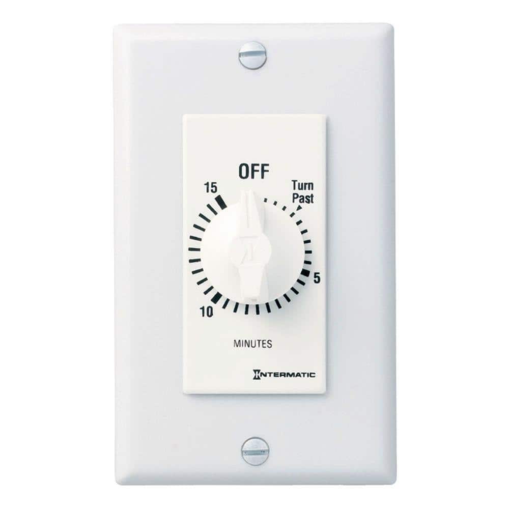

I used to bypass the seat switch on my tractors but now that I'm getting older and more forgetful, I decided it wasn't such a good idea. I thought about installing a toggle switch as a bypass but that was only a slight improvement. Instead, I now use this simple twist timer switch as a bypass:
When I need to stand to see the fork tips or line up a FEL SSQA implement, I just give it a twist. 15 minutes later, it automatically reactivates the seat safety switch.
The only issue I have with using a timer bypass switch is it isn't useful when running a PTO generator. For that, I keep a 40# sandbag handy.
