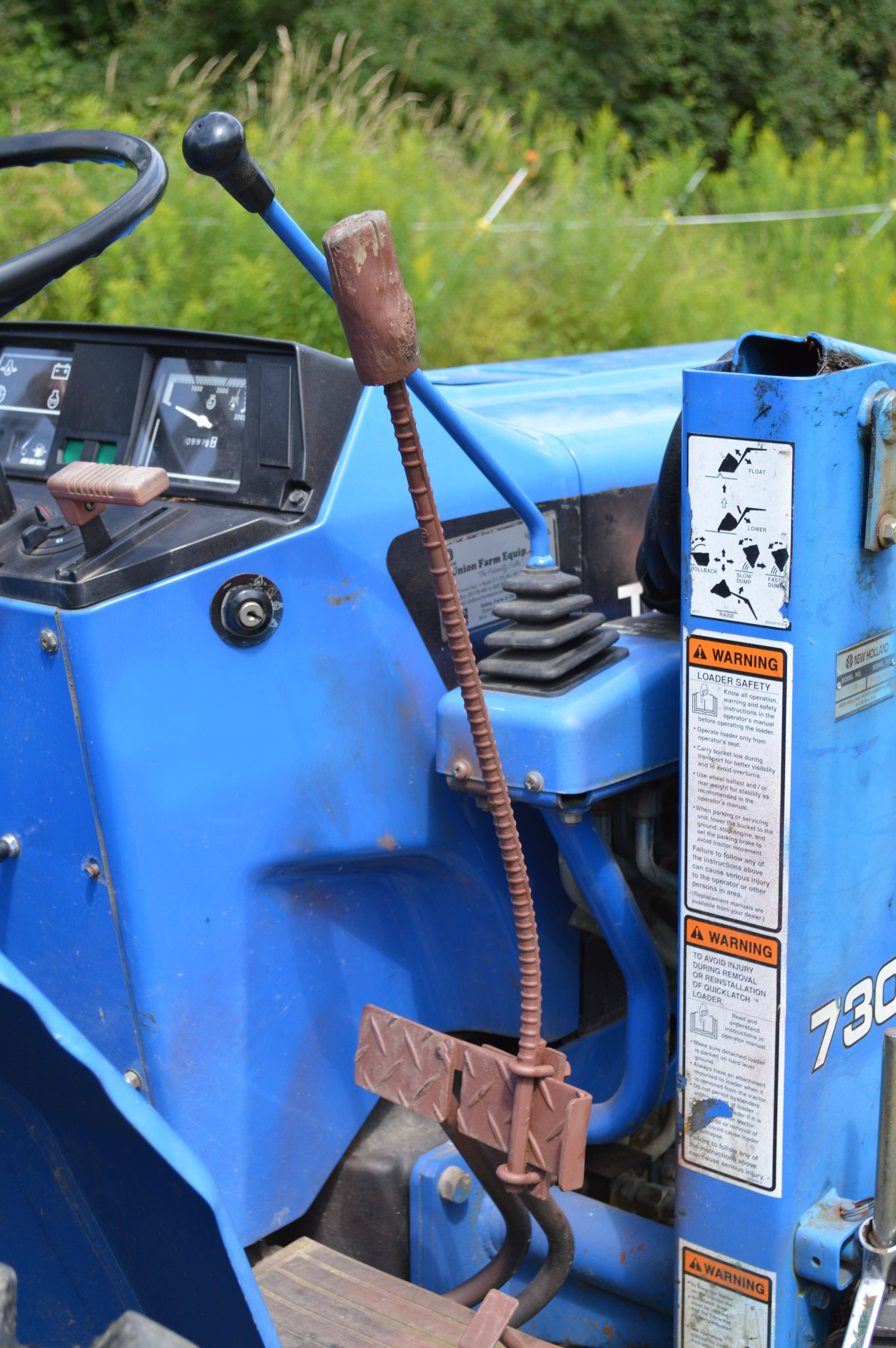

I admire your determination. I am a right leg above the knee amputee and I have installed a hand brake lever to the brake pedal of all 3 of my tractors.
