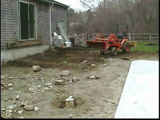

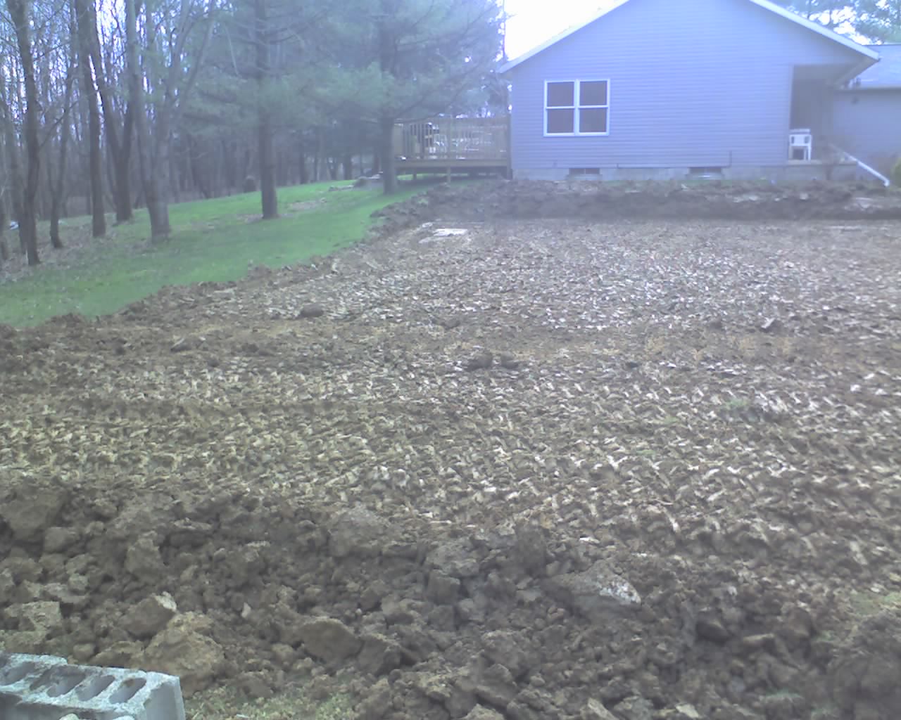

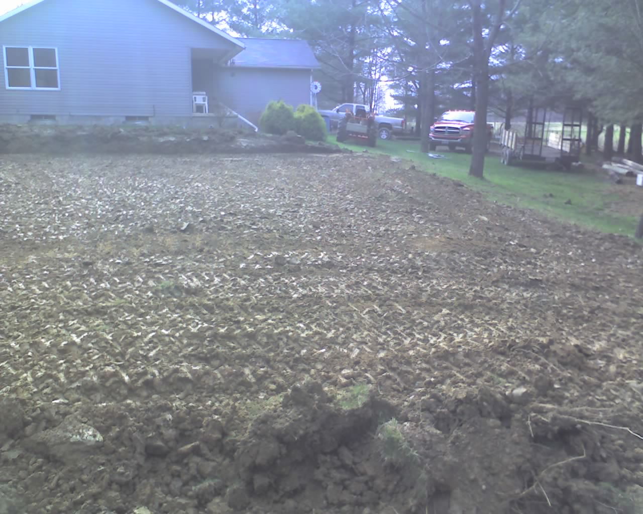

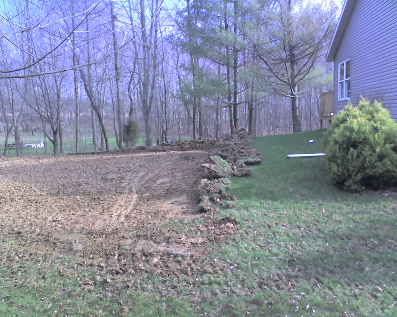

I would recommend a tooth bar for the bucket but you will have no trouble at all. I have a 30 HP B7800 and you wouldn't believe what I have done with it. I also recommend a box blade to level the ground. It is about the most usfull piece of ground engagement implement you will ever buy for under a grand.
This is a project I did when I installed my inground pool, I had to level off the ground down almost 24 inches so the runoff from the house wouldn't run into the pool
Before
After
Untitled_0001.mp4
http://i113.photobucket.com/albums/n235/Timber_8/Untitled_0001.mp4

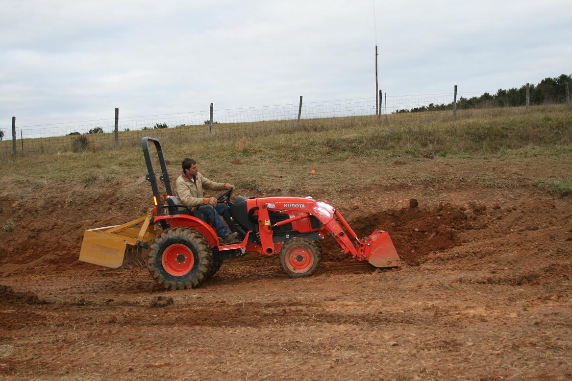

I've done an amazing amount of excavating with my little B3200 Kubota. I will say it isn't nearly as easy as with something larger like a skid steer or track loader, but with some fineness you can do a lot with a little tractor. Attached is a pic of an excavation I'm working on for a 40x60 shop:
