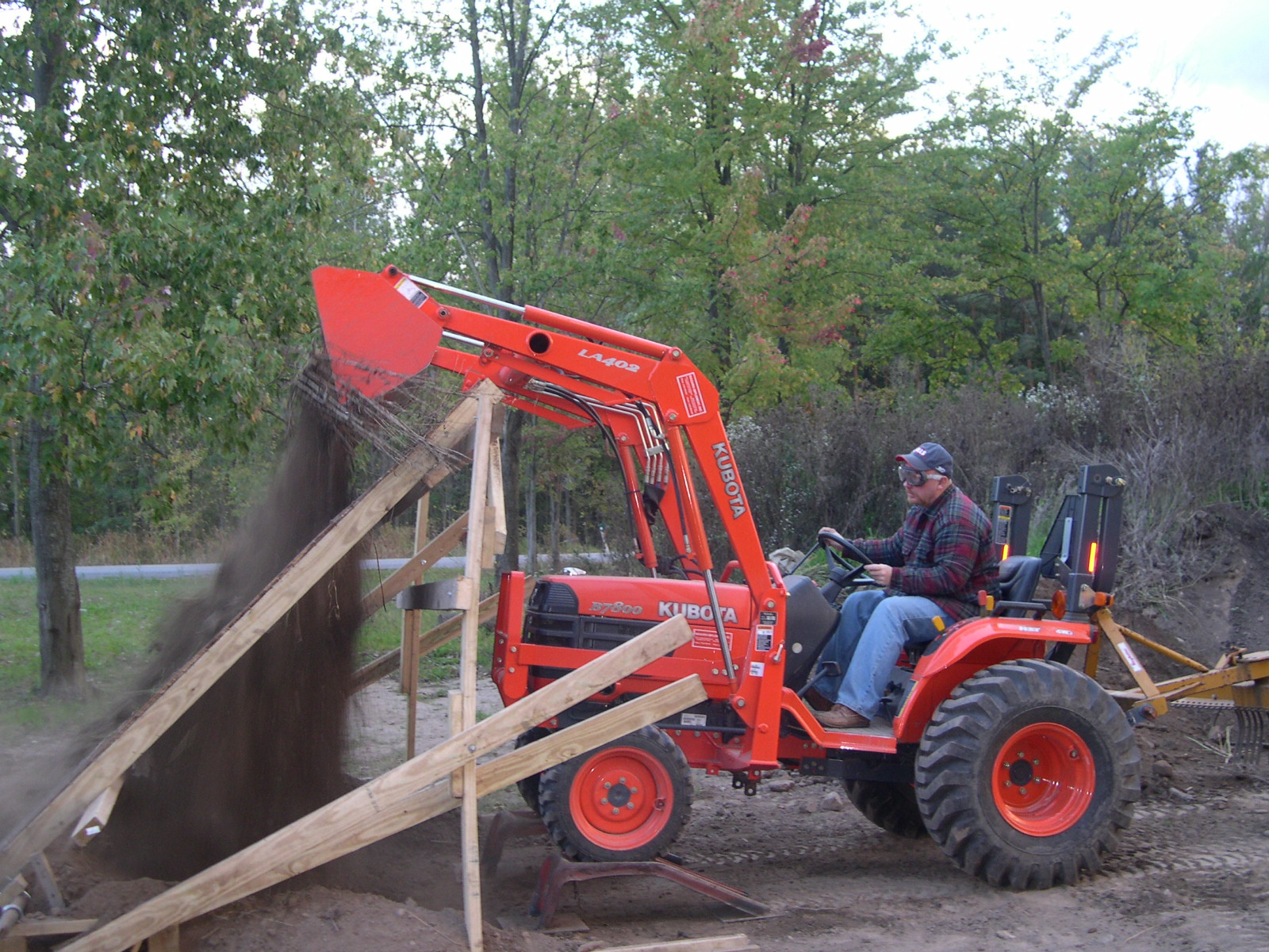

/ Dirt sifter? #3
After the excavator was done with our front yard, I had tons of loose dirt/soil and rocks left over. I wanted to sift out anything larger than 3-4" and all the roots and tree branches all over the yard. I built this little 4ft x 4ft sifter out of 2x4's and a chainlink fence door. Total cost was about $40 and it took a whole 30 mins to piece together.
Click thumbnails for large images.
It worked really well, you can see that I added a couple of ratchet straps to one side of it so I could tighten up the fencing as it streched after dropping a few large rocks on it. I made it just wide enough so my FEL bucket could fit under it and scoop up the good stuff and the large stuff rolled down to the front where I could pile it up.

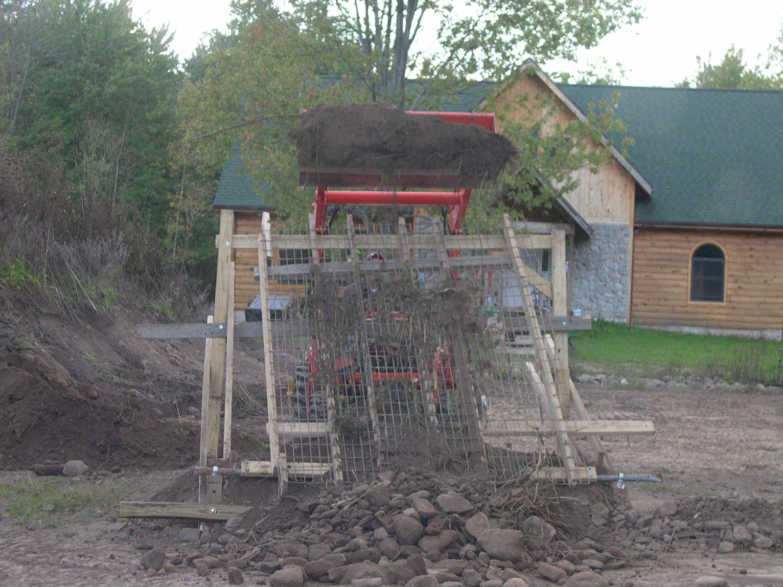

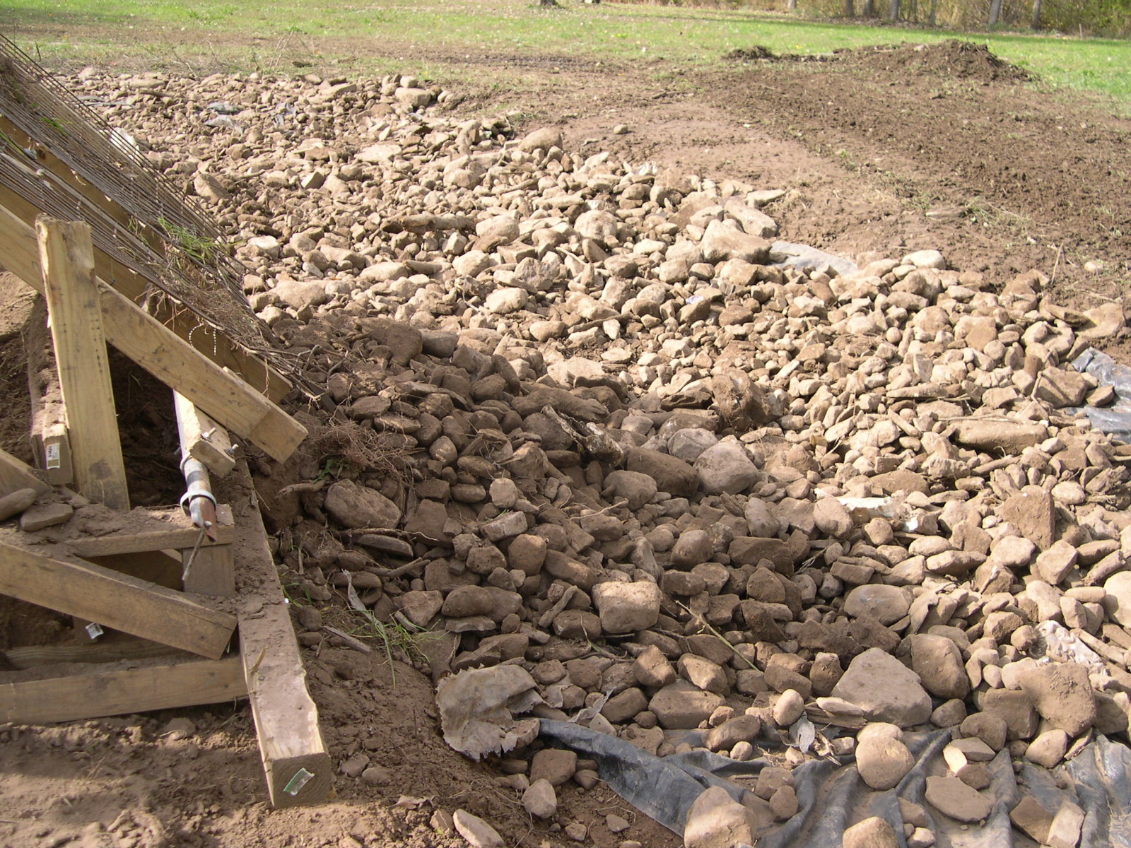

/ Dirt sifter? #5
Here are some pictures from the one I built for myself. It's not pretty but it worked well. This spring/summer I will take the current screen/frame and mount it onto my dump trailer with a 4x8 sheet of expanded metal on top of the current screen. This way as I'm re-screening the left over soil all the clean top soil will be in the trailer and I can haul it around the property. I tested it out in fall and the process worked well.

/ Dirt sifter? #8
You can try that with your bucket but after a while I would imagine that something on the screen frame would eventually loosen up or break from the pressure. The dirt I had is from a pile that I was about 80 tons worth (so I was told) and packed down TIGHT. The key is to keep the dirt moving as fast as you can. I had some that were more flat and had shaker motors on them but modifications had to always be made and I was running out of season.

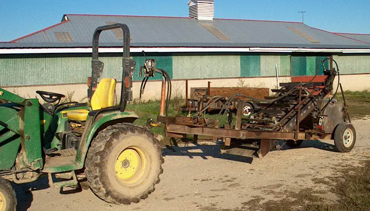

/ Dirt sifter? #10
here's a simple one i built to sift stones
