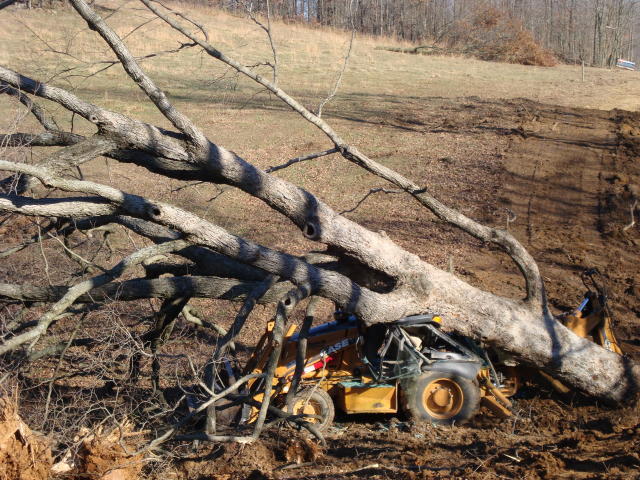

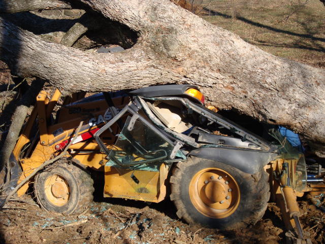

You really want to make sure that tree isn't coming back at you... I wouldn't want to test the FOPS that way, though it'd be better than relying on a helmet in that circumstance.
*It's also more subject to these kind of incidents.
/ Digging up tree with backhoe #22
Well that would anwer any questions on how to do it wrong. So please use caution and yes the branch that falls from the shaking can also get you also.
