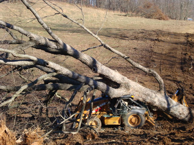

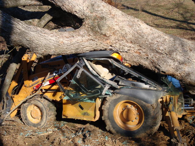

Green Duck .................please don't be this guy ! :eek:
