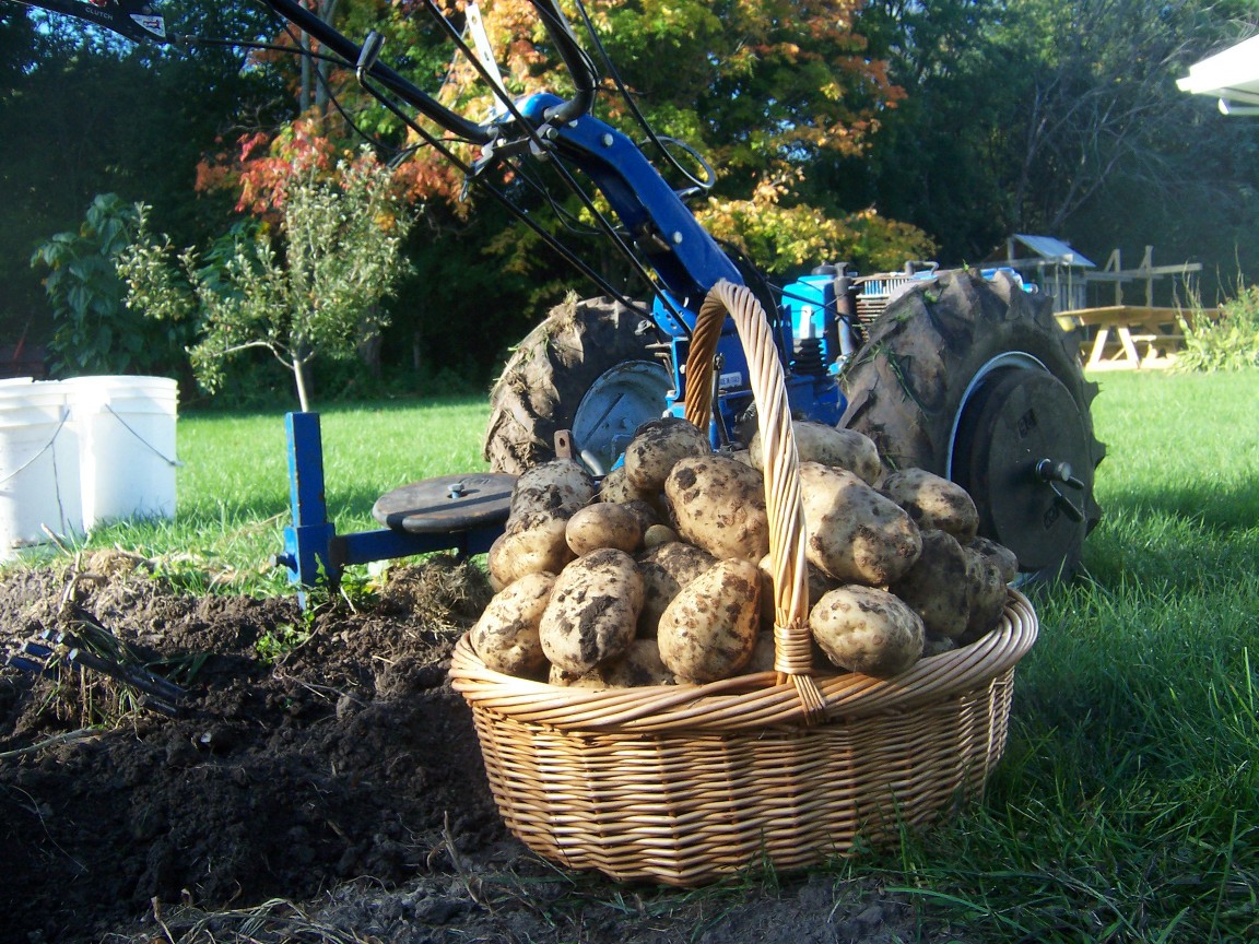

Hey all,
I just posted a video of me digging potatoes with my trusty rusty BCS 730 on Youtube.com. You can read my long-winded description of the machine and how it did on the video description.

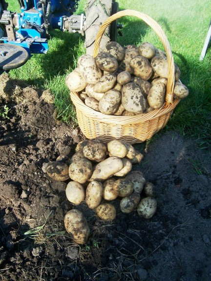

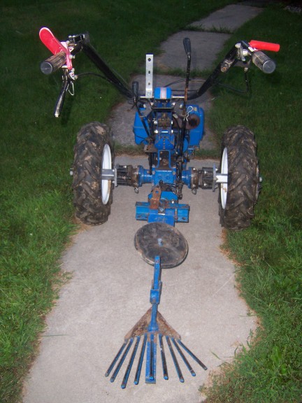

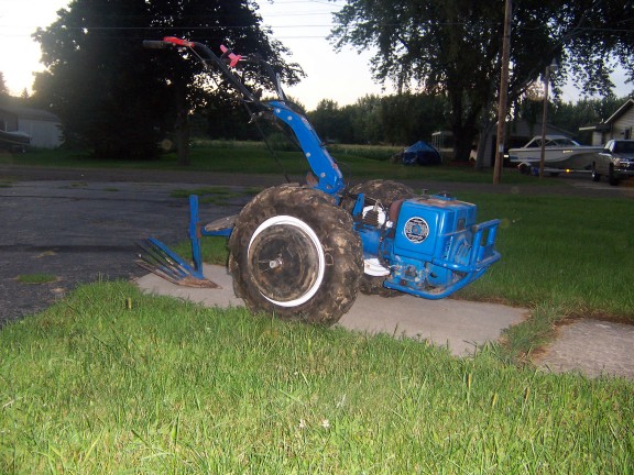

The first pic shows the potatoes that weren't reburied, the second shows all of them from one row. The third pic shows the machine from the drivers seat. The fourth shows a view from the side. Big tires for a 730, eh?
YouTube - BCS 730 with 8 HP Kohler Magnum pulling a Mainline potato plow

Hi! Farmerboybill I am curious. What the tires and wheels size. Congratulation ! Your potatoes look very good. Here we had too much rain this year. Good luck! Oldmech
/ Digging potatoes with a BCS 730 and root digger
Thanks to all the well-wishers! I'm hoping to make more videos of my BCS stuff since there seems to be few relating to them.
Hey Oldmech,
They are 6-12 tires mounted on 4 bolt trailer rims. I had a local welding shop make the adapter/extensions. The trailer rim's bolt pattern is just a skosh too big to mount directly to BCS machines. Since I was having them made up, I also had the 1 inch round stock welded on to hang weight. I can put about 100 lbs per side. Sure enough, i found a pair of 5-12 tires almost immediately after I had 'em made up. How's the 735 Diesel been treating you?

That first photo with the potatoes in the foreground and the tractor in the background is just beautiful. I wonder what that says about me :) ? Did you have to do a lot of hand digging afterwards?

Hey Rick,
Most of the spuds come out and stay out, but the digger does rebury some. The second pic shows how many were in a 20 foot row. The ones in the basket were left on top and the ones in front had to be fished out with a 5 tine manure fork.
