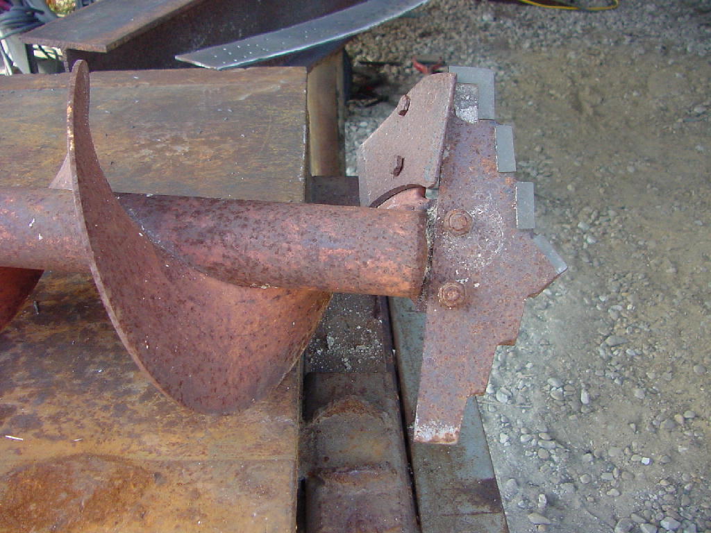

Now this is the big dog you've been lusting for Don and you've never even met her.
This is that one I mentioned my bud had for the 1 5/8 hex shaft for a twelve inch hole.
Check out that pattern. This puppy will take you to the dance and make everyone else so jealous they'll be chewing up nails and spitting out screws.
I believe this one will cost in the neighbor hood of eight hundred to a thousand just for the business end. That's a guess from an experienced guesstimator for what ever that's worth.

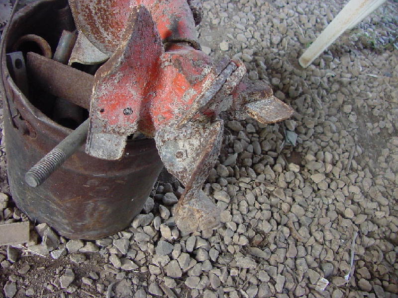

But now I've got good news for you. I dug into my little bucket of goodies. These are all adaptable to whatever for whomever whenever.
Yup, if you look close you will see I not only have the teeth but I have the weld on holders for the teeth. Check out those wide puppies with the blue holders. You will see those on auger trucks when they're kicking butt in clay and soft limestone.
Those little ones with the small rectangular holders are smaller versions of the teeth in head in the above post, we might call them big dog's toofies.
The reason I bought them is to supplement an existing head if I needed to. Say like when a corner is worn down instead of building it back or just tossing the head assembly I can weld on a couple teeth to catch that area. They're also neat where if you wanted to put some bite on a bucket or blade if you're into that kind of thing.
All the flat ones are Pengo or pengo clones. I picked up some holders for them too just in case I found a bit that needed a little extra something or two.
What works like a preacher on Sunday morning when the mortage is past due is that little Pengo with the three sharp points. Thats for limestone and killer clay.
If you look at the flat ones close you will notice one has the three pieces of carbide across the end and the other is neked.
Neked ain't good.
What I have found terrible is most retailers of augers and bits have never seen any of the stuff that's in these posts. What they carry is some rinky dink piece of crap with a touch of hardfacing and they charge you as much if not more than what the good stuff costs.
If you can find a Pengo tip for an auger all they carry is the standard fishtails and teeth which wear out way too soon.
The next post will be about that.
